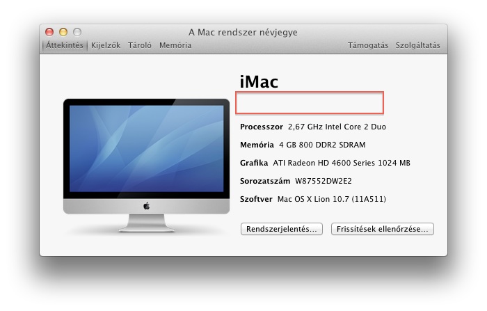

And an other problem: It's not read out correctly my smbios file cause:
(with RC5 r1096 there is the model year, with newer chameleon it's empty)

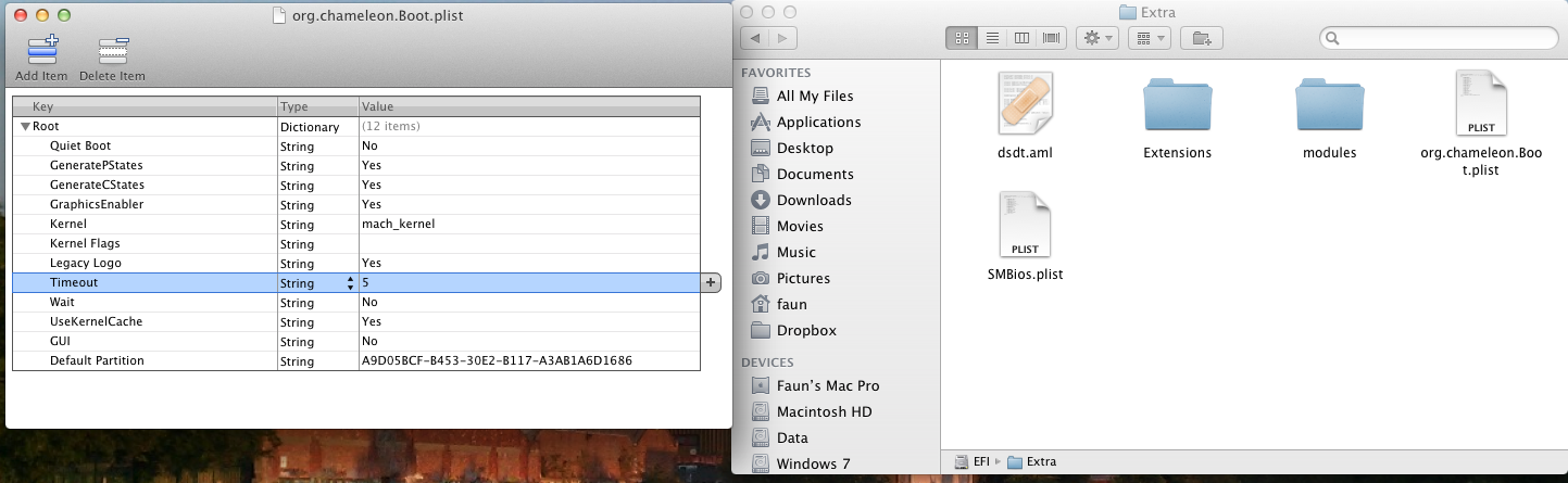

Hopefully this is the right place to ask... ;P
Just started using boot0hfs after running into the usuel issues of Windows not being on the "Active" partition... Of course, now I have a new problem :)
Chameleon doesn't seem to be reading my org.chameleon.Boot.plist file anymore.
Pretty sure that's what's going on since GraphicsEnabler doesn't work no more and tis the same with timeout (just sits waiting for me to select a partition) :D
Not sure what I can post to help you help me help us all (e-cookies if you get the reference :D), but here's my current setup:

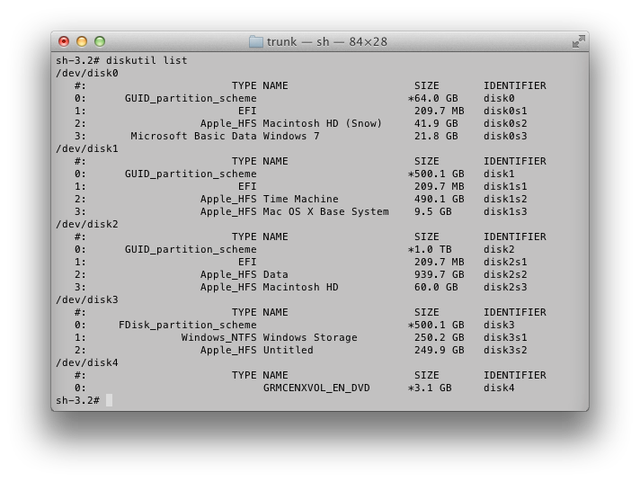

Disk layout:
disk0s1: EFI partition containing Chameleon RC5 r1183, my DSDT, etc
disk0s2: Snow Leopard install
disk0s3: Windows 7
disk2s3: Lion GM (currently set as default with UUID)
org.chameleon.Boot.plist is in disk0s1/Extra/ (correct, yus?). Screenshot in case it helps somehow :S
Am I missing something blindingly obvious here or what? =/

 Type ? and press Enter to learn about advanced startup options
boot:     hd(0,2) Macintosh HD (Snow)
   hd(0,3) Windows 7
Press Enter to start up the foreign OS.     hd(0,3) Windows 7
   hd(1,3) Mac OS X Base System
Press Enter to start up Darwin/x86 with no options, or you can:
 Type -v and press Enter to start up with diagnostic messages
boot:     hd(1,3) Mac OS X Base System
   hd(2,3) Macintosh HD
Read HFS+ file: [hd(2,3)/Library/Preferences/SystemConfiguration/com.apple.Boot.plist] 232 bytes.
Setting boot-uuid to: A9D05BCF-B453-30E2-B117-A3AB1A6D1686
Read HFS+ file: [hd(2,3)/System/Library/CoreServices/SystemVersion.plist] 476 bytes.
Hibernate image is too old by 2960832 seconds. Use ForceWake=y to override
Loading Darwin 10.7
Loading kernel cache /System/Library/Caches/com.apple.kext.caches/Startup/kernelcache
Read HFS+ file: [hd(2,3)/System/Library/Caches/com.apple.kext.caches/Startup/kernelcache] 4096 bytes.
Read HFS+ file: [hd(2,3)/System/Library/Caches/com.apple.kext.caches/Startup/kernelcache] 14301316 bytes.
Read HFS+ file: [hd(0,1)/Extra/DSDT.aml] 17438 bytes.
Using PCI-Root-UID value: 1
Read HFS+ file: [hd(0,1)/Extra/smbios.plist] 738 bytes.
Intel NHM IMC DRAM Controller [8086:3405] at 00:00.0
Frequency detected: 799 MHz (1598) Triple Channel
CAS:8 tRC:8 tRP:8 RAS:24 (8-8-8-24)
SMBus CmdReg: 0x3
Scanning SMBus [8086:3a30], mmio: 0xfbffb004, ioport: 0x500, hostc: 0x1
SPD[0] (size): 147 @0x50
Slot: 0 Type 24 2048MB (DDR3 SDRAM) 1600MHz Vendor=Crucial Technology
     PartNo=BL25664TG1608.16FF SerialNo=A2018DF9
SPD[0] (size): 255 @0x51
SPD[0] (size): 147 @0x52
Slot: 2 Type 24 2048MB (DDR3 SDRAM) 1600MHz Vendor=Crucial Technology
     PartNo=BL25664TG1608.16FF SerialNo=A2018DE3
SPD[0] (size): 255 @0x53
SPD[0] (size): 147 @0x54
Slot: 4 Type 24 2048MB (DDR3 SDRAM) 1600MHz Vendor=Crucial Technology
     PartNo=BL25664TB1608.16FF SerialNo=A30179D6
SPD[0] (size): 255 @0x55
SPD[0] (size): 255 @0x56
SPD[0] (size): 255 @0x57
CPU is Intel® Core(tm) i7 CPU         920  @ 2.67GHz, family 0x6, model 0x1a
Type: 0, Length: 24, Handle: 0x0
BIOSInformation:
vendor: Apple Inc.
version: MP51.007F.B03
releaseDate: 10/28/2010
Type: 1, Length: 27, Handle: 0x1
SystemInformation:
manufacturer: Apple Inc.
productName: MacPro5,1
version: 1.0
serialNumber: CK9210834PD
uuid: 00000000-0000-0000-0000-6CF04950709B
wakeupReason: 0x6
skuNumber: ?
family: MacPro

As you can see it reads my smbios.plist from the same location...
Can't find any reason why it isn't reading my org.chameleon.Boot.plist ><
