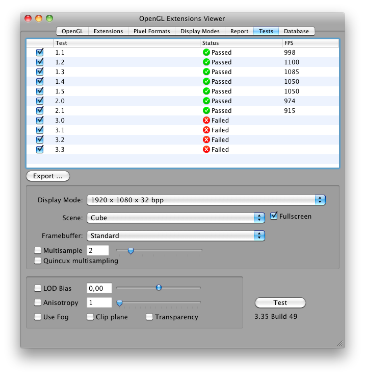

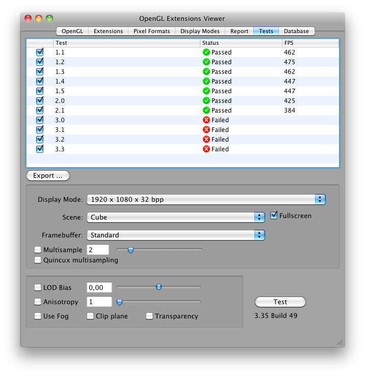

oldnapalm Posted April 6, 2011 Author Share Posted April 6, 2011 We need higher values in BoostPState 1 and 2 of Threshold_High. OpenGL test results were too low using legacy from post #2. Some tests: Stock 10.6.7 AGPM No AGPM Legacy from post #2 Legacy from this post LegacyAGPM.kext.zip get the one in post #12 Link to comment https://www.insanelymac.com/forum/topic/254053-agpm-on-fermi-laptop/#findComment-1666795 Share on other sites More sharing options...

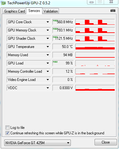

oldnapalm Posted April 7, 2011 Author Share Posted April 7, 2011 Using GPU-Z in Windows you can check the clocks. The lowest reading in my card was 50.6 MHz (9%) and the highest was 560.8 MHz (100%). The problem is that AGPM has 4 BoostPStates in Threshold_High and other 4 in Threshold_Low, and in some models there are also Threshold_High_v and Threshold_Low_v which I have no idea what they are for. There's also this RivaTuner app that may help, but I didn't try it yet. http://www.youtube.com/watch?v=ERAgoln1dLQ el coniglio wrote a parser for AGPM Info.plist which may help. Desktop cards look an easier task as they have only 2 threshold profiles with 2 values each while laptop ones have more values and more profiles All graphs AGPM.zip Link to comment https://www.insanelymac.com/forum/topic/254053-agpm-on-fermi-laptop/#findComment-1667362 Share on other sites More sharing options...

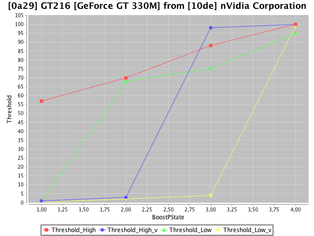

oldnapalm Posted November 7, 2011 Author Share Posted November 7, 2011 I think Threshold_Low_v and Threshold_High_v take effect when using battery? I don't think so, I believe camoguy is right. It's my belief that the V stands for volts in this "Threshold_Low_v" and that "Threshold_Low" would be related to Mhz. It would only make sense, that if you change the core clock value, to change the volts to be as power efficient as possible. Link to comment https://www.insanelymac.com/forum/topic/254053-agpm-on-fermi-laptop/#findComment-1768281 Share on other sites More sharing options...
whitegerry Posted November 7, 2011 Share Posted November 7, 2011 I don't think so, I believe camoguy is right. Here are some values under Vendor10deDevice0a29 and Vendor10deDevice0a34: <key>Threshold_High</key> <array> <integer>57</integer> <integer>70</integer> <integer>80</integer> <integer>100</integer> </array> <key>Threshold_High_v</key> <array> <integer>1</integer> <integer>3</integer> <integer>98</integer> <integer>100</integer> </array> <key>Threshold_Low</key> <array> <integer>0</integer> <integer>68</integer> <integer>75</integer> <integer>94</integer> </array> <key>Threshold_Low_v</key> <array> <integer>0</integer> <integer>2</integer> <integer>4</integer> <integer>99</integer> [list=1][*] </array>[/list] I think even 0% idle the AGPM will not stay at BoostPState 0 or 1 when using battery but I don't know whether my thought is right or not. Link to comment https://www.insanelymac.com/forum/topic/254053-agpm-on-fermi-laptop/#findComment-1768346 Share on other sites More sharing options...
