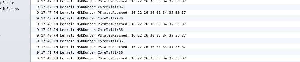

prcmelo Posted August 12, 2011 Share Posted August 12, 2011 Hi Folks, Thnx for all the great info. got most of it running just fine. The only thing i can't get to work is sleep. It Sleeps but it won't wake up correctly. I have in the bios the PLL Overvoltage Disabled and Power on by PCIe enabled. Got everything loaded correctly i guess (see picture System info) and no error's in the Console log. The NBNV number in my extracted dsdt from bios 713 is 0xBF5CFD98 Also used speedstepper to patche AICPM.kext and used kernel 10.7.4, iMac,12.2.plist to get Speedstep and Turbo working. Using dropssdt in com.apple.boot.plist What am i missing? Thnx for the help. RW I have the same i5 2500 as you and I still can not enable the "37" ... only 36 with the MacBookPro8,3.plist from Lion... with the iMac12,2.plist I get the 37, but only four turbo stages and 16 ... I tried with several SSDTs and plists and still could not enable it... can you, please, send me your SSDT so I can look and see what I need to change on mine? I also looked at your DSDT and I will see if I need to change something on mine in the processor area.. I appreciate if you could send me your SSDT! Greetings from Brazil! Link to comment https://www.insanelymac.com/forum/topic/253642-dsdt-for-asus-p8p67-m-pro/page/33/#findComment-1733927 Share on other sites More sharing options...

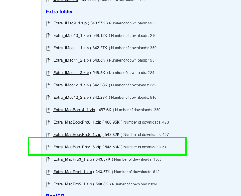

flAked Posted August 14, 2011 Share Posted August 14, 2011 That's normal, the stepper program from the MBP8,3 rarely switches to the highest state. The iMac12,2 stepper program in Lion is currently "bugged" and shows the mentioned behavior. Keep the MBP8,3 definition and don't worry about 37x. Link to comment https://www.insanelymac.com/forum/topic/253642-dsdt-for-asus-p8p67-m-pro/page/33/#findComment-1734565 Share on other sites More sharing options...
pauldmps Posted August 16, 2011 Share Posted August 16, 2011 Keep the MBP8,3 definition. Sorry for the noobish question, but where can I get MBP8,3 system definition? I tried searching everywhere but couldn't find anywhere. I am currently using MBP8,1 definition. Will this method work with that? Link to comment https://www.insanelymac.com/forum/topic/253642-dsdt-for-asus-p8p67-m-pro/page/33/#findComment-1735427 Share on other sites More sharing options...
pauldmps Posted August 17, 2011 Share Posted August 17, 2011 I am currently using MBP8,1 definition. Will this method work with that? Checked. Does not work. Link to comment https://www.insanelymac.com/forum/topic/253642-dsdt-for-asus-p8p67-m-pro/page/33/#findComment-1736077 Share on other sites More sharing options...
RemoteWorks Posted August 17, 2011 Share Posted August 17, 2011 Sorry for the noobish question, but where can I get MBP8,3 system definition? I tried searching everywhere but couldn't find anywhere. I am currently using MBP8,1 definition. Will this method work with that? Here http://www.insanelymac.com/forum/index.php?showtopic=235523 RW I have the same i5 2500 as you and I still can not enable the "37" ... only 36 with the MacBookPro8,3.plist from Lion... with the iMac12,2.plist I get the 37, but only four turbo stages and 16 ... I tried with several SSDTs and plists and still could not enable it... can you, please, send me your SSDT so I can look and see what I need to change on mine? I also looked at your DSDT and I will see if I need to change something on mine in the processor area.. I appreciate if you could send me your SSDT! Greetings from Brazil! Hi, Sorry for the late response. No need for the ssdt table, it is already in the dsdt. I can not test the MacBookPro8,3.plist and Lion because i sold the board and replaced it for a gigabyte z68 However while using the MacBookPro8,3.plist and Lion on my new z68 board. i got the same problem as you with turbo not getting to 37. RW Link to comment https://www.insanelymac.com/forum/topic/253642-dsdt-for-asus-p8p67-m-pro/page/33/#findComment-1736152 Share on other sites More sharing options...
prcmelo Posted August 17, 2011 Share Posted August 17, 2011 Hi, Sorry for the late response.No need for the ssdt table, it is already in the dsdt. I can not test the MacBookPro8,3.plist and Lion because i sold the board and replaced it for a gigabyte z68 However while using the MacBookPro8,3.plist and Lion on my new z68 board. i got the same problem as you with turbo not getting to 37. RW Thank you! But, do you know what is funny? I put the step values of MP8,3.plist inside the IM12,2.plist... and after 30/40 minutes of use I reached 37 ... now I have 9 States Let's see how this will work with 10.7.1 Update Link to comment https://www.insanelymac.com/forum/topic/253642-dsdt-for-asus-p8p67-m-pro/page/33/#findComment-1736234 Share on other sites More sharing options...
RemoteWorks Posted August 17, 2011 Share Posted August 17, 2011 Thank you! But, do you know what is funny? I put the step values of MP8,3.plist inside the IM12,2.plist... and after 30/40 minutes of use I reached 37 ... now I have 9 States Let's see how this will work with 10.7.1 Update Hmm did not test that, but using the MP8,3.plist for a longer period it reached the 37 step. RW Link to comment https://www.insanelymac.com/forum/topic/253642-dsdt-for-asus-p8p67-m-pro/page/33/#findComment-1736249 Share on other sites More sharing options...
