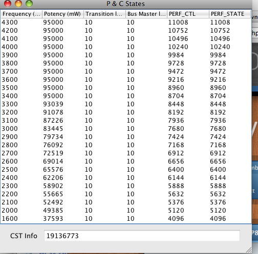

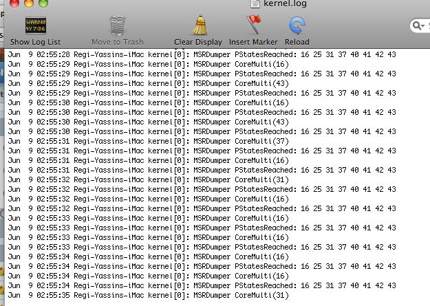

Regi Yassin Posted June 8, 2011 Share Posted June 8, 2011 if i set my multiplier to auto, i got 5 PS, with screenshot attached before, with multipliers 43 42 41 40 i got this, special thanks to buoo Link to comment https://www.insanelymac.com/forum/topic/253642-dsdt-for-asus-p8p67-m-pro/page/32/#findComment-1694743 Share on other sites More sharing options...
mrmojorisin17 Posted June 8, 2011 Share Posted June 8, 2011 regae does SMC Monitor working for you? 37 40 41 42 43 5 Turbo States? Link to comment https://www.insanelymac.com/forum/topic/253642-dsdt-for-asus-p8p67-m-pro/page/32/#findComment-1694761 Share on other sites More sharing options...
Regi Yassin Posted June 9, 2011 Share Posted June 9, 2011 regae does SMC Monitor working for you? 37 40 41 42 43 5 Turbo States? smc only work for monitor temps, why? Link to comment https://www.insanelymac.com/forum/topic/253642-dsdt-for-asus-p8p67-m-pro/page/32/#findComment-1694945 Share on other sites More sharing options...

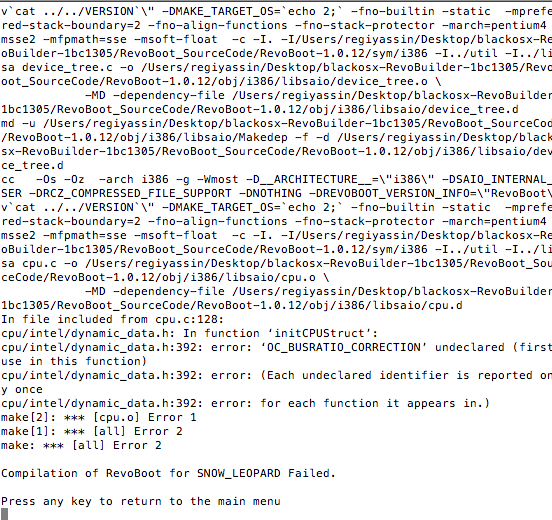

Regi Yassin Posted June 9, 2011 Share Posted June 9, 2011 i got an error where compiling the latest version of revoboot EDIT: Success with attachment by buoo, Link to comment https://www.insanelymac.com/forum/topic/253642-dsdt-for-asus-p8p67-m-pro/page/32/#findComment-1695211 Share on other sites More sharing options...
flAked Posted June 9, 2011 Share Posted June 9, 2011 I'm not a big fan of repackaged versions, the sourcecode is available at RevoBoot. RevoBoot needs to be custom tailored, so any pre-configured version is prone for errors. You need to learn to configure it yourself, it is not a automatic solution like Chameleon. For more information see the massive thread by MasterChief, it was discussed in length already. I know that we went off-topic as well some times, but please keep the topic on DSDT. This is not really the place to discuss how to configure RevoBoot or compiling errors. Link to comment https://www.insanelymac.com/forum/topic/253642-dsdt-for-asus-p8p67-m-pro/page/32/#findComment-1695221 Share on other sites More sharing options...

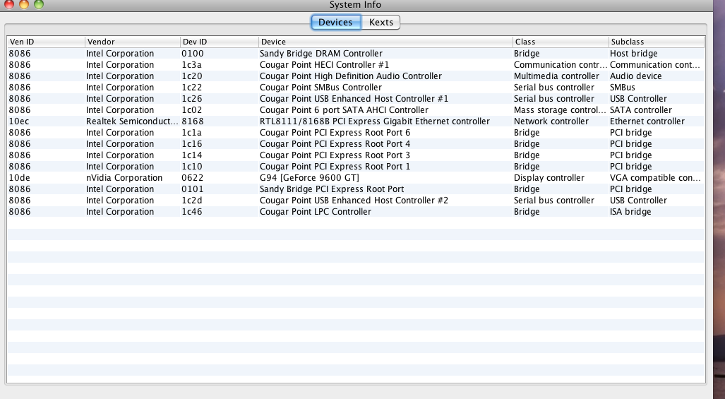

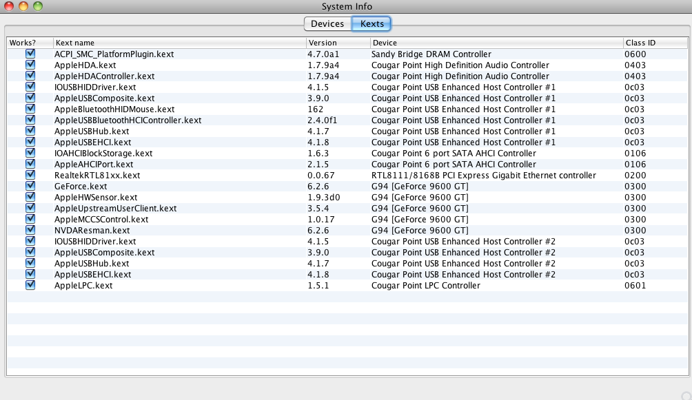

RemoteWorks Posted June 18, 2011 Share Posted June 18, 2011 Hi Folks, Thnx for all the great info. got most of it running just fine. The only thing i can't get to work is sleep. It Sleeps but it won't wake up correctly. I have in the bios the PLL Overvoltage Disabled and Power on by PCIe enabled. Got everything loaded correctly i guess (see picture System info) and no error's in the Console log. The NBNV number in my extracted dsdt from bios 713 is 0xBF5CFD98 Also used speedstepper to patche AICPM.kext and used kernel 10.7.4, iMac,12.2.plist to get Speedstep and Turbo working. Using dropssdt in com.apple.boot.plist What am i missing? Thnx for the help. RW Btw the posted Dsdt is with the Ssdt tables for the 2500/k Cpu. Remove if tested with other Cpu's. dsdt.dsl.zip Link to comment https://www.insanelymac.com/forum/topic/253642-dsdt-for-asus-p8p67-m-pro/page/32/#findComment-1699901 Share on other sites More sharing options...
