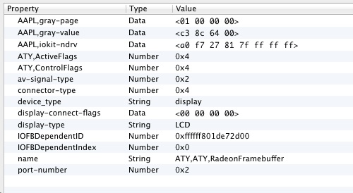

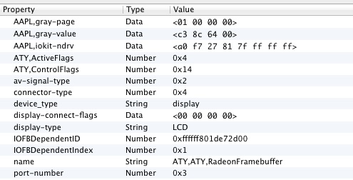

lseba Posted October 21, 2011 Share Posted October 21, 2011 does any one knows in wich kext is located the conector info of the RadeonFramebuffer personality. i belive thta is the default framebuffer used when there is no match for the framebuffer injected by chameleon Link to comment https://www.insanelymac.com/forum/topic/249642-editing-custom-personalities-for-ati-radeon-hd45xx/page/24/#findComment-1763139 Share on other sites More sharing options...
Mietas Posted October 22, 2011 Share Posted October 22, 2011 RadeonFramebuffer is an automatic detection of connections in graphic card. If I use this, it will detect LVDS, HDMI and VGA fine, but LVDS stay black without backlight, unfortunately. Link to comment https://www.insanelymac.com/forum/topic/249642-editing-custom-personalities-for-ati-radeon-hd45xx/page/24/#findComment-1763308 Share on other sites More sharing options...
lseba Posted October 22, 2011 Share Posted October 22, 2011 so thgere is no connectorinfo hex table for radeonframebuffer that could be edited? is there a way to see the automaticly generated conector info? Link to comment https://www.insanelymac.com/forum/topic/249642-editing-custom-personalities-for-ati-radeon-hd45xx/page/24/#findComment-1763413 Share on other sites More sharing options...

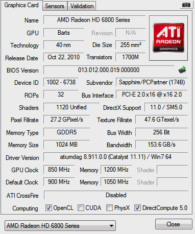

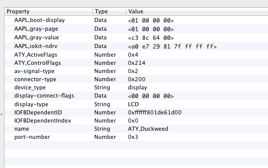

TijuanaKez Posted December 23, 2011 Share Posted December 23, 2011 Hope this isn't too off topic but trying to get 10.7 to recognise both DVI ports on a sapphire 6870 using this procedure but I've hit a wall. The default frame buffer for this card is Duckweed which works with only one DVI port. The duckweed port table lists 2 x DP, 1 x HDMI and 1 x DVI which is not going to work as the card has 1 x DP and 2 x DVI (1 single, 1 dual). Both DVI ports work with GraphicsEnabler=No but DVD Player and Ableton crash without correct frame buffer loaded and ableton crashing is not an option for me. Personality: Duckweed ConnectorInfo count in decimal: 4 Disk offset in decimal 523688 0000000 00 04 00 00 04 03 00 00 00 01 00 00 12 04 04 01 < Display Port (should be other DVI) 0000010 00 04 00 00 04 03 00 00 00 01 00 00 22 05 05 02 < Display Port (apparently this one works) 0000020 00 08 00 00 04 02 00 00 00 01 00 00 11 02 03 04 < HDMI 0000030 00 02 00 00 14 02 00 00 00 01 00 00 00 00 06 05 < single link DVI (working) 0000040 ATOM BIOS Rom: SubsystemVendorID: 0x174b SubsystemID: 0x174b IOBaseAddress: 0x0000 Filename: 174X03B0.S4I BIOS Bootup Message: BARTS XT HYNIX/ELPIDA GDDR5 32MX32 BIOS PCI ID: 1002:6738 Connector at index 0 Type [@offset 44283]: DisplayPort (10) Encoder [@offset 44287]: INTERNAL_UNIPHY2 (0x21) i2cid [@offset 44393]: 0x90, OSX senseid: 0x1 Connector at index 1 Type [@offset 44293]: HDMI-A (11) Encoder [@offset 44297]: INTERNAL_UNIPHY2 (0x21) i2cid [@offset 44420]: 0x93, OSX senseid: 0x4 Connector at index 2 Type [@offset 44303]: DVI-D (3) Encoder [@offset 44307]: INTERNAL_UNIPHY1 (0x20) i2cid [@offset 44447]: 0x95, OSX senseid: 0x6 Connector at index 3 Type [@offset 44313]: DVI-I (2) Encoder [@offset 44317]: INTERNAL_UNIPHY (0x1e) i2cid [@offset 44484]: 0x94, OSX senseid: 0x5 Connector at index 4 Type [@offset 44323]: DVI-I (2) Encoder [@offset 44327]: INTERNAL_KLDSCP_DAC1 (0x15) i2cid [@offset 44484]: 0x94, OSX senseid: 0x5 redsock_bios_decoder 174X03B0.S4I: BARTS XT HYNIX/ELPIDA GDDR5 32MX32 BIOS Subsystem Vendor ID: 174b Subsystem ID: 174b Object Header Structure Size: 355 Connector Object Table Offset: 48 Router Object Table Offset: 0 Encoder Object Table Offset: fd Display Path Table Offset: 12 Connector Object Id [19] which is [DISPLAY_PORT] encoder obj id [0x21] which is [iNTERNAL_UNIPHY2 (osx txmit 0x12 [duallink 0x2] enc 0x4)] linkb: false Connector Object Id [12] which is [HDMI_TYPE_A] encoder obj id [0x21] which is [iNTERNAL_UNIPHY2 (osx txmit 0x22 [duallink 0x2] enc 0x5)] linkb: true Connector Object Id [3] which is [DVI_D] encoder obj id [0x20] which is [iNTERNAL_UNIPHY1 (osx txmit 0x11 [duallink 0x1] enc 0x2)] linkb: false Connector Object Id [2] which is [DVI_I] encoder obj id [0x1e] which is [iNTERNAL_UNIPHY (osx txmit 0x10 [duallink 0x0] enc 0x0)] linkb: false Connector Object Id [2] which is [DVI_I] encoder obj id [0x15] which is [iNTERNAL_KLDSCP_DAC1 (osx txmit 0x00 enc 0x10?)] linkb: false IORegistryExplorer: WORKING DVI with GE=yes IORegistryExplorer: WORKING DVI with GE=no PORT 2 (if ports are always the same, this should be the dual link / problem one) IORegistryExplorer: WORKING DVI with GE=no PORT 3 Interestingly they are both recognised as 0x4 (dual link) with GE=no and work fine even though one is a single link. GPU-Z I've tried just changing the connector type in the first line to 0004 instead of 0400 I've tried copying the single link DVI code from port 3 to port 0. But I have been just hex editing ATI6000Controller and booting 64bit.... will this not work? I'm unclear on instructions for 64bit. Seeing as none of the ATI6000 series FrameBuffers enable the dual-link DVI I have nothing to copy and paste. I'm hoping I have enough information from radeon_bios_decode and IOReigstryExplorer to get it working anyway, just a bit unsure how to implement it. Any help would be greatly appreciated. There are quite a few people struggling with this card and getting a compatible personality would close a lot of threads. Link to comment https://www.insanelymac.com/forum/topic/249642-editing-custom-personalities-for-ati-radeon-hd45xx/page/24/#findComment-1780717 Share on other sites More sharing options...

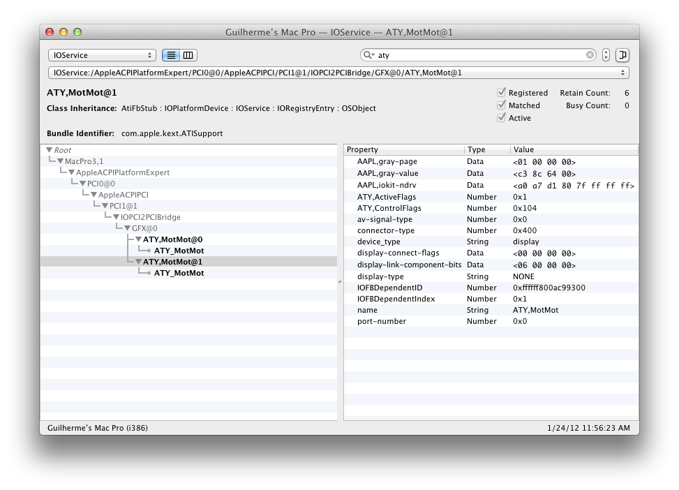

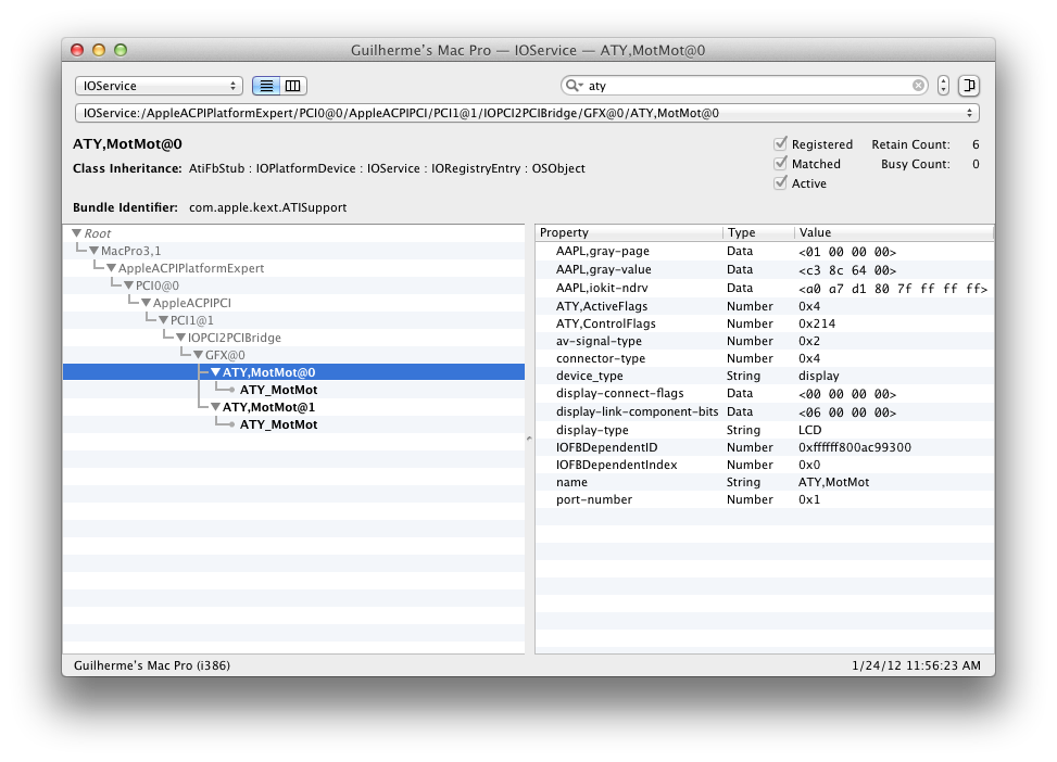

Guilherme Araújo Posted January 24, 2012 Share Posted January 24, 2012 Hey guys, I've been reading the forums these last couple of weeks, and I could install Lion on my PC, everything is almost fine, except audio via HDMI. I have an ATI 4850 with 2 DVI ports and I'm using a DVI-HDMI adapter (which includes sound, it works on Windows). According to IORegistry and Chameleon boot info, the personality of this card is MotMot. I ran that perl script and got this: Personality: MotMot ConnectorInfo count in decimal: 2 Disk offset in decimal 462408 0000000 00 04 00 00 04 01 00 00 00 01 00 00 10 00 02 03 // Display Port 0000010 04 00 00 00 14 02 00 00 00 01 00 00 01 11 01 04 // Dual Link DVI 0000020 As you can see, there is no HDMI port. Moreover, there's a DisplayPort on the first line. This is bugging me... I expected 2 DVI ports, got DP + DVI instead. I'm running Lion, so I looked for these strings on ATI4800Controller.kext. I did found them, twice. (Edit: I read again, one occurrence for 32-bit, the other for 64-bit, right?) Now it's time to do the trick and "convert" one of them into an HDMI port, but I have no idea how to do this. In the example, the OP copied the "unused" port 3 into port 2, but in my case how should I change the string? I forgot to mention, on ATI4800Controller's Info.plist there's an entry named Cardinal instead of MotMot. So now I don't know which of them I need do edit. Link to comment https://www.insanelymac.com/forum/topic/249642-editing-custom-personalities-for-ati-radeon-hd45xx/page/24/#findComment-1788915 Share on other sites More sharing options...
Guilherme Araújo Posted January 31, 2012 Share Posted January 31, 2012 Anyone? Link to comment https://www.insanelymac.com/forum/topic/249642-editing-custom-personalities-for-ati-radeon-hd45xx/page/24/#findComment-1791305 Share on other sites More sharing options...
