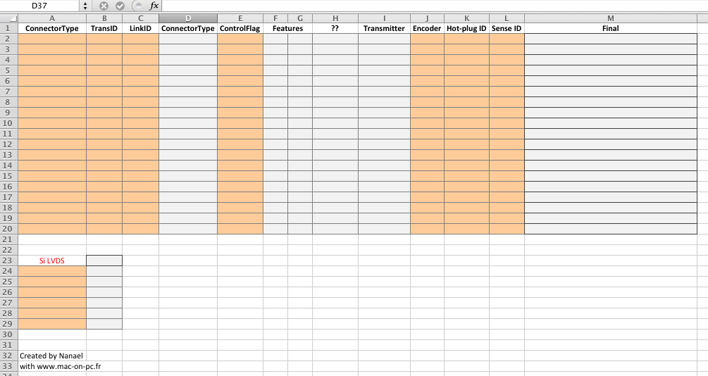

Nanael Posted September 13, 2012 Share Posted September 13, 2012 Hey guys! I've created this excel paper to help the creation of personalitys Tell me if it helped you Personality.zip Link to comment https://www.insanelymac.com/forum/topic/249642-editing-custom-personalities-for-ati-radeon-hd45xx/page/26/#findComment-1852557 Share on other sites More sharing options...
Slice Posted September 17, 2012 Share Posted September 17, 2012 Hey guys! I've created this excel paper to help the creation of personalitys Tell me if it helped you This is empty? How did you propose to use it? @bcc9 In your case, Chameleon+script you get patched kext (and cache next time) until System Update. Then you have to do the patch again, and create kernelcache again. In my case I wrote the patched connectors in config.plist and it works independent on updates. Nonetheless we have the common purpose to find a better way to patch connectors. My experience GA AMD Radeon HD6670 (10.8.1) Pithecia 04 00 00 00 1402 00 00 00 01 00 00 00 00 04 06 00 04 00 00 0403 00 00 00 01 00 00 21 03 02 03 10 00 00 00 1000 00 00 00 01 00 00 00 00 00 01 Ipomoea 04 00 00 00 04 03 00 00 00 01 00 00 10 00 01 06 10 00 00 00 10 00 00 00 00 01 00 00 00 00 00 01 00 08 00 00 04 02 00 00 00 01 00 00 12 04 04 03 See! They are different but both are working. Transmitters - no matter. Flags - no matter. Encoders - it is better to set zero. Exchange 2 and 3 - no matter. In both cases I can boot with VGA connected display. As well as I can boot with my main DVI monitor. VTX vendor AMD Radeon HD5570 Baboon (10.7.2) 04 00 00 00 14 00 00 00 00 01 00 00 01 00 01 04 00 08 00 00 00 02 00 00 00 71 00 00 22 00 02 05 10 00 00 00 10 00 00 00 00 01 00 00 00 00 00 02 so here I just decided to set senseid only and zero encoders. Other digits are native. It works! Main display is VGA connected monitor. PS. I also want to say that in both cases I can enter desktop without GraphicsInjector (native framebuffer) but DVDPlayer crashing. Without the Connectors Patch I can't enter desktop with any monitor. 6670 - black screen (system works) 5570 - empty desktop with galaxy. All info out of the desktop. And with this Connector Patch I have full success. Link to comment https://www.insanelymac.com/forum/topic/249642-editing-custom-personalities-for-ati-radeon-hd45xx/page/26/#findComment-1853447 Share on other sites More sharing options...
Nanael Posted September 17, 2012 Share Posted September 17, 2012 @slice just have a look on the orange cell i join the edit one for my hd6870 On each orange cell you have a list and it change automaticaly with what you put befor You can contact me via PM if you want Personality sapphyre 6870.zip Link to comment https://www.insanelymac.com/forum/topic/249642-editing-custom-personalities-for-ati-radeon-hd45xx/page/26/#findComment-1853501 Share on other sites More sharing options...

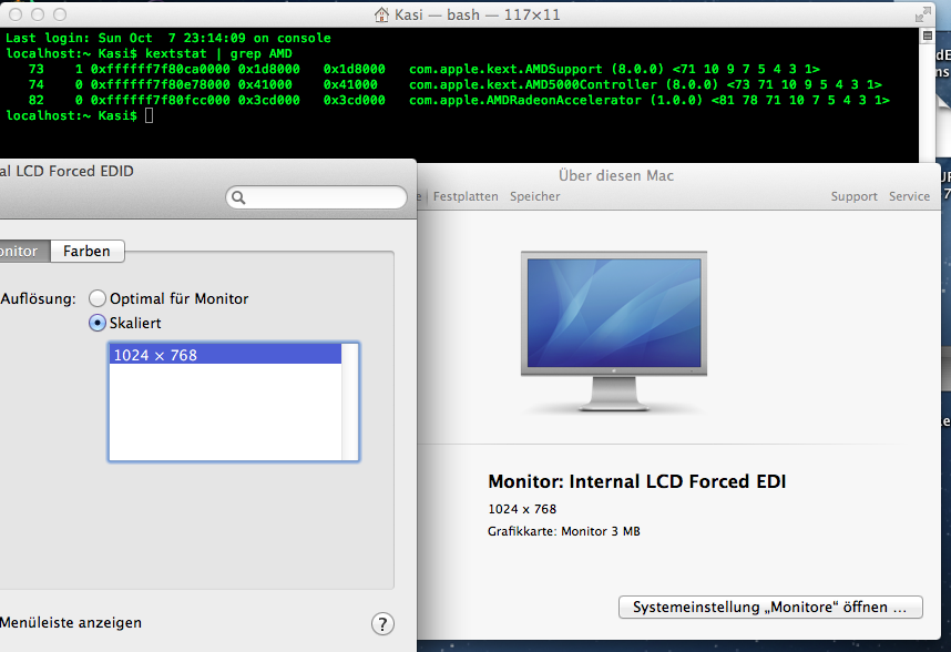

Kasi99 Posted October 14, 2012 Share Posted October 14, 2012 hello maybe somebody can help me to accomplish my targets. my english is verry bad, and the instructionguide is to diffecult to understand for me cause it`s all in english !! maybe sombody of you is speaking german !! it would be much easier for me !! my problem is: i don`t get any picture on my internal lcd of my notebook. i always get a blackscreen with graphicsenabler=yes at vga everthing ist allright ! the following steps i have allready done: -device id´s added in kext -LCD force edid in the DisplayProductID-717 enscribed every framebuffer in the org.chameleon.Boot.plist tried with and without GraphicsEnabler i still need help !! and i think i`m at the right place to get support !! sooo please help me !!!! Kasi99 ATIROM EverestDump.zip Kasi99 DSDT Stock.zip Registry Dump.zip Link to comment https://www.insanelymac.com/forum/topic/249642-editing-custom-personalities-for-ati-radeon-hd45xx/page/26/#findComment-1860494 Share on other sites More sharing options...
