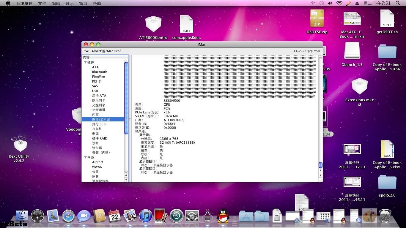

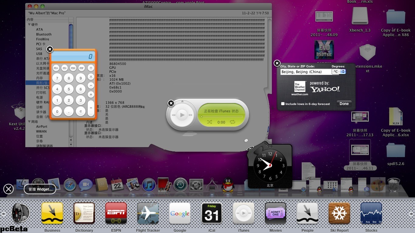

Recently a post was published at a chinese Hackintosh forum, here I just translate the topic for you ;)
The original post available here if you can read chinese -_-
http://bbs.pcbeta.com/thread-836915-1-1.html
OK! Here is the things
1.This bootloader
http://www.insanelymac.com/forum/index.php?showtopic=231768
2.Framebuffer "Nomascus"
3.GraphicsEnabler
4.ATI5000Controller.kext
However, they did not mention whether we need to modify X3000.kext but it seems to be no, you can have a try baby :P
He can get resolution of 1366x768, Dashboard effect, Transparent Menubar, QE/CI after do things above. Here are the evidences
Hope you guys success =]

Here is newest translation from http://bbs.pcbeta.com/thread-839862-1-1.html ;):P
I delete some of the steps that were not important.
首先來介紹一下案例的硬件:
Here is the introduction of the succeeded notebook.
Acer 4745g:i5 430m(with intel hd graphics)+HM55+ ATI Mobility Radeon HD 5650 1GRAM VGA+HDMI輸出
如果你持有類似配置的筆記本,請看一下是否符合以下條件:
2.請下載並安裝原版10.6.4(最好不要用整合版系統或者從10.6.3升級)
Install 10.6.4 (Prefer clean install)
4.相信大部分使用5650m的筆記本都會搭配intel的CPU集成顯卡,請確定你的CPU顯卡可以被關閉。
If your notebook's hardware included intel CPUs intel hd graphics, please disable it in the BIOS.

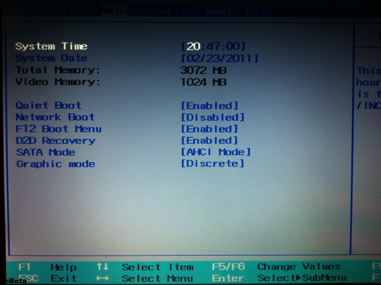

5.請進BIOS,設置Graphic mode = Discrete ,如果沒有這個選項,請參看說明書
Set "Graphic mode = Discrete" in BIOS
6.如果你的CPU顯卡無法關閉,將很可能無法驅動5650m
If you cannot disable your intel HD, your mobility may not be mounted successfully.
9.變色龍的版本很多,不要追求最新版本,如果你想驅動5650m,請使用我貼中的r700 boot
Use Chameleon r650 and r700 boot
Chameleon_v2.0_RC5_r650.pkg.zip
boot.zip
Files downloaded from the post.

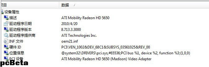

14.請在WINDOWS下的設備管理器中確認5650m的顯卡硬件ID為1002_68c1
Check if your mobility device id is 1002:68c1
15.請確認你的筆記本同樣具有VGA+HDMI 2個外置接口
Check if your notebook has VGA & HDMI output.
16.添加AtiConfig=Nomascus到com.apple.Boot.plist,如果你試了這個值不行,請嘗試其他全部30個ATICONFIG值
Add AtiConfig=Nomascus in com.apple.Boot.plist
17.驅動5650m不需要DSDT顯卡代碼,也無需設置smbios.plist
No DSDT and smbios.plist are needed.
18.安裝10.6.4系統前,請移動安裝盤System\Library\Extensions下的ATI5000Controller.kext到其他位置備用,替換好BOOT後再用B7安裝回去
Before installing 10.6.4, move ATI5000Controller.kext out from System\Library\Extensions.
19.另外建議刪除上述目錄裡AppleIntelGMA*****.kext,AppleIntelHDGraphics*****.kext 以及AppleIntelIntegratedFramebuffer.kext大約15個文件
Delete AppleIntelGMA*****.kext,AppleIntelHDGraphics*****.kext & AppleIntelIntegratedFramebuffer.kext if necessary.
*PCIRootUID=1may be needed if Chameleon hang
Method for replacing bootloader:
1.Run Terminal
2.Type
sudo cp + Space + "boot location" + Space + /
It will be like this if you place your bootloader in "/Users/User/Downloads/"
sudo cp /Users/User/Downloads/boot /
