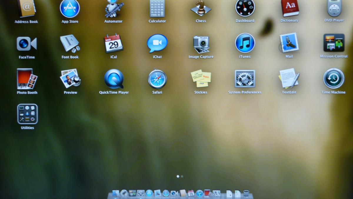

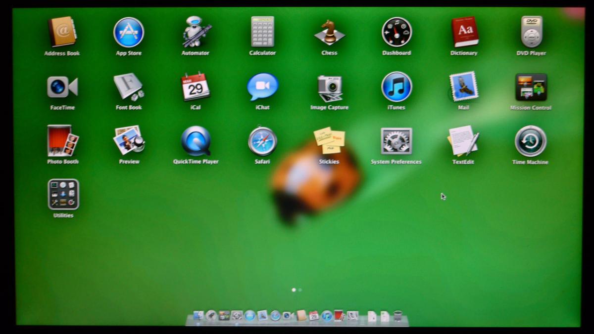

VideoSpigot Posted April 2, 2012 Share Posted April 2, 2012 Vilczech18 i have no lines on launchpad whatsoever, so i might not have the the 16bit collor problem, which version are you running? 10.7.3? what frambeuffer are you using? it makes a diference, i am using Hoolock Holy {censored}e. Are you saying that using Hoolock as frame buffer, your laptop's built-in display is showing SMOOTH GRADIENT, unlike everyone else with AMD 5650 and 6550? Well then, set your wallpaper to either "Ladybug" or "Eagle & Waterfall", then run Launchpad and see if you don't see the same 10-bit type banding effect as these screenies*: The above are shot with a camera instead of screen-captured because once output to a proper display capable of 32 bit color, the banding artifact will be gone. BTW, Hoolock isn't the only frame buffer to use, not at all, or at least not on my 6550 card. Before this, I always held on to the superstition (thanks to this thread and others) that Hoolock is where it's at. Last weekend I sat down with 2 pints and went through every goddamn ATI frame buffer on the list. My finding is nothing short of amazing. There are plenty of frame buffers that work EXACTLY LIKE Hoolock: Same exact performance, same 10-bit banding on the built in display, same blank output on external display. I sat patiently through it all, typing "GraphicsEnabler-Y AtiConfig=xxxxx" on each reboot, spell checking carefully each time. I really thought I could strike gold and find the perfect frame buffer that will give me that elusive 32-bit color on the internal display. Sadly, I came up with none. I think the ATI5000Controller KEXT is to blame. After all, if the KEXT is working right, then we should be able to use the display ports for external output. Fortunately, my effort wasn't completely wasted. I found one frame buffer that manages to do what others wouldn't. So without further ado, try and set this on your Chameleon Wizard: AtiConfig=Langur Link to comment https://www.insanelymac.com/forum/topic/248751-mobility-radeon-hd-5650-qeci-work-262-update/page/5/#findComment-1810504 Share on other sites More sharing options...
