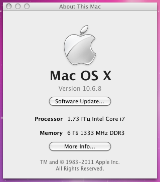

TheEugeneKam Posted June 24, 2011 Share Posted June 24, 2011 Two finger scroll works, its set to be reversed by default for some reason, just go to trackpad and uncheck the very first thing on top. Nothing else. Also got no battery, just an X going through it. I did use the kext above, deleted the voodobattery, added the usb fix to the plist and ran next utility to repair. Still nothing. To Vlad: I got the error again with DSDT where it shows i have nvidia 435 with 2GB. I have 445 with 3 GBs, you did something to the DSDT before for me, not sure what but that fixed it. I am using all the files you posted in the latest release pack of 10.7 Try Second, there is an update for DP4 in updates, should i update or will that kill my system? Im curious, what do you guys use for back up? Just in case an accidental update kills my system? Link to comment https://www.insanelymac.com/forum/topic/247741-guide-dell-l701x-xps-17-late-2010/page/10/#findComment-1702941 Share on other sites More sharing options...
vladlenas Posted June 25, 2011 Share Posted June 25, 2011 After updating 10.6.8, works perfectly . Two finger scroll works, its set to be reversed by default for some reason, just go to trackpad and uncheck the very first thing on top. Nothing else. Also got no battery, just an X going through it. I did use the kext above, deleted the voodobattery, added the usb fix to the plist and ran next utility to repair. Still nothing. To Vlad: I got the error again with DSDT where it shows i have nvidia 435 with 2GB. I have 445 with 3 GBs, you did something to the DSDT before for me, not sure what but that fixed it. I am using all the files you posted in the latest release pack of 10.7 Second, there is an update for DP4 in updates, should i update or will that kill my system? Im curious, what do you guys use for back up? Just in case an accidental update kills my system? Be not afraid to be updated, after updating it is necessary to reinstall only audio of the driver. Link to comment https://www.insanelymac.com/forum/topic/247741-guide-dell-l701x-xps-17-late-2010/page/10/#findComment-1703407 Share on other sites More sharing options...

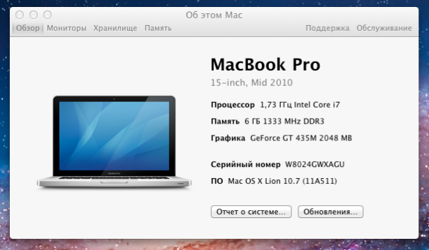

TheEugeneKam Posted June 25, 2011 Share Posted June 25, 2011 For me i meant the lion update. The DP4 got a gig worth of updates, is it safe to install those too, i seen people stuck with KP after that. Vlad any way you can edit the DSDT for me so i get 445 nvidia with 3GBs? Does it matter for system performance to have the correct video card showing up? Ya tolko zametil chto mnogo hackintosh users c rossii. Link to comment https://www.insanelymac.com/forum/topic/247741-guide-dell-l701x-xps-17-late-2010/page/10/#findComment-1703497 Share on other sites More sharing options...
vladlenas Posted June 26, 2011 Share Posted June 26, 2011 For me i meant the lion update. The DP4 got a gig worth of updates, is it safe to install those too, i seen people stuck with KP after that.Vlad any way you can edit the DSDT for me so i get 445 nvidia with 3GBs? Does it matter for system performance to have the correct video card showing up? Ya tolko zametil chto mnogo hackintosh users c rossii. I have on DP4 updating has passed without problems. DSDT I to you already edited, I have not understood at you it does not work? Я не из России . Link to comment https://www.insanelymac.com/forum/topic/247741-guide-dell-l701x-xps-17-late-2010/page/10/#findComment-1703672 Share on other sites More sharing options...

TheEugeneKam Posted June 26, 2011 Share Posted June 26, 2011 I have on DP4 updating has passed without problems.DSDT I to you already edited, I have not understood at you it does not work? Я не из России . The DSDT you edited for me before was for 10.6.7, so it would work with the lion? The DSDT I'm using now is the one from you latest post. The settings with this show my video card to be nvidia 435 2 GB. I have 445 3GB on my laptop. By the way, the DP4 update, the 1 gig one works perfectly, just had to fix the audio Ya toje, ya tam rodilsya no jivu v Canada ceichas Link to comment https://www.insanelymac.com/forum/topic/247741-guide-dell-l701x-xps-17-late-2010/page/10/#findComment-1704001 Share on other sites More sharing options...
vladlenas Posted June 27, 2011 Share Posted June 27, 2011 The DSDT you edited for me before was for 10.6.7, so it would work with the lion? The DSDT I'm using now is the one from you latest post. The settings with this show my video card to be nvidia 435 2 GB. I have 445 3GB on my laptop. By the way, the DP4 update, the 1 gig one works perfectly, just had to fix the audio Ya toje, ya tam rodilsya no jivu v Canada ceichas I use one DSDT for 10.6.8 and Lion. А я из бывшего Союза . Link to comment https://www.insanelymac.com/forum/topic/247741-guide-dell-l701x-xps-17-late-2010/page/10/#findComment-1704172 Share on other sites More sharing options...

BuffDriver Posted June 28, 2011 Share Posted June 28, 2011 After updating 10.6.8, works perfectly . Be not afraid to be updated, after updating it is necessary to reinstall only audio of the driver. I have had much difficulty upgrading to 10.6.8. The new NVidia Drivers will not install on my L701X. The installation reports "Unsupported System. This computer will not support this NVidia graphics solution." Indeed, the NVidia site does not list the 400M series as supported by these drivers. I tried re-installing the older Fermi drivers, but boot stops at [PCI Configuration Begin]. I've tried booting in safe mode, but no luck. My biggest fear is that I won't be able to install Lion if I can't get 10.6.8 installed. Can anyone tell me how to load the new graphics drivers? Thanks for the help! Update: I solved the boot problem by rolling back IOPCIFamily, AppleACPIPlatform, and IO80211. I've successfully upgraded to 10.6.8, but my system's performance is slow. I am continuing to investigate, but my Cinebench OpenGL dropped from 23 to 3 Update 2: Okay, I disabled AppleGraphicsPowerManagement.kext per this topic: http://www.insanelymac.com/forum/index.php...20&start=20 Graphic performance is back. I've still lost Bluetooth, but overall I think I'm ready for the Lion upgrade. Link to comment https://www.insanelymac.com/forum/topic/247741-guide-dell-l701x-xps-17-late-2010/page/10/#findComment-1704714 Share on other sites More sharing options...
