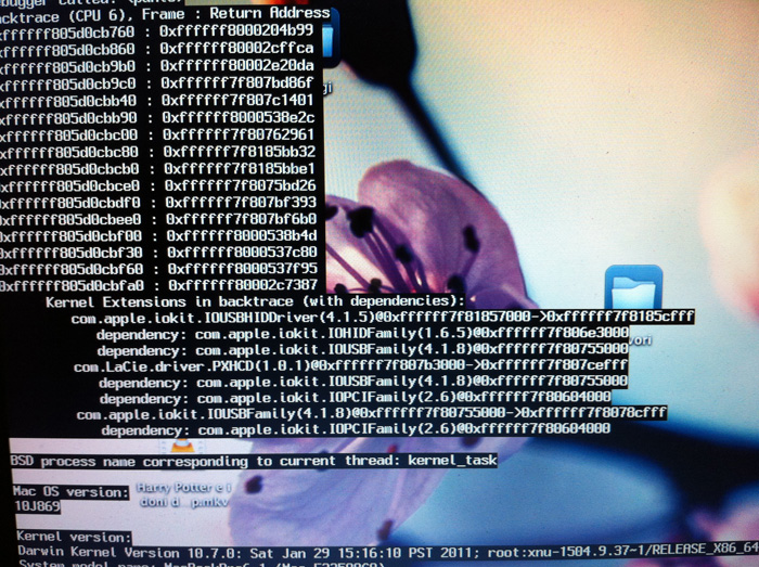

bombadil7 Posted May 13, 2011 Share Posted May 13, 2011 everytime i plug out the USB mouse from the 2 rear usb ports it gaves this error.. left and right side usb ports work.. how can i resolve this? thanks Link to comment https://www.insanelymac.com/forum/topic/247741-guide-dell-l701x-xps-17-late-2010/page/5/#findComment-1683087 Share on other sites More sharing options...
vladlenas Posted May 13, 2011 Share Posted May 13, 2011 Ok I will send all as soon as I can. Did you update your nvidia drivers to the latest ones that you posted ? It looks like a lot of people are having problems updating to them according to the comments on netkas website. *Edit It seems that the Tony Mac update 2 have the exact same drivers inside, which is the ones I installed anyway. I have they cost a week, there are no problems. everytime i plug out the USB mouse from the 2 rear usb ports it gaves this error.. left and right side usb ports work.. how can i resolve this? thanks I shall check up at myself in the evening. I have too so. Link to comment https://www.insanelymac.com/forum/topic/247741-guide-dell-l701x-xps-17-late-2010/page/5/#findComment-1683112 Share on other sites More sharing options...
bombadil7 Posted May 13, 2011 Share Posted May 13, 2011 what can it be? it happens only with usb mouse.. not with usb drivers or external hard disks... anyway.. i tried your applehda and ioaudiofamily.. and is very very better than the old applehda.. but some songs (i guess is a channel "problem") sound is quite disturbed, like a vibration.. i mean like an old and very used 3.5 jack.. is it only my problem? Link to comment https://www.insanelymac.com/forum/topic/247741-guide-dell-l701x-xps-17-late-2010/page/5/#findComment-1683249 Share on other sites More sharing options...
