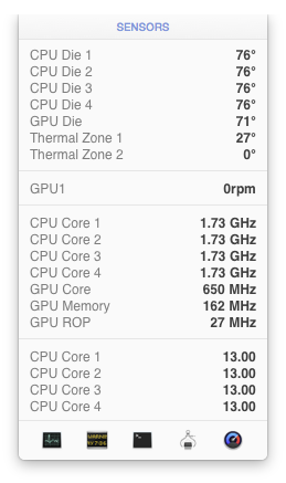

avin7000 Posted December 23, 2014 Share Posted December 23, 2014 ^will do it. Btw have you made any changes to DSDT with regarding to power management? My machine was fine in Mavericks (but then it was different config/kexts). It did shutdown, like once in six months. But not like this. With Mavericks: - I was using vladlens kexts and chameleon config - it would never get hot - fans were never full speed like now Now in Yosemite: - I am using your kexts and config - sometimes it runs fine. No issues at all. However fan is spinning always - sometimes graphic performance takes a hit. Suddenly it slows down, takes time to change tab in Safari - fan starts running full speed and suddenly shutsdown Could this be a graphic issue? Shall I patch AppleIntelCPUPowerManagement, by AsusAICPUPM=true in clover? Note that I am not doing any CPU/GPU intensive task. I am just using chrome with 1 or 2 tabs open. That's all. Link to comment https://www.insanelymac.com/forum/topic/247741-guide-dell-l701x-xps-17-late-2010/page/19/#findComment-2097455 Share on other sites More sharing options...
avin7000 Posted December 28, 2014 Share Posted December 28, 2014 Looks like you are right. It is seems to be running at high frequency always and temp is around 75C even for normal usage i.e. only Chrome browser with two tabs open, no youtube or stuff. One tab with Gmail and another insanelymac. And it never going down below 73C. what to do? please help guys Link to comment https://www.insanelymac.com/forum/topic/247741-guide-dell-l701x-xps-17-late-2010/page/19/#findComment-2098455 Share on other sites More sharing options...
whitegerry Posted December 31, 2014 Share Posted December 31, 2014 1. No code added or chaged regarding to power management. 2. I think there is no need to patch AsusAICPUPM. ^will do it.Btw have you made any changes to DSDT with regarding to power management?My machine was fine in Mavericks (but then it was different config/kexts). It did shutdown, like once in six months. But not like this.With Mavericks:- I was using vladlens kexts and chameleon config- it would never get hot- fans were never full speed like nowNow in Yosemite:- I am using your kexts and config- sometimes it runs fine. No issues at all. However fan is spinning always- sometimes graphic performance takes a hit. Suddenly it slows down, takes time to change tab in Safari- fan starts running full speed and suddenly shutsdownCould this be a graphic issue?Shall I patch AppleIntelCPUPowerManagement, by AsusAICPUPM=true in clover?Note that I am not doing any CPU/GPU intensive task. I am just using chrome with 1 or 2 tabs open. That's all. Looks like you are right. It is seems to be running at high frequency always and temp is around 75C even for normal usage i.e. only Chrome browser with two tabs open, no youtube or stuff. One tab with Gmail and another insanelymac. And it never going down below 73C.Screen Shot 2014-12-28 at 10.02.54 pm.pngwhat to do? please help guys Is your turbo frequency working normally? Each cpu core should work in the frequency range of 931MHz to 2.93GHz. I don't know why your cpu and gpu frequency was up to the highest level if your laptop was in an idle task according to your capture. Link to comment https://www.insanelymac.com/forum/topic/247741-guide-dell-l701x-xps-17-late-2010/page/19/#findComment-2099176 Share on other sites More sharing options...
avin7000 Posted January 8, 2015 Share Posted January 8, 2015 There was lots of dust clogged up in my machine and thermal paste had wore off completely. I had it serviced, now it certainly looks better. The idle temperate is 55-60 and Chrome usage never goes beyond 65-70. However if I start playing some videos, the temperature reaching at 85-87C. what are the temperatures in your laptop? next time when you are watching a movie, can you check after an hour or so? Link to comment https://www.insanelymac.com/forum/topic/247741-guide-dell-l701x-xps-17-late-2010/page/19/#findComment-2101724 Share on other sites More sharing options...
