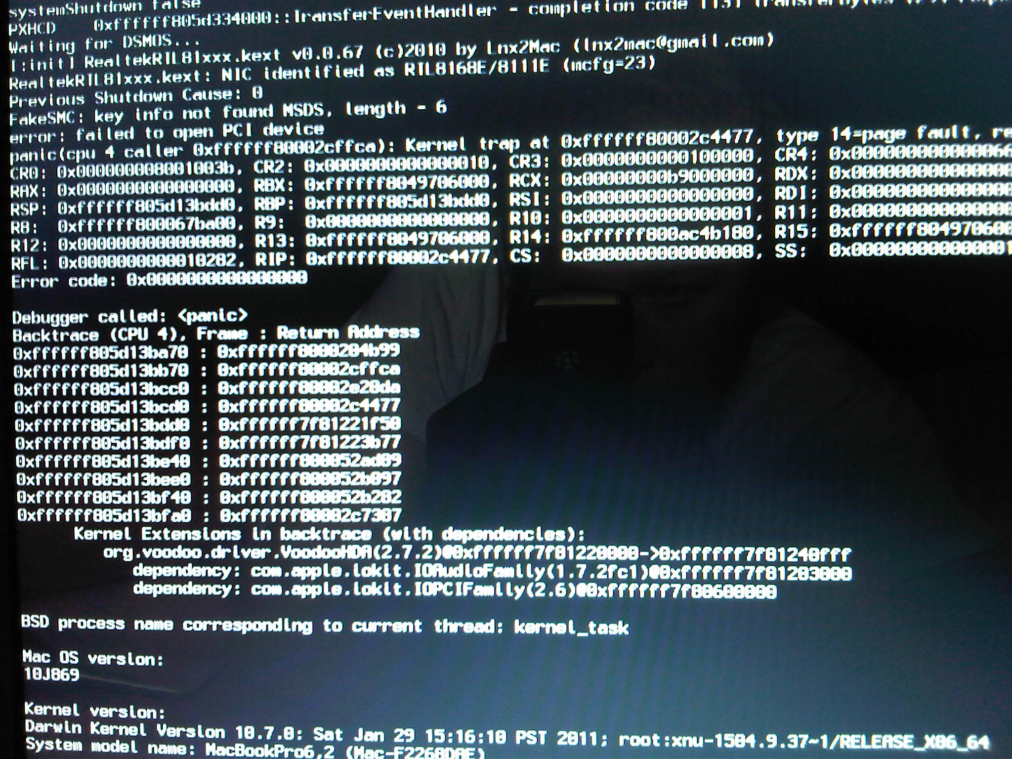

TheEugeneKam Posted June 9, 2011 Share Posted June 9, 2011 That's what I get when I do just a regular non cd boot when I verbose mode it. Link to comment https://www.insanelymac.com/forum/topic/247741-guide-dell-l701x-xps-17-late-2010/page/8/#findComment-1695205 Share on other sites More sharing options...
vladlenas Posted June 9, 2011 Share Posted June 9, 2011 That's what I get when I do just a regular non cd boot when I verbose mode it. Remove AppleHDA.kext. AppleHDA+VoodooHDa=KP you should use only one of them. Link to comment https://www.insanelymac.com/forum/topic/247741-guide-dell-l701x-xps-17-late-2010/page/8/#findComment-1695209 Share on other sites More sharing options...
