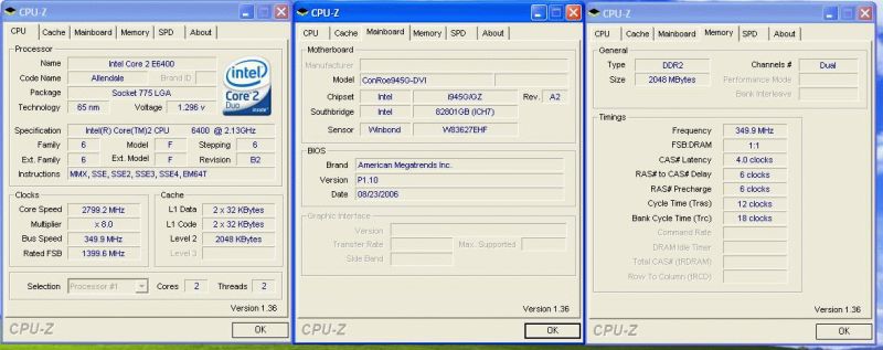

Wipmac Posted September 8, 2006 Share Posted September 8, 2006 my system doesnt even boot into bios at 350 fsb and 117 pcie @Infamous: what ram u use? here its MDT 667 CL4 RAM 2x1GB Link to comment https://www.insanelymac.com/forum/topic/24637-asrock-conroe945g-dvi/page/5/#findComment-184525 Share on other sites More sharing options...

Infamous Posted September 9, 2006 Share Posted September 9, 2006 Wipmac : you have to set your memory options manually, or use the memory ratio divider. I've set the ratio to 200mhz, which makes it work at 533mhz while FSB is at 350 (1400mhz). It's always best to run your memory at 533mhz with lowest possible timings (CL). Tecnoworld: actually, not "fry", but data corruption while copying/writing may happen. You can put a better cooling on ICH7 (southbridge) and copy 100GB of data (ZIP file) between 2 harddisks. Then create MD5 checkcsum and if it's the same, you are just fine. This can take some hours... Some more, actually. MD5 of 100GB is death 6 hours Primestable so far here EDIT: my latest finding is that nothing is overclocked at 117PCIe (PCI,ICH7 and other stuff). Since we are setting PCIe async, everything is kept at at default speed but only PCIe is changed to requested frequency. PCI, ICH7, USBs etc. would be only overclocked -if the PCIe is set to sync- and above 100mhz. So no data corruption or components stressing. Link to comment https://www.insanelymac.com/forum/topic/24637-asrock-conroe945g-dvi/page/5/#findComment-184670 Share on other sites More sharing options...

Wipmac Posted September 9, 2006 Share Posted September 9, 2006 my latest finding is that nothing is overclocked at 117PCIe (PCI,ICH7 and other stuff). Since we are setting PCIe async, everything is kept at at default speed but only PCIe is changed to requested frequency. PCI, ICH7, USBs etc. would be only overclocked -if the PCIe is set to sync- and above 100mhz. So no data corruption or components stressing.[/b] how did u check that? i just dont understand why i cant go over 320 fsb... not even booting into bios. have an extra soundcard and a NIC in the 2 PCI-slots. but if u say the pci slots are not stressed during overclocking, that shouldnt be the problem. ram is set to 5-5-5-5-15. 533mhz. any clues? Link to comment https://www.insanelymac.com/forum/topic/24637-asrock-conroe945g-dvi/page/5/#findComment-184704 Share on other sites More sharing options...
Infamous Posted September 9, 2006 Share Posted September 9, 2006 plympton : Good to know, thx. I've checked GMA900 but was not sure if it's needed. Wipmac: Make sure you've got Bios 1.1, everything disabled in CPU section (except VT). Then in memory settings, set the ratio to the first option: 200mhz. That will set your memory to @ 533mhz. Second option will run it 1:1, so 700mhz - your 667mhz memory should handle that. But try to make it run something around 4-4-4-4-10, not more. You can add some voltage at the bottom of the screen... (set to High) Link to comment https://www.insanelymac.com/forum/topic/24637-asrock-conroe945g-dvi/page/5/#findComment-184713 Share on other sites More sharing options...

Infamous Posted September 9, 2006 Share Posted September 9, 2006 I'm using stock cooler. It seems pretty good enough for 350 FSB I've set it to Slow in BIOS, desired temperature 60C. CPU never went to 60C even in 100% load of both cores for whole night. 54C Max. So i guess the cooler is enough... Only reason to replace it would be if you need somethin quieter. Link to comment https://www.insanelymac.com/forum/topic/24637-asrock-conroe945g-dvi/page/5/#findComment-184801 Share on other sites More sharing options...

passport Posted September 10, 2006 Share Posted September 10, 2006 I just got done with the burnin on my system and have some numbers. As you can see from the attachment I'm dual-booting OS X and XP. I'm running Patriot 667 memory and the Artic Cooling Pro 7. The system is rock stable at 350 and I could probably tighten the ram timings a bit more (I've run it at a little over 800 with looser timings) by I don't need to find the edge of instability. Thanks for the info, I was stuck at 335 running async @ 113 Xbench.txt Link to comment https://www.insanelymac.com/forum/topic/24637-asrock-conroe945g-dvi/page/5/#findComment-185071 Share on other sites More sharing options...
