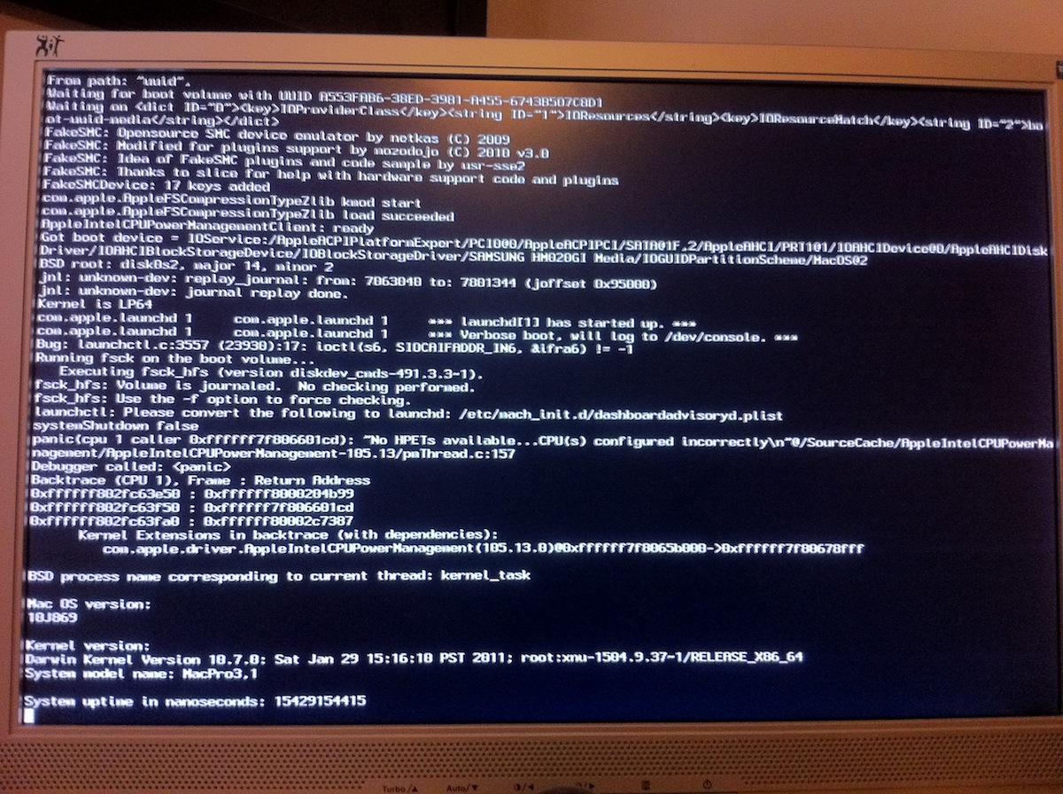

The Weez Posted June 22, 2011 Share Posted June 22, 2011 P35-DS3L??? post a photo and DSDT I confirmed that it is a P35-DS3L by looking at the board. What do I take a photo of? :confused: I will post DSDT as soon as I get it back up and running. Thanks! Update: I hope you wanted a photo of the kernal panic screen, because that's what I took. I've also included my dsdt.aml. I have not put the DSDT back back in my Extra folder yet because I need to use this computer. dsdt.aml.zip Link to comment https://www.insanelymac.com/forum/topic/235523-dsdt-auto-patcher/page/156/#findComment-1701685 Share on other sites More sharing options...

The Weez Posted June 23, 2011 Share Posted June 23, 2011 Enable HPET in bios setup Thank you, I will enable HPET and put that DSDT file (the one I attached) into my Extra folder and reboot. Edit: I just got home from work and tried to boot. It panicked again. I had not put the DSDT into extras so I'm not sure. HPET had been enabled in 32bit mode. I'm going to reinstall Snow Leopard now with HPET set to 64bit. When I went into the BIOS settings everything had returned to default. I changed the settings and retried; they kept going back to default. I dont understand why. I have never seen this. Edit again: No more problems with BIOS resetting. I reinstalled Snow Leopard and the only extras I did was use the Extras folder installer and chameleon. I get the same kernel panic on booting. Any way I can remove whatever the Extras folder did? Link to comment https://www.insanelymac.com/forum/topic/235523-dsdt-auto-patcher/page/156/#findComment-1702294 Share on other sites More sharing options...

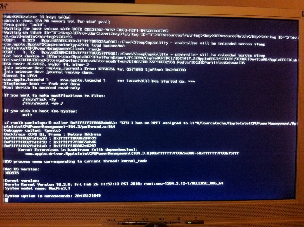

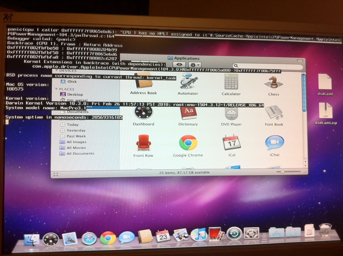

The Weez Posted June 24, 2011 Share Posted June 24, 2011 I've never seen a case like his remove from single user -s try it mount -uw / rm -rf /Extra exit I always have to be unique. :censored2: I booted with -s and it panicked. See attached screenshot. I found that I was able to remove /Extra because when the desktop comes up I have a few seconds before it panics. So I moved /Extra to the trash, then it panicked, and I rebooted. No joy. I posted a screenshot of this KP below. I wonder if my computer does not like Chameleon? When I first installed Snow Leopard I used [url="http://www.insanelymac.com/forum/topic/279450-why-insanelymac-does-not-support-tonymacx86/"]#####[/url] and everything booted fine. My only problem was it would not sleep and audio did not work, so I tried your method and that's when it started panicking. Link to comment https://www.insanelymac.com/forum/topic/235523-dsdt-auto-patcher/page/156/#findComment-1702749 Share on other sites More sharing options...
