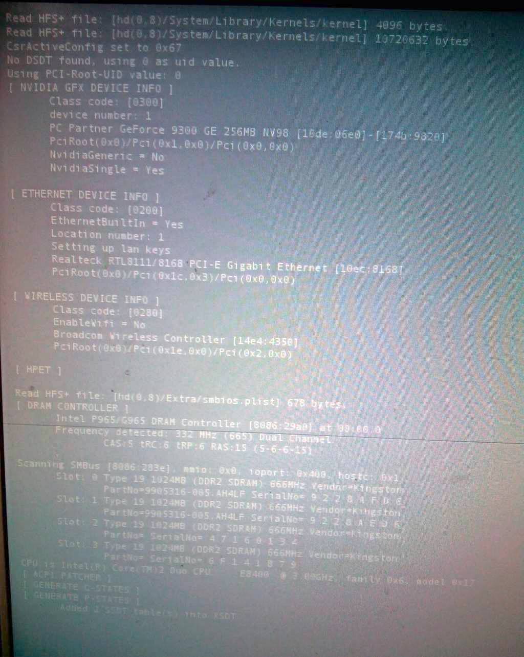

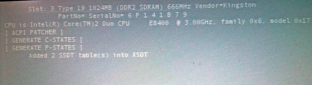

Zenith432 Posted May 17, 2016 Share Posted May 17, 2016 And I found the root cause is (2807) trunk/i386/libsaio/fake_efi.c, it didn't boot with my old MB asus P5B. After replace to old fake_efi.c (2790-2806) and rebuild boot file, the kext reading works fine and boot to 10.11.4 system now.(patched kernel) So I can't use Enoch branch 2816 now. It's because of this // // FIXME: PM Timer is usually @ 0x408, but its position is relocatable // via PCI-to-ISA bridge. The location is reported in ACPI FADT, // PM Timer Block address - zenith432 // Your PM Timer is not at 0x408, so esi always gets the same value, and the continue statement there generates an infinite loop. As a temporary workaround, comment out the continue statement a few lines below this comment. I need to think of a permanent solution. The fix to the kernel path for Enoch (or this problem) has not been checked in yet. 2 Link to comment https://www.insanelymac.com/forum/topic/231075-chameleon-24svn-official-pkg-installer/page/152/#findComment-2238548 Share on other sites More sharing options...
Zenith432 Posted May 17, 2016 Share Posted May 17, 2016 (edited) crazybirdy, Please try attached fake_efi.c with trunk 2815. Overwrite i386/libsaio/fake_efi.c and make a clean build of boot. Check if it prevents the freeze, or if the workaround causes a noticeable delay. If it's ok I'll commit it. Thanks. Edit: Attachment removed, committed to r2817. Edited May 17, 2016 by Zenith432 2 Link to comment https://www.insanelymac.com/forum/topic/231075-chameleon-24svn-official-pkg-installer/page/152/#findComment-2238556 Share on other sites More sharing options...
crazybirdy Posted May 17, 2016 Share Posted May 17, 2016 crazybirdy, Please try attached fake_efi.c with trunk 2815. Overwrite i386/libsaio/fake_efi.c and make a clean build of boot. Check if it prevents the freeze, or if the workaround causes a noticeable delay. If it's ok I'll commit it. Thanks. Good news. Rebuild trunk 2815 with new fake_efi.c, boot fine to system 10.11.4 without any freeze or errors with -v -f, patched kernel. Thanks, have a nice day. 2 Link to comment https://www.insanelymac.com/forum/topic/231075-chameleon-24svn-official-pkg-installer/page/152/#findComment-2238567 Share on other sites More sharing options...
