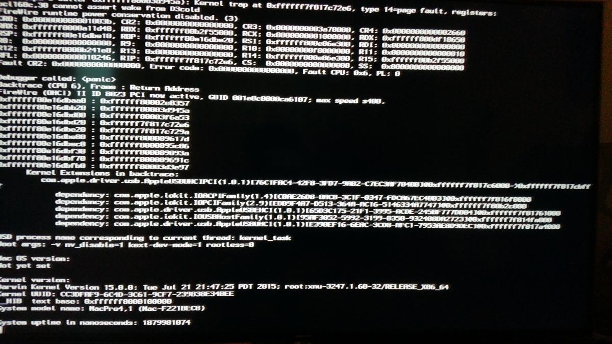

Hey guys,
Can someone help me with this kernel panic? Running 10.11 DB5. Tried the last 3 Enoch's revisions but no luck. I've upgraded from 10.10.4 with success. Got the DB2 update, worked fine, then the DB3, same thing, then after DB4 kernel panic. Since I had the boot loader on usb stick, I've plugged the hd to my iMac (27-late 2013). Removed the kexts for my Hac (from S/L/E), which basically where just 3, FakeSMC, VoodooHDA and AppleIntelE1000e (all the most recent versions), and booted from this hd on iMac. Updated to DB5 (I thought maybe will fix the error this way), installed the kexts again, used Kext Utility 2.6.4 to rebuild cache and hooked the hd back to my Hac (PC). Same kernel panic like in DB4. My specs - signature.
Thanks to anyone who could help, point me in the right direction, to fix it.

No idea. This also happened to me with dp1 on the first/second attempt, then gone by itself...
anyway appear to be USB 2 related
That's the"annoying" thing! I've never had any errors (kernel panics) like this before. And I've run successfully OS X from 10.6 to 10.10 (and I might add 10.11 DB1-DB3) on this Hac (PC) (just one hardware change, new graphics card; old was 9800 GT). (It's as close to a Mac Pro 4,1 as it can be.)
Anyway, thanks for taking the time to read my post. :)
It's not related to the boot loader but the USB kext (possibly modified? DSDT EHCx patch required?). Best to move the posts in the relevant 10.11 section...
Didn't modify any kext. All are stock. Unless Apple modified/changed something from DB3 to DB4 (which probably happened). Tried with/without dsdt in Extra. Same thing. dsdt was created in Yosemite with MaciASL (no errors/warnings).
Anyway, if you say is not a boot loader thing, I'll look in other more appropriate threads. Thanks.

You can remove /System/Library/Extensions/IOUSBHostFamily.kext/Contents/PlugIns/AppleUSBUHCIPCI.kext, but usb may not work.
Or, fix it follow this.. http://www.insanelymac.com/forum/topic/306777-guide-usb-fix-el-capitan-1011/
