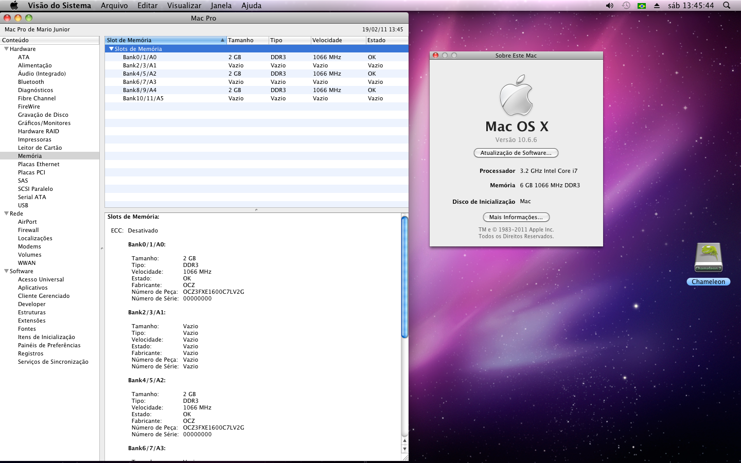

bkdwt Posted February 19, 2011 Share Posted February 19, 2011 I'm having a little problem with the Chameleon and GA-X58A-UD3R because the system is showing the memory with a frequency of 1066, and the frequency it is at 1600Mhz. I'm using Chameleon v747, and another earlier version did the same thing. On windows, the frequency of memory is correct, but not the Mac. What could this be? Link to comment https://www.insanelymac.com/forum/topic/225766-chameleon-rc5-mode-with-mem-detection-enabled-and-automatic-p-states-c-states-generation-for-native-power-managment/page/48/#findComment-1642136 Share on other sites More sharing options...
MaLd0n Posted February 19, 2011 Share Posted February 19, 2011 I'm having a little problem with the Chameleon and GA-X58A-UD3R because the system is showing the memory with a frequency of 1066, and the frequency it is at 1600Mhz. I'm using Chameleon v747, and another earlier version did the same thing. On windows, the frequency of memory is correct, but not the Mac. What could this be? add in smbios SMmemspeed=1600 Link to comment https://www.insanelymac.com/forum/topic/225766-chameleon-rc5-mode-with-mem-detection-enabled-and-automatic-p-states-c-states-generation-for-native-power-managment/page/48/#findComment-1642140 Share on other sites More sharing options...
bkdwt Posted February 20, 2011 Share Posted February 20, 2011 add in smbiosSMmemspeed=1600 Thanks again Mald0n. Broke my branch again ... kkkk Link to comment https://www.insanelymac.com/forum/topic/225766-chameleon-rc5-mode-with-mem-detection-enabled-and-automatic-p-states-c-states-generation-for-native-power-managment/page/48/#findComment-1642345 Share on other sites More sharing options...

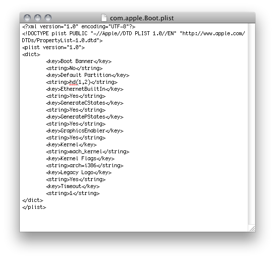

ChildOfInsanity Posted March 6, 2011 Share Posted March 6, 2011 Hi, I`m noob and would like to ask for your help with getting native speedstep to work. I have 10.6.6, GA-965-S3, C2D E6300 B2, Ati X1950Pro, chameleon RC5 r681, booting in 32bit. My system is running with dsdt, everything works. Then checked these commands, but I don`t know what to get from them "PerformanceStateArray" = (<7c0b0000000000000a0000000a0000002807000001000000>,<d8090000000000000a0000000a0000002806000002000000>) CSTInfo" = 19136773 kextstat | grep LPC 72 0 0x552b8000 0x3000 0x2000 com.apple.driver.AppleLPC (1.4.12) <14 5 4 3> My smbios and boot plist: Could it be the smbios set to MacPro 2.1? Also, if I run voodoomonitor with the kext, it show correct Psates and status, however with strange temps (like 50°C), so it looks like speedstep works. But if I run PstateChanger, it crashes. And MSRTools says Speedstep: Off and shows max freq all the time. I use FakeSMC with plugins IntelThermal and iStat reads cpu around 30°C. So this is not ok, is it? Thank you! Link to comment https://www.insanelymac.com/forum/topic/225766-chameleon-rc5-mode-with-mem-detection-enabled-and-automatic-p-states-c-states-generation-for-native-power-managment/page/48/#findComment-1650299 Share on other sites More sharing options...

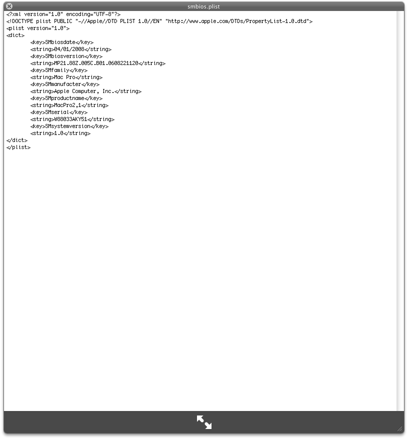

ChildOfInsanity Posted March 6, 2011 Share Posted March 6, 2011 I have set smbios to MacPro 3,1 and it seems to work! MSRTools is showing correct speedstep, CPU-I too. PStateChanger still crashes, don`t know why. Why smbios product name make speedstep work? Link to comment https://www.insanelymac.com/forum/topic/225766-chameleon-rc5-mode-with-mem-detection-enabled-and-automatic-p-states-c-states-generation-for-native-power-managment/page/48/#findComment-1650466 Share on other sites More sharing options...
cartri Posted March 7, 2011 Share Posted March 7, 2011 I have set smbios to MacPro 3,1 and it seems to work! MSRTools is showing correct speedstep, CPU-I too. PStateChanger still crashes, don`t know why. Why smbios product name make speedstep work? Because the OS is prepared to each kind of cpu and chipset based on the model. If you use MP31 it will want the chipset correlatives of the Xeon 5xxx plus the intel 5400 chipset (the most close would be core 2 and p35/45), if you use MP41/51 it will want the correlative to intel 5520 chipset, what would be likely the X58 plus the i7 9xx (triple channel ddr) - in other words, Tylersburg arch. As so the power management profile is loaded based on the nearest CPU to the original Xeon and it's chipset. As your signature shows a core 2 duo, you are in the i5400 scope if you want to emulate a workstation (MacPro) system. The new power management found in the newest versions of chameleon is very interesting, but first take notice if your cpu arch is or not supported by the OS itself (in your case it is) as the real SSDTs are dynamic and not present inside the ACPI module of your firmware but loaded from it accordingly to your pre-boot options (such as OC, FSB, etc) and the detection of the system itself (used in Apple Systems as OSDW method, changing only of name to other systems). Link to comment https://www.insanelymac.com/forum/topic/225766-chameleon-rc5-mode-with-mem-detection-enabled-and-automatic-p-states-c-states-generation-for-native-power-managment/page/48/#findComment-1650893 Share on other sites More sharing options...

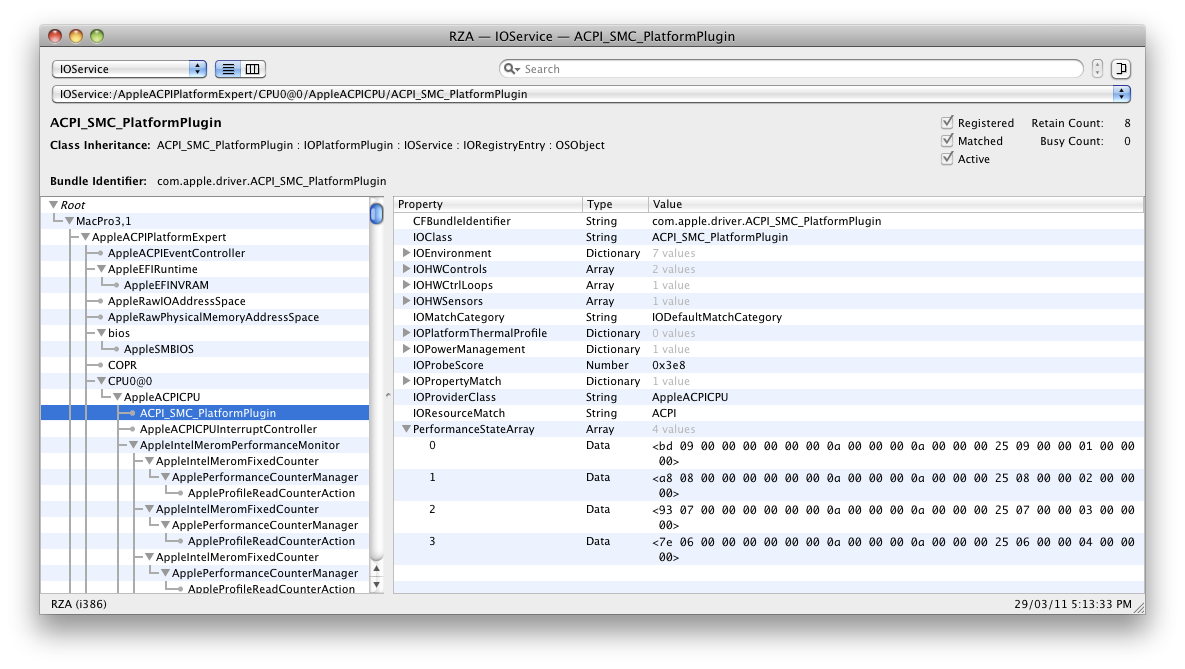

Lolrus Posted March 29, 2011 Share Posted March 29, 2011 I can't seem to get c-states working. It is enabled in BIOS and I get the "c-states created successfully" message on boot but if I remove CPUPM disabler I get a KP. P-states seem to be generated correctly (see PerformanceStateArray) Q6600/GA-P35-DS3R/BIOS F13 Any ideas? Link to comment https://www.insanelymac.com/forum/topic/225766-chameleon-rc5-mode-with-mem-detection-enabled-and-automatic-p-states-c-states-generation-for-native-power-managment/page/48/#findComment-1662549 Share on other sites More sharing options...
