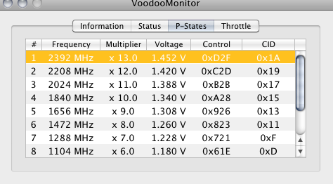

Pluskat5000Schiffe Posted December 19, 2010 Share Posted December 19, 2010 Hey guys. I have something really weird at my HP8710W mobile workstation (laptop 17inch). I have my system setup almost 100% perfect now instead of one stupid thing. To be short the FSB settings are incorrect detected of CPU (T7700) and memory DD2 666MHz. If I use any of the Valv's bootloaders all FSB settings are detected correct but if I use that bootloader the sound is cracky. With the Chameleon RC5 bootloader the sound is perfect clear but system isn't running at full potential because of lower FSB frequency. I need to use VooDooHDA for the ADI1981 audio chip. The FSB is detected as 184Mhz instead of 200Mhz. The memory is detected incorrect: DSDT is corrected and speed stepping is working perfect with wrong frequencies of course and no errors from Apple Power kexts. Can somebody help me to get my system even more work flawless OSX ? THX! bsmesg output: Intel GM965/GL960 DRAM Controller [8086:2a00] at 00:00.0 Frequency detected: 306 MHz (613) Dual Channel CAS:5 tRC:5 tRP:5 RAS:15 (5-5-5-15) Slot: 0 Type 19 2048MB (DDR2 SDRAM) 613MHz Vendor=Nanya Technology PartNo=NT2GT64U8HD0BN-3C SerialNo=44EB4813 Slot: 2 Type 19 2048MB (DDR2 SDRAM) 613MHz Vendor=Nanya Technology PartNo=M2N2G64TU8HD5B-3C SerialNo=46761856 below max frequency should be 2600 GHz (13X200) instead of 2392 (12 X 183) Note that 2,6GHz is impossible to run on both. This CPU T7700 has dynamic acceleration and maybe thats causing the problem because one core will be at 11X multiply when the first core can reach 13X Maybe the problem can be fixed by limiting the max multiply to 12 and so disabling dynamic acceleration but thats just my noob thinking :-) Link to comment https://www.insanelymac.com/forum/topic/225766-chameleon-rc5-mode-with-mem-detection-enabled-and-automatic-p-states-c-states-generation-for-native-power-managment/page/46/#findComment-1604869 Share on other sites More sharing options...
valv Posted December 19, 2010 Share Posted December 19, 2010 @hannibal1969, regarding cracky sound on anval, did u try latest version. also instead of FixFSB key, try ForceFSB with (186,...) as value. That's if u still want to give it a try. I not I fully understand Link to comment https://www.insanelymac.com/forum/topic/225766-chameleon-rc5-mode-with-mem-detection-enabled-and-automatic-p-states-c-states-generation-for-native-power-managment/page/46/#findComment-1605029 Share on other sites More sharing options...
Pluskat5000Schiffe Posted December 19, 2010 Share Posted December 19, 2010 Yep I tried all version from 5.06 lowering as low to version 4 all versions good detection but cracky sound. If I force the FSB to 184 the sounds is back to normal. If I adjust it to lets say 190MHz its starting to be cracky. The detection o the FSB in the standard Chameleon version is detected wrong with 184MHz as FSB but it seems to know that it should settle at 184 to get the sound good. The memory is FSB 166MHZ X4 and the CPU is FSB 200 X 13 max so memory / PCI / CPU are running with different FSB and maybe thats going wrong with the audio chip. Maybe it wants to force a FSB of 200MHz to the PCI bus but it should be 166MHz ? Link to comment https://www.insanelymac.com/forum/topic/225766-chameleon-rc5-mode-with-mem-detection-enabled-and-automatic-p-states-c-states-generation-for-native-power-managment/page/46/#findComment-1605048 Share on other sites More sharing options...
valv Posted December 19, 2010 Share Posted December 19, 2010 The detection o the FSB in the standard Chameleon version is detected wrong with 184MHz as FSB but it seems to know that it should settle at 184 to get the sound good.No, chameleon is detecting it right. My version is forcing it.It is fully an messy Bios version. That is from where the fault came. Look if you can make a bios update. If I adjust it to lets say 190MHz its starting to be cracky.You better stick with a value below 190 then. Link to comment https://www.insanelymac.com/forum/topic/225766-chameleon-rc5-mode-with-mem-detection-enabled-and-automatic-p-states-c-states-generation-for-native-power-managment/page/46/#findComment-1605054 Share on other sites More sharing options...
Pluskat5000Schiffe Posted December 19, 2010 Share Posted December 19, 2010 No, chameleon is detecting it right. My version is forcing it.It is fully an messy Bios version. That is from where the fault came. Look if you can make a bios update. You better stick with a value below 190 then. mmm there is one newer .. F0:F im now using F0:E the DSDT made for my laptop (not by myself) was done to F0:E so Im afraid that the DSDT is not working correctly anymore with F0:F Just upgraded the bios to F0F no difference also upgarded to the newest chameleon auto detection still incorrect. Link to comment https://www.insanelymac.com/forum/topic/225766-chameleon-rc5-mode-with-mem-detection-enabled-and-automatic-p-states-c-states-generation-for-native-power-managment/page/46/#findComment-1605075 Share on other sites More sharing options...
