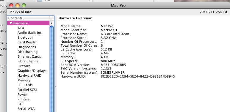

I can confirm that my 9 series motherboard works using your guide. (with a few ajustments...)
I can only seem to run 10.6.7
I had to get rid of the usb 3 enabler as it caused a kernal panic.
At the moment I have no sound and my sata controler is not regonised so when I try mass file copying/put one or more drives under stress finder crashes. As a minor annoyance the 8800gts no longer seems to work properly even when I install the same driver that got it working perfectly last time.
