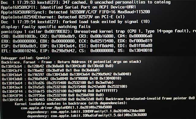

oldnapalm Posted December 4, 2005 Share Posted December 4, 2005 My mother board is a MSI 945P Neo Platinum. In 8f1111 AppleHDA.kext causes a panic at boot as seen on attached image. Trying to load the kext manually: kextload -t AppleHDA.kext kernel extension AppleHDA.kext has problems: Validation failures { "Kext has a kernel dependency prior to version 6.0 and CFBundleVersion does not match executable's MODULE_VERSION" = true } Missing dependencies { "com.apple.iokit.IOHDAFamily" = "No valid version of this dependency can be found" } The kext from build 8f1099 works well in 8f1111. As in 8f1099 Safari, Mail and iChat can´t make SSL connections. ssh client works. 8f1099 crashes (turn off/reboot screen) when connecting to a samba share, at least this got fixed in 8f1111. Any ideas about SSL problems? Thanks. Link to comment Share on other sites More sharing options...
