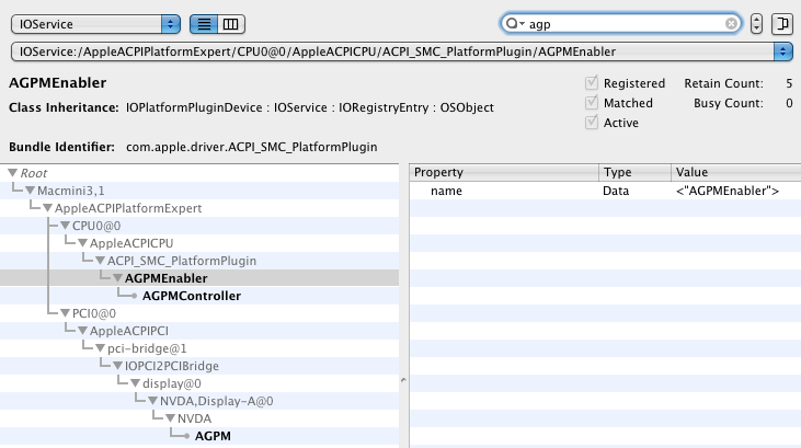

mikeetastic Posted July 1, 2010 Share Posted July 1, 2010 Ok. Than you never added gpu powermanagement for your Mac Type ID (MacMini3.1). Same for me iMac5,1 , i use, hasnt any AGPM active.MacMini didnt have in real such an gpu so, AGPM is not active Thats OK for Apple Machines. To getting AGPM working , better visit other thread, too offtpic that driver thread. In short: You need 2 injectors (like AHCIPort) which are prepared for your gpu dev-id and Mac Type ID and put them into the /Extra/Extensions + .mkext. One config is much more easy , only one key (iMac5,1) > yours, And one gpu deviceID(0191) > yours. The other . plist is much bigger and has lots of iMac5,1 entries to change to yours ! Dont miss one to edit, otherwise no effect. Attached both , change my used iMac5,1 into yours (all occurences !) and gpu deviceid 0191 (only once) into yours Thanks mitchde for the kind reply but t seems GPU PM is not working for me.. i made the kext work and loaded with no error on my machine but my GPU is still running at full (vanilla kext or not) not sure what i am missing! sorry for the OT.. maybe someone can point me where is the thread about GPU PM.. Link to comment Share on other sites More sharing options...

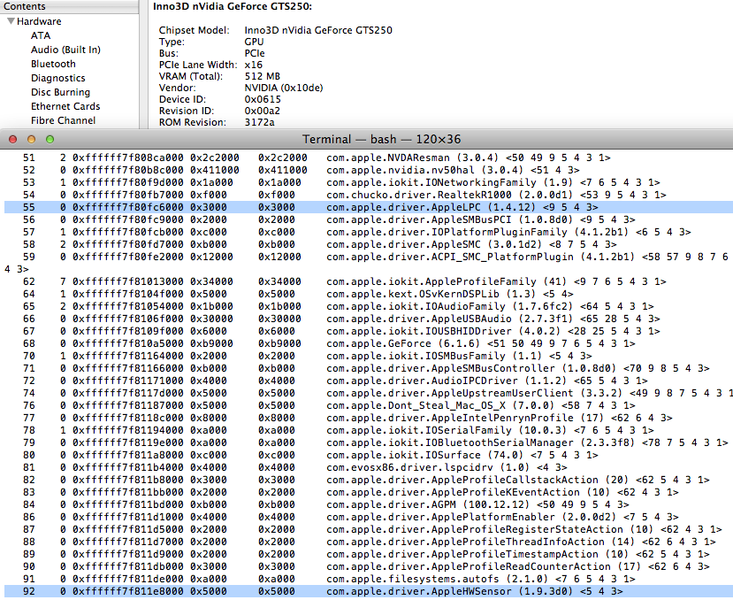

mitch_de Posted July 1, 2010 Share Posted July 1, 2010 Whats your GPU device ID ? You may attatch your two .kext also, so i can take a look. Also an must (check with kextstat ) : AppleLPC and AppleHWSensor (both orig. Apple kext) must loaded (shown in kextstat output list). Link to comment Share on other sites More sharing options...

mikeetastic Posted July 5, 2010 Share Posted July 5, 2010 Whats your GPU device ID ? You may attatch your two .kext also, so i can take a look.Also an must (check with kextstat ) : AppleLPC and AppleHWSensor (both orig. Apple kext) must loaded (shown in kextstat output list). GPU device ID is 0x0615.. the kext i used are the ones you uploaded but i changed 0191 (yours) to 0615 (mine).. i also change all iMac5,1 to Macmini3,1 (tested iMac9,1 too but same) 2_LegacyKext.zip AppleLPC ((ICH10) LPC Interface Controller [8086:3a18]) works out of the box on mine and AppleHWSensor.. anymore ideas? not sure if i'm doing something wrong? Link to comment Share on other sites More sharing options...

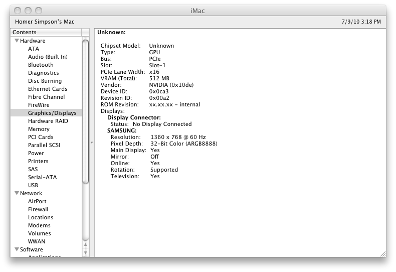

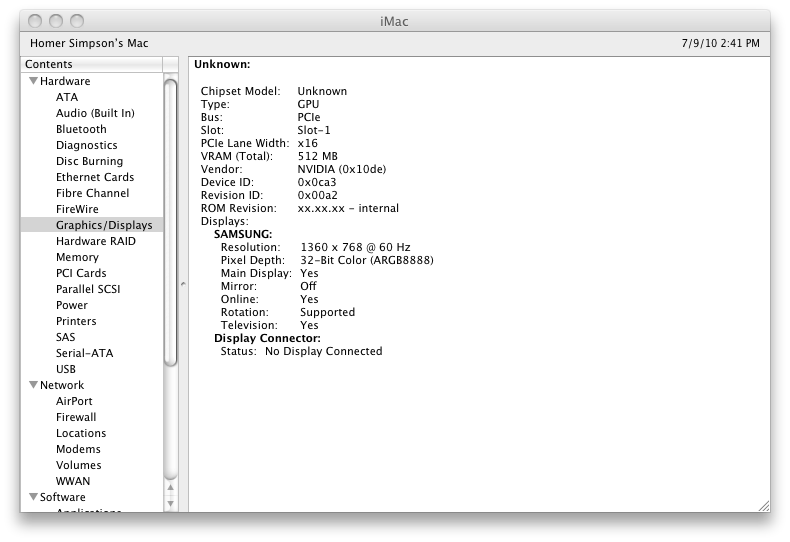

Plucka Posted July 9, 2010 Share Posted July 9, 2010 Hey all I have the drivers installed and am using a Palit GT240 512MB Nvidia card. What I dont see in the about this mac info, see pics (left DVI to HDMI in) (right HDMI to HDMI in), is that it is a recognized chipset or vendor?. Also HDMI out to my Samsung Television just gives me a blue screen? Does anyone have any ideas on how to get the about this mac stuff straight or doesnt it really matter? Is it just cosmetic? Also the blue screen I get when I connect HDMI out to HDMI in on my Tele? EDIT, HDMI works after leaving DVI adaptor in and then plugging HDMI into HDMI port on video card. Removed DVI adaptor and rebooted the PC starts up with no problems, cant really tell if there is a performance improvement though. Must say the picture looks/feels crisper in any case. EDIT EDIT EDIT: Stopped working had to revert back to 7600GT. Lost nearly all resolution options, does anyone have any tips for installing the above mentioned card? Thanks in advance for any replies I may receive, cheers Plucka Link to comment Share on other sites More sharing options...

Plucka Posted July 11, 2010 Share Posted July 11, 2010 Hey all I have the drivers installed and am using a Palit GT240 512MB Nvidia card. What I dont see in the about this mac info, see pics (left DVI to HDMI in) (right HDMI to HDMI in), is that it is a recognized chipset or vendor?. Also HDMI out to my Samsung Television just gives me a blue screen? Does anyone have any ideas on how to get the about this mac stuff straight or doesnt it really matter? Is it just cosmetic? Also the blue screen I get when I connect HDMI out to HDMI in on my Tele? EDIT, HDMI works after leaving DVI adaptor in and then plugging HDMI into HDMI port on video card. Removed DVI adaptor and rebooted the PC starts up with no problems, cant really tell if there is a performance improvement though. Must say the picture looks/feels crisper in any case. EDIT EDIT EDIT: Stopped working had to revert back to 7600GT. Lost nearly all resolution options, does anyone have any tips for installing the above mentioned card? Thanks in advance for any replies I may receive, cheers Plucka Attached thumbnail(s) Link to comment Share on other sites More sharing options...
