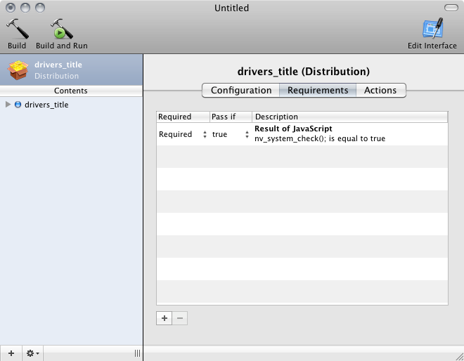

kalel83 Posted June 28, 2010 Share Posted June 28, 2010 Besides pacifist, there are two ways to modify the installer to work without checking if you have a 285 (the drivers are universal). I used the second way to install on my GTS 250. #1 To remove platform dependency from the package:1. Install XCode if you haven't yet(from Mac OS X Install disc). 2. Run /Developer/Applications/Utilities/PackageMaker.app 3. Drag the package with drivers on the package maker dock icon. 4. Remove the system check procedure from requirements:(see attachment img) 5. Build&Run This works on Mac OS Install dvd's in a similar way as well(if you have a non-retail restore dvd). The package name would be OSInstall.mpkg in /System/Installation/Packages/ on the dvd. #2 19.5.8f03 can be installed on any system if you edit setup checking algorithm. Simply locate "distribution.dist" inside driver package, then delete part of program with "unsupported_title" and "unsupported_message" strings, save and install. Link to comment Share on other sites More sharing options...

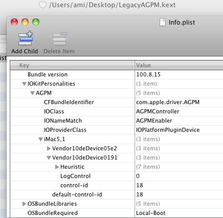

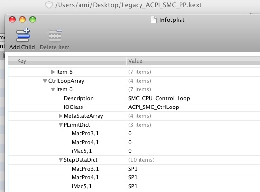

mitch_de Posted June 30, 2010 Share Posted June 30, 2010 Ok. Than you never added gpu powermanagement for your Mac Type ID (MacMini3.1). Same for me iMac5,1 , i use, hasnt any AGPM active. MacMini didnt have in real such an gpu so, AGPM is not active Thats OK for Apple Machines. To getting AGPM working , better visit other thread, too offtpic that driver thread. In short: You need 2 injectors (like AHCIPort) which are prepared for your gpu dev-id and Mac Type ID and put them into the /Extra/Extensions + .mkext. One config is much more easy , only one key (iMac5,1) > yours, And one gpu deviceID(0191) > yours. The other . plist is much bigger and has lots of iMac5,1 entries to change to yours ! Dont miss one to edit, otherwise no effect. Attached both , change my used iMac5,1 into yours (all occurences !) and gpu deviceid 0191 (only once) into yours LegacyAGPM.kext.zip Legacy_ACPI_SMC_PP.kext.zip Link to comment Share on other sites More sharing options...
