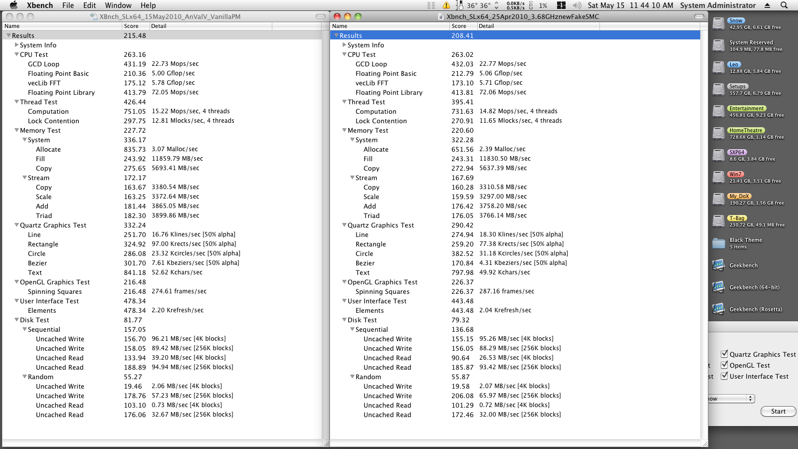

And I'm posting the results as a PNG screenshot. You won't believe the results!

The attached XBench (GFX only) Benchmarks show the differences in the results.
Now, you can see few things...
Certain HDD transfer rates have a +ve and -ve change.
Certain GFX results have +ve and -ve change.
Overall score has shot up.

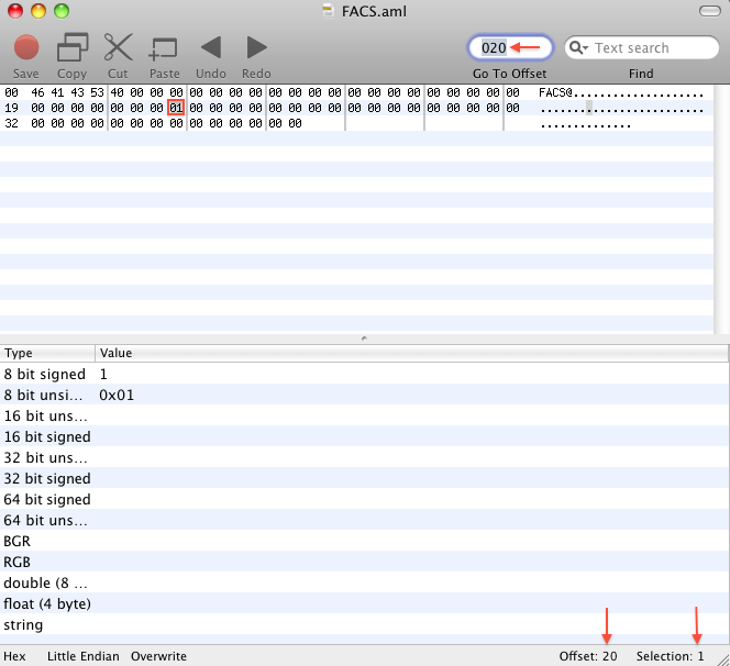

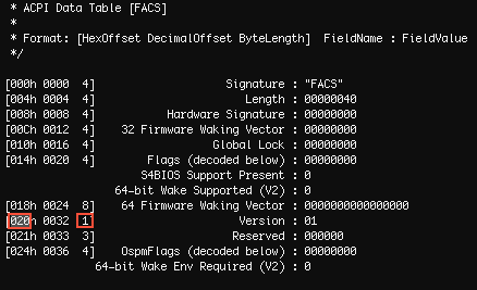

ok, that's the deal: we have to modify the version's value to "1". not sure if it'd fix that issue though. After all, we got nothing to loose :D
The tricky thing is, u cannot edit it as u usually done with dsdt hacks. For of all, we'll need to know on which offset does this value appear. This can be easily found by looking at the beginning of the line (where the value is) on the dsl file, as shown below
now from links to right, the first highlight is our offset, and the second one is for the byte length (only 1 in our case).
Next grab an hex editor (I'll be using 0xED), open the compiled file (not the dsl one) "facs.aml" (u'll not be able to compile it either, so grab the one u've been extracting from linux). Now jump to the known offset and change the highlighted byte there to "1", just like on the following screenshot
Save the file to facs.aml, and put it back to Extra. Reboot and see what happens.
