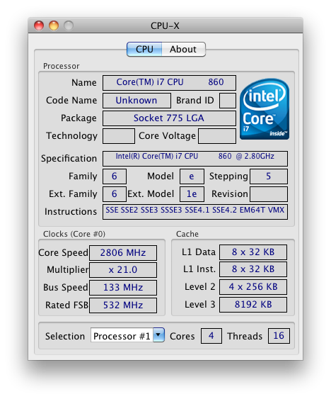

valv Posted June 19, 2010 Author Share Posted June 19, 2010 yep, the second one load the dsdt oblivioulsy.do you need to know something specific? it seem to me it works like the old version did already thanks. I don't follow here, do u mean same as 06/04 versions? does it load the dsdt file? did it fix those issues u've been having? what about fsb and cpu model, does it show up correctly? Thanks, My Core i7 860 went from being recognized as an Intel Xeon to simply "Unknown". would u provide me with a dump of cpu family and model please! Link to comment Share on other sites More sharing options...
spyguy007 Posted June 19, 2010 Share Posted June 19, 2010 would u provide me with a dump of cpu family and model please! Here's what CPU-X says. Link to comment Share on other sites More sharing options...

spyguy007 Posted June 19, 2010 Share Posted June 19, 2010 do this on terminal sudo sysctl -a | grep cpu, and provide me with the dump. thanks hw.ncpu = 8 hw.cpufrequency = 2806000000 hw.availcpu = 8 hw.ncpu: 8 hw.activecpu: 8 hw.physicalcpu: 4 hw.physicalcpu_max: 4 hw.logicalcpu: 8 hw.logicalcpu_max: 8 hw.cputype: 7 hw.cpusubtype: 4 hw.cpu64bit_capable: 1 hw.cpufamily: 1801080018 hw.cpufrequency: 2806000000 hw.cpufrequency_min: 2806000000 hw.cpufrequency_max: 2806000000 hw.cputhreadtype: 1 machdep.cpu.max_basic: 11 machdep.cpu.max_ext: 2147483656 machdep.cpu.vendor: GenuineIntel machdep.cpu.brand_string: Intel(R) Core(TM) i7 CPU 860 @ 2.80GHz machdep.cpu.family: 6 machdep.cpu.model: 30 machdep.cpu.extmodel: 1 machdep.cpu.extfamily: 0 machdep.cpu.stepping: 5 machdep.cpu.feature_bits: 3219913727 10019837 machdep.cpu.extfeature_bits: 672139520 1 machdep.cpu.signature: 67301 machdep.cpu.brand: 0 machdep.cpu.features: FPU VME DE PSE TSC MSR PAE MCE CX8 APIC SEP MTRR PGE MCA CMOV PAT PSE36 CLFSH DS ACPI MMX FXSR SSE SSE2 SS HTT TM SSE3 MON DSCPL VMX SMX EST TM2 SSSE3 CX16 TPR PDCM SSE4.1 SSE4.2 POPCNT machdep.cpu.extfeatures: SYSCALL XD RDTSCP EM64T LAHF TSCI machdep.cpu.logical_per_package: 16 machdep.cpu.cores_per_package: 8 machdep.cpu.microcode_version: 3 machdep.cpu.mwait.linesize_min: 64 machdep.cpu.mwait.linesize_max: 64 machdep.cpu.mwait.extensions: 3 machdep.cpu.mwait.sub_Cstates: 4384 machdep.cpu.thermal.sensor: 1 machdep.cpu.thermal.dynamic_acceleration: 1 machdep.cpu.thermal.invariant_APIC_timer: 0 machdep.cpu.thermal.thresholds: 2 machdep.cpu.thermal.ACNT_MCNT: 1 machdep.cpu.arch_perf.version: 3 machdep.cpu.arch_perf.number: 4 machdep.cpu.arch_perf.width: 48 machdep.cpu.arch_perf.events_number: 7 machdep.cpu.arch_perf.events: 68 machdep.cpu.arch_perf.fixed_number: 3 machdep.cpu.arch_perf.fixed_width: 48 machdep.cpu.cache.linesize: 64 machdep.cpu.cache.L2_associativity: 6 machdep.cpu.cache.size: 256 machdep.cpu.tlb.inst.small: 64 machdep.cpu.tlb.inst.large: 7 machdep.cpu.tlb.data.small: 64 machdep.cpu.tlb.data.large: 32 machdep.cpu.tlb.shared: 512 machdep.cpu.address_bits.physical: 36 machdep.cpu.address_bits.virtual: 48 machdep.cpu.core_count: 4 machdep.cpu.thread_count: 8 Link to comment Share on other sites More sharing options...

spyguy007 Posted June 19, 2010 Share Posted June 19, 2010 @spyguy007,ok, would u mind trying this one and looking if it reverts to xeon whoever could look at ioregexplorer>iodevicetree>efi>configuration-table and tell me what it shows there, would be much appreciated, thanks. Nope, still says Unknown. Link to comment Share on other sites More sharing options...
valv Posted June 19, 2010 Author Share Posted June 19, 2010 Nope, still says Unknown. Ok, this one should fix dsdt issues + cpu detection (unlikely) alpha4.zip As u can see, I renamed that one just to be sure about which one u'd be giving feedback. Greetz, Link to comment Share on other sites More sharing options...
spyguy007 Posted June 20, 2010 Share Posted June 20, 2010 That fixed it! My CPU is now showing up as a 2.81GHz Intel Core i7. Link to comment Share on other sites More sharing options...
