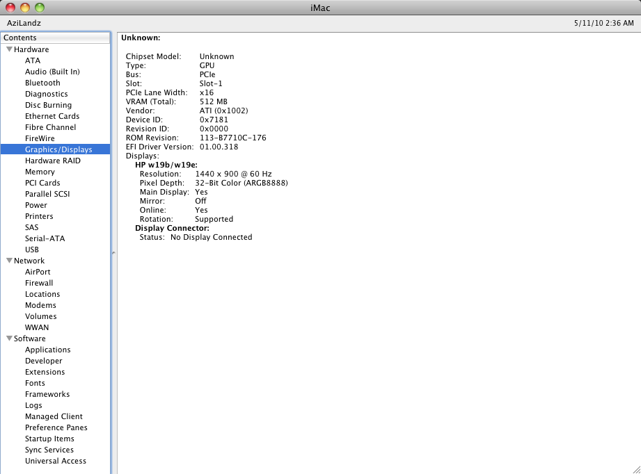

@atlee, finding out the correct framebuffer was the trickiest part of the process to me. I'm pretty sure the right one for my r516
is Caretta, this is how i got to that conclusion; on Leo (10.5.x) the simplest way to put my card to work is by:
- replace dev id 7187 on RadeonX1000 by mine (7181), on both info.plist & binary
- on the framebuffer change on
<key>IOProviderClass</key>
<string>IONDRVDevice</string>
to IOPCIDevice.
Now, to find the correct framebuffer what i did at the time was, use dsdt injection instead of editing the framebuffer and
change the framebuffer on the dsdt till i got it working. Two framebuffers worked, Sphyrna and Caretta, but Sphyrna gives me
some flickering and stripes across the screen so, Caretta it is ;)
I did this same search on Snow 10.6 (some months ago) and got a lot more framebuffers that work; can't remember how many
but Megalodon is one of them. Looked at ATIFramebuffer now and :wacko: lots of new personalities.. have to try that search again
soon and this time document it properly.
You can do the same search with Chameleon and GraphicsEnabler.. just change the framebuffer personality on your dev id.
In fact this just came to my mind :) never tried it but, should work.
Another thing, you probably know this but, keep in mind that the same framebuffer can possibly handle several gpu's.
Edit: not to mention the fact that many gpu's are just older rebranded versions.

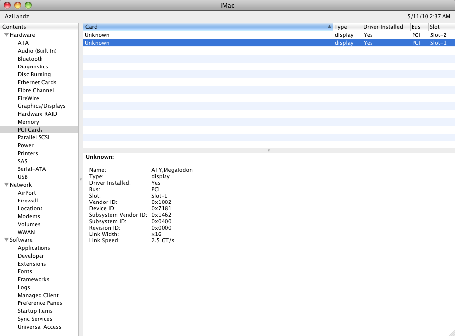

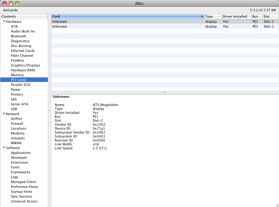

About ATI, as you may noticed mine it's not that new :D I don't know what changes you did but the only difference i noticed is on the
PCI Cards pane on System Profiler (check the pics); usually only shows the primary dev id 7181. I don't think the secondary dev id is
supposed to show on this pane; this is only supposed to show cards attached to the pci slots and only Slot-1 is in use on my machine,
the pcie x16 one.
By the way, can you tell me if this secondary dev id is related to second dvi or to the SVideo??
Never managed to figure that out. The card has two DVI+SVideo.
