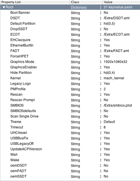

7] Edited the com.apple.Boot.plist file as suggested by valv for the DSDT, HPET, GraphicsEnabler, UHCIReset, EHCIRequire flags.
8] Voila! New bootloader (with the basic Chameleon boot screen :whistle:] with scores of lines as output.

Dear Chokra,
this is how I edited my boot.plist
try using the wait key to halt the screen and look what kind of tables get loaded then.
