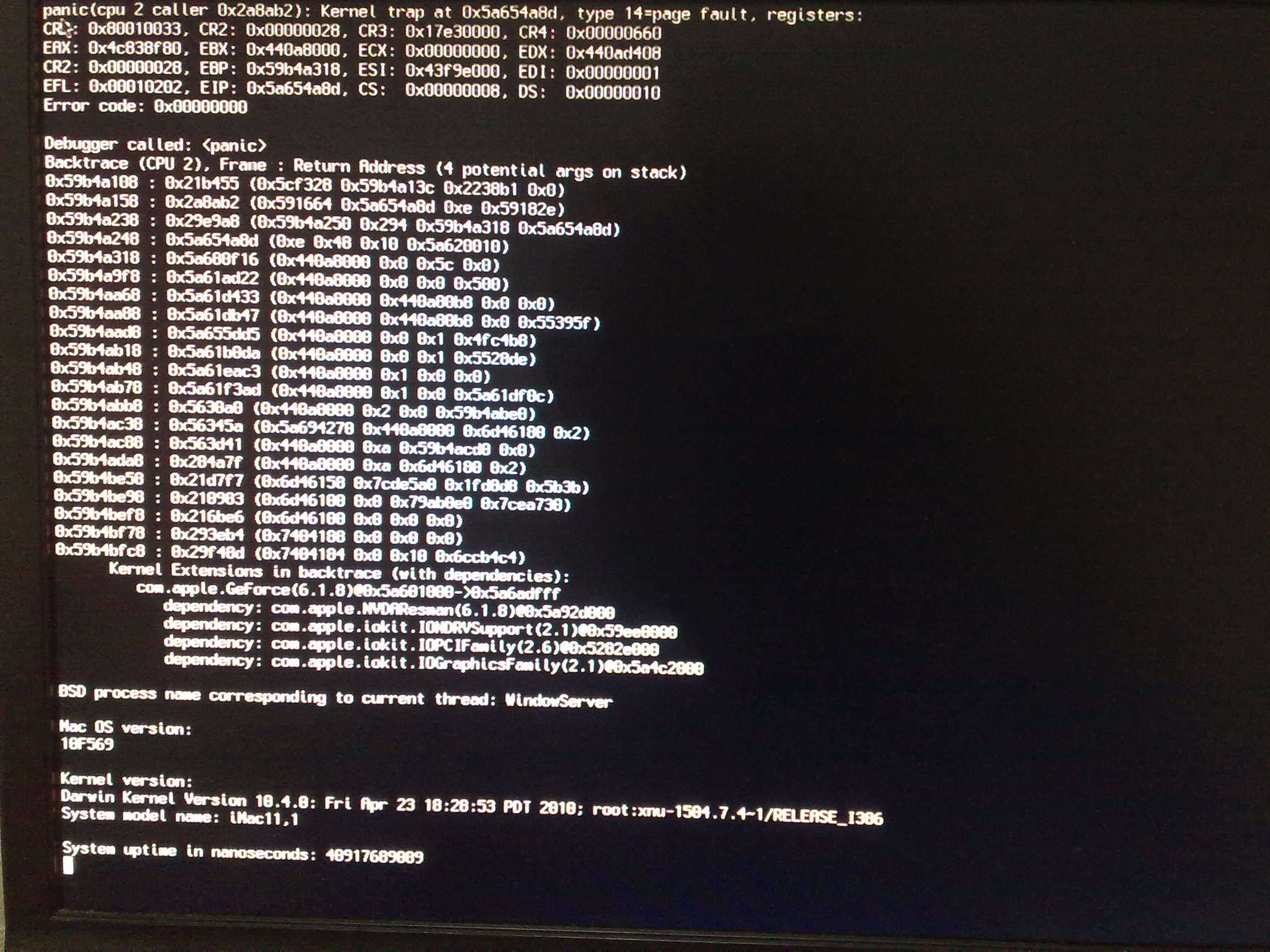

JimmyLL Posted September 29, 2010 Share Posted September 29, 2010 I'm using a gts 450, I add device-id in some kexts of the fermi-package, i got kernel panic with Geforce.kext like this replace the original geforce.kext it boot up without kernel panic but only blue screen, any idea? Link to comment https://www.insanelymac.com/forum/topic/214219-fermigtx-480gtx-470/page/33/#findComment-1556601 Share on other sites More sharing options...
Rune Forte Posted September 30, 2010 Share Posted September 30, 2010 I want to confirm that this one worked for me. Specs: Intel® Core™2 Quad Processor Q9550 Gigabyte GA-EP45-UD... 2 x 2GB RAM 1066 Old Card: GTx9800 New Card: GTX 470 1280MB Now, I installed the Snow Leopard Disk via partition, when i tried to do it with the 470 card plugged in the installation didn't start (Black Screen), so i plugged the Old Card, installed and followed the procedure above, then shutdown the computer, switched cards 9800 -> gtx 470, as the box started up, during the Chameleon prompt i pressed down and picked the "Ignore Caches" option and crossed my fingers, i can confirm everything went smothly I hope anyone else find this info useful Rgds r Hi, I tried the same thing, this is not working for me. I have been sifting through the forums for days and it seems like I get almost nowhere. If anyone has a similar setup and would be so kind to give me a step by step of what worked for them? Gigabyte GA-X58A-UD3R 2.0 Firmware FB Core i7 950 Stock Clock, Stock Cooler Zotac nVidia GTX 470 1280MB (in PCI-E 1) 12GB G.SKILL Ripjaws DDR3-1333 1.5v (F3-10666CL9T12GBRL) (only 4GB/1 module installed in slot 1) Things I've Tried: Instructions in post #1 Almost everything on Tonymacx86 GA-X58A-UD3R 2.0 Specific DSDT Chameleon RC4, Chameleon RC5 Kakewalk 2.2, [url="http://www.insanelymac.com/forum/topic/279450-why-insanelymac-does-not-support-tonymacx86/"]#####[/url] 2.3.0 (multiple options) NVEnabler, NVEnabler_64 nVidia Drivers 19.5.8f03, 256.00.05a23 NVFERMI.Fix.kext Modified nVidia individual kexts Device Injection (a few different ways) Writing a custom DSDT (several different ways) Attempt #1: Booting from CD Booting from [url="http://www.insanelymac.com/forum/topic/279450-why-insanelymac-does-not-support-tonymacx86/"]#####[/url] nVidia CD using -x safe mode option originally worked reliably, OS installed fine, updated to 10.6.4, still fine. Never got it to boot from HD, but it was progress. Turned the system off for 24hrs, came back, same configuration now kernel panics on Apple screen: panic(cpu 0 caller 0x55aa33): "Unable to find driver for this platform: \"ACPI"\.\n~@Extr/builds/xnu/xnu-1456.1.26/iokit/Kernel/IOPlatformExpert.cpp:1393 Debugger called backtrace etc... BSD Process name corresponding to current thread: Unknown Kernel version: Darwin Kernel Version 10.0.0: Mon Oct 12 04:0605 AST 2009; anappirtrvh: etc... Attempt #2 Booting from CD Booting from experimental nVidia GTX 470 specific [url="http://www.insanelymac.com/forum/topic/279450-why-insanelymac-does-not-support-tonymacx86/"]#####[/url] CD #1 to SL 10.6.4 on HD using following options http://www.tonymacx86.com/viewtopic.php?f=18&t=3853 -f -v GraphicsEnabler=Yes White screen (first frame of welcome video, frozen, mouse moves), forgets resolution, changes to 832x648 -f -v GraphicsEnabler=No Black screen, no signal, does not automatically restart -f -x -v Boots OK, System Profiler shows graphics card as GTX 470 1280MB, Vsync disabled, OpenGL Extensions Viewer states Apple Software Renderer (because of safe mode I assume) -f -v White screen, first frame of video, remembers resolution 1024x768 -f -x Apple screen, progress bar, indeterminate progress spinner Boots OK, Vsync active (no tearing, still shows Apple Software Rendered in OpenGL Extensions Viewer) no options (from CD) Blue screen, black screen, cursor moves, stays black indefinitely, Apple-Tab changes cursor to hand momentarily, Apple-Q and clicking around gets rainbow beachball of doom Tried to change a few things in Chameleon prefpane: Unchecked GraphicsEnabler EFI Inject: Checked Device Properties, Pasted from custom GTX470.plist Checked DSDT file: /Extra/DSDT.aml (customized prebuilt for GA-X58A-UD3R 2.0, other say it works for them) Attempt #3: Booting from Hard Drive -f New Apple screen flashes (chrome, not gray), immediately self-restarts Attempt #4: Booting from CD hot software restart -f Kernel panic, complains about unknown hardware, ethernet, audio Problem extensions: VooDooHDA (dependencies IOPCIFamily, IOAudioFamily), IOAudioFamily (dependencies OSvKernDSPLib) Attempt #5: Booting from CD warm hardware restart button -f -x Progress bar, Boots OK, forgot resolution again, GTX 470 shows in system profiles, still stuck in safe mode with software rendered graphics Guides I've tried: Tonymacx86 [url="http://www.insanelymac.com/forum/topic/279450-why-insanelymac-does-not-support-tonymacx86/"]#####[/url] + [url="http://www.insanelymac.com/forum/topic/279450-why-insanelymac-does-not-support-tonymacx86/"]#####[/url] 4/12/2010 Kakewalk 2.2 from Jpa Lnx2Mac Optimal BIOS Configuration for GA-X58A-UD3R 7/7/2010 Additional hacks I've tried: FakeSMC Disable SATA3 and USB3, not using those ports All SATA set to AHCI HPET on 64 bit ACPI Suspend S3(STR) DropSSDT SMproductname: MacPro4,1 Geniuses of the forums, help? TL;DR Core i7 950 on Gigabyte GA-X58A-UD3R 2.0 FB, 12GB RAM (4GB Installed), Zotac nVidia GeForce GTX 470 1280MB Boots to apple screen and immediately reboots infinite loop Link to comment https://www.insanelymac.com/forum/topic/214219-fermigtx-480gtx-470/page/33/#findComment-1556953 Share on other sites More sharing options...
