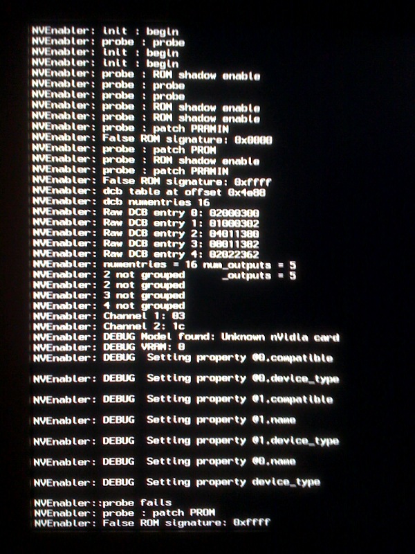

riskybacon Posted November 5, 2010 Share Posted November 5, 2010 This has been a very useful thread. I can't believe that I've gotten as far as I have with the hackintosh I'm working on. I followed the instructions in the 1st post and got an NVidia GeForce 480 GTX up and running with very little trouble. However, I have 4 of them. Once I add the 2nd card, the OS X boot process starts but never completes. It won't boot using single user mode and when I pass the boot loader the -v option, it seems to be hanging somewhere during NVEnabler. I've attached a picture of the point where the hang occurs. It will boot into Linux just fine and use all 4 cards. Here are the specs: EVGA SR-2 mobo 2 6 core Xeons (3.33GHz, X5680) 4 Nvidia GeForce 480 gtx 48 GB memory (I've pulled out all but 4GB) Here's the output from lscpi under Linux, with all 4 cards: % Just the video cards: lspci -nn | grep -i vga 07:00.0 VGA compatible controller [0300]: nVidia Corporation Device [10de:06c0] (rev a3) 08:00.0 VGA compatible controller [0300]: nVidia Corporation Device [10de:06c0] (rev a3) 0b:00.0 VGA compatible controller [0300]: nVidia Corporation Device [10de:06c0] (rev a3) 0c:00.0 VGA compatible controller [0300]: nVidia Corporation Device [10de:06c0] (rev a3) % Full output lspci -nn 00:00.0 Host bridge [0600]: Intel Corporation 5520 I/O Hub to ESI Port [8086:3406] (rev 22) 00:01.0 PCI bridge [0604]: Intel Corporation 5520/5500/X58 I/O Hub PCI Express Root Port 1 [8086:3408] (rev 22) 00:02.0 PCI bridge [0604]: Intel Corporation 5520/5500/X58 I/O Hub PCI Express Root Port 2 [8086:3409] (rev 22) 00:03.0 PCI bridge [0604]: Intel Corporation 5520/5500/X58 I/O Hub PCI Express Root Port 3 [8086:340a] (rev 22) 00:07.0 PCI bridge [0604]: Intel Corporation 5520/5500/X58 I/O Hub PCI Express Root Port 7 [8086:340e] (rev 22) 00:13.0 PIC [0800]: Intel Corporation 5520/5500/X58 I/O Hub I/OxAPIC Interrupt Controller [8086:342d] (rev 22) 00:14.0 PIC [0800]: Intel Corporation 5520/5500/X58 I/O Hub System Management Registers [8086:342e] (rev 22) 00:14.1 PIC [0800]: Intel Corporation 5520/5500/X58 I/O Hub GPIO and Scratch Pad Registers [8086:3422] (rev 22) 00:14.2 PIC [0800]: Intel Corporation 5520/5500/X58 I/O Hub Control Status and RAS Registers [8086:3423] (rev 22) 00:14.3 PIC [0800]: Intel Corporation 5520/5500/X58 I/O Hub Throttle Registers [8086:3438] (rev 22) 00:1a.0 USB Controller [0c03]: Intel Corporation 82801JI (ICH10 Family) USB UHCI Controller #4 [8086:3a37] 00:1a.1 USB Controller [0c03]: Intel Corporation 82801JI (ICH10 Family) USB UHCI Controller #5 [8086:3a38] 00:1a.2 USB Controller [0c03]: Intel Corporation 82801JI (ICH10 Family) USB UHCI Controller #6 [8086:3a39] 00:1a.7 USB Controller [0c03]: Intel Corporation 82801JI (ICH10 Family) USB2 EHCI Controller #2 [8086:3a3c] 00:1b.0 Audio device [0403]: Intel Corporation 82801JI (ICH10 Family) HD Audio Controller [8086:3a3e] 00:1c.0 PCI bridge [0604]: Intel Corporation 82801JI (ICH10 Family) PCI Express Root Port 1 [8086:3a40] 00:1c.2 PCI bridge [0604]: Intel Corporation 82801JI (ICH10 Family) PCI Express Root Port 3 [8086:3a44] 00:1c.4 PCI bridge [0604]: Intel Corporation 82801JI (ICH10 Family) PCI Express Root Port 5 [8086:3a48] 00:1d.0 USB Controller [0c03]: Intel Corporation 82801JI (ICH10 Family) USB UHCI Controller #1 [8086:3a34] 00:1d.1 USB Controller [0c03]: Intel Corporation 82801JI (ICH10 Family) USB UHCI Controller #2 [8086:3a35] 00:1d.2 USB Controller [0c03]: Intel Corporation 82801JI (ICH10 Family) USB UHCI Controller #3 [8086:3a36] 00:1d.7 USB Controller [0c03]: Intel Corporation 82801JI (ICH10 Family) USB2 EHCI Controller #1 [8086:3a3a] 00:1e.0 PCI bridge [0604]: Intel Corporation 82801 PCI Bridge [8086:244e] (rev 90) 00:1f.0 ISA bridge [0601]: Intel Corporation 82801JIR (ICH10R) LPC Interface Controller [8086:3a16] 00:1f.2 SATA controller [0106]: Intel Corporation 82801JI (ICH10 Family) SATA AHCI Controller [8086:3a22] 00:1f.3 SMBus [0c05]: Intel Corporation 82801JI (ICH10 Family) SMBus Controller [8086:3a30] 02:00.0 Ethernet controller [0200]: Marvell Technology Group Ltd. Device [11ab:4380] (rev 10) 03:00.0 Ethernet controller [0200]: Marvell Technology Group Ltd. Device [11ab:4380] (rev 10) 04:00.0 SATA controller [0106]: JMicron Technology Corp. JMB362/JMB363 Serial ATA Controller [197b:2363] (rev 03) 04:00.1 IDE interface [0101]: JMicron Technology Corp. JMB362/JMB363 Serial ATA Controller [197b:2363] (rev 03) 05:00.0 PCI bridge [0604]: nVidia Corporation Device [10de:05b1] (rev a3) 06:00.0 PCI bridge [0604]: nVidia Corporation Device [10de:05b1] (rev a3) 06:02.0 PCI bridge [0604]: nVidia Corporation Device [10de:05b1] (rev a3) 07:00.0 VGA compatible controller [0300]: nVidia Corporation Device [10de:06c0] (rev a3) 07:00.1 Audio device [0403]: nVidia Corporation Device [10de:0be5] (rev a1) 08:00.0 VGA compatible controller [0300]: nVidia Corporation Device [10de:06c0] (rev a3) 08:00.1 Audio device [0403]: nVidia Corporation Device [10de:0be5] (rev a1) 09:00.0 PCI bridge [0604]: nVidia Corporation Device [10de:05b1] (rev a3) 0a:00.0 PCI bridge [0604]: nVidia Corporation Device [10de:05b1] (rev a3) 0a:02.0 PCI bridge [0604]: nVidia Corporation Device [10de:05b1] (rev a3) 0b:00.0 VGA compatible controller [0300]: nVidia Corporation Device [10de:06c0] (rev a3) 0b:00.1 Audio device [0403]: nVidia Corporation Device [10de:0be5] (rev a1) 0c:00.0 VGA compatible controller [0300]: nVidia Corporation Device [10de:06c0] (rev a3) 0c:00.1 Audio device [0403]: nVidia Corporation Device [10de:0be5] (rev a1) 0d:00.0 USB Controller [0c03]: NEC Corporation Device [1033:0194] (rev 03) 0e:00.0 SATA controller [0106]: Device [1b4b:9123] (rev 11) 0e:00.1 IDE interface [0101]: Device [1b4b:91a4] (rev 11) Does anybody have any ideas on how to get all 4 of these cards working? I'm happy to pull out three of the video cards and boot into OS X and try stuff. I'm not afraid of hacking on some code to get this working. Link to comment https://www.insanelymac.com/forum/topic/214219-fermigtx-480gtx-470/page/37/#findComment-1577078 Share on other sites More sharing options...
Bolsoe Posted November 5, 2010 Share Posted November 5, 2010 EVGA SR-2 mobo2 6 core Xeons (3.33GHz, X5680) 4 Nvidia GeForce 480 gtx 48 GB memory (I've pulled out all but 4GB) Sorry I have no useful input, but ...I do have a question. All this hardware is for ONE computer? And you will be running this thing on OSX, which hardly supports the GTX480 properly? Or CUDA. Or gaming in general. What the heck are you going to use this abomination for?! Install Windows or Linux on it, and let it roam free! :-) Link to comment https://www.insanelymac.com/forum/topic/214219-fermigtx-480gtx-470/page/37/#findComment-1577234 Share on other sites More sharing options...
riskybacon Posted November 5, 2010 Share Posted November 5, 2010 Sorry I have no useful input, but ...I do have a question. All this hardware is for ONE computer? And you will be running this thing on OSX, which hardly supports the GTX480 properly? Or CUDA. Or gaming in general. What the heck are you going to use this abomination for?! Install Windows or Linux on it, and let it roam free! :-) How dare you call this machine an abomination? Oh, that's right, because it is. I didn't buy this, I was just asked to try and get it hackintoshed and I'm so very close. One card works beautifully, I just need to get the rest working. Link to comment https://www.insanelymac.com/forum/topic/214219-fermigtx-480gtx-470/page/37/#findComment-1577245 Share on other sites More sharing options...
maleorderbride Posted November 5, 2010 Share Posted November 5, 2010 I thought multiple video card builds required DSDT injection for all cards beyond the first? Have you tried that route? Link to comment https://www.insanelymac.com/forum/topic/214219-fermigtx-480gtx-470/page/37/#findComment-1577256 Share on other sites More sharing options...

riskybacon Posted November 6, 2010 Share Posted November 6, 2010 I thought multiple video card builds required DSDT injection for all cards beyond the first? Have you tried that route? I have not tried that route. I'll start reading up on it and will give that a go. Thanks for the pointer! Link to comment https://www.insanelymac.com/forum/topic/214219-fermigtx-480gtx-470/page/37/#findComment-1577943 Share on other sites More sharing options...
