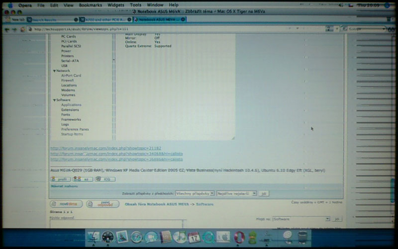

Guest DeleteACCOUNT Posted March 1, 2007 Share Posted March 1, 2007 Hello all, I have ATI Mobility X700 (Device ID: 5652) and Asus M6Va laptop. My steps: 1. Replacing ATI*.kexts, AppleIntegratedFramebuffer.kext, IONDRVSupport.kext and OpenGL.framework from original 10.4.5 Intel Update. 2. Koverg patch 0.2 (QE, CI working) 3. Koverg - Callisto - Framebuffer All-in-one sudo ./builddoe.sh 56 52sudo ./doe.sh cal5 0x0x0 1 1 #Callisto 5/no resolution into com.boot.apple.plist/Patched Koverg driver/CallistoFB on 4. Repair ATIRadeon9700.kext (because the second script add only 0x56 instead of 0x56521002) After restart I have full QE/CI support and I can set 1280x800 resoution, but the screen is flickering I think it is error with display frequency. Could somebody please help me? Many thanks and sorry for my English. Link to comment https://www.insanelymac.com/forum/topic/21182-how-to-x800-xl-set-up-with-working-display-manager-and-qeci/page/7/#findComment-314387 Share on other sites More sharing options...
