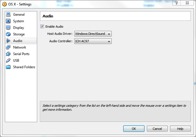

alakaboo Posted July 6, 2010 Share Posted July 6, 2010 Micahel, for the sound issue, have you tried the driver released by omegaX? details can be found here: http://www.takwing.idv.hk/tech/virtual/faq/sound_in_SL.html That's the one I've been working with. Like I said, it's detected and I can even access the it in the Sound pref pane, but I can't hear anything. PS - Thank you for your guide; it was a big help in getting started, although I had to do it without EmpireEFI. PPS - I changed my display name from my real name because I prefer to use my handle on the boards! Link to comment Share on other sites More sharing options...

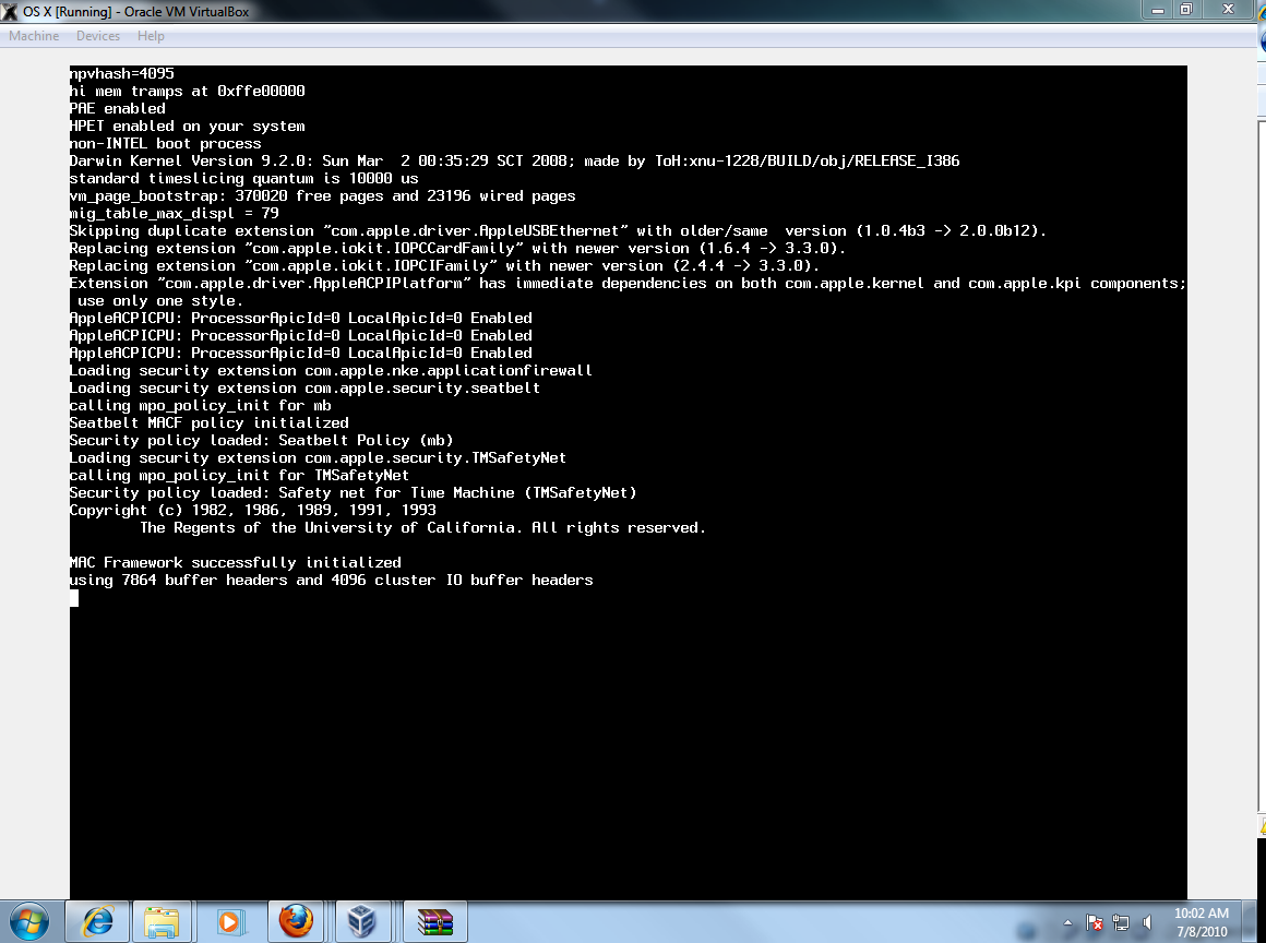

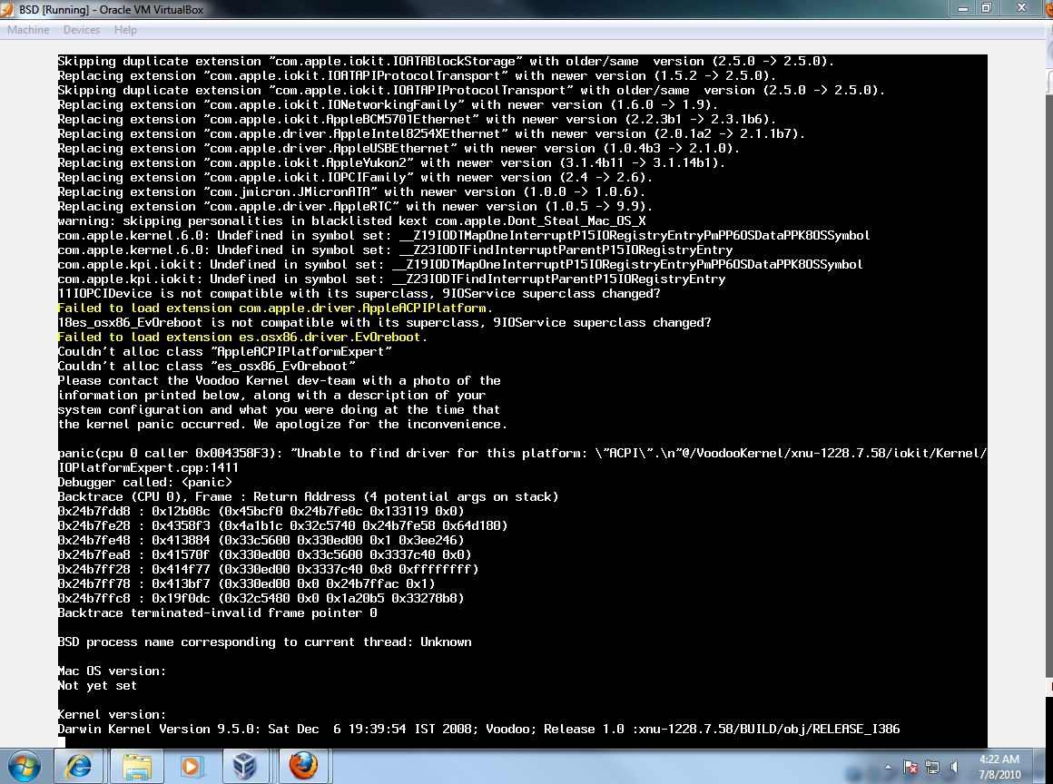

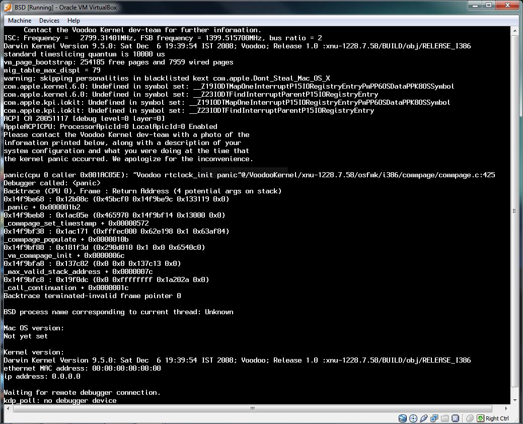

chuckbmx Posted July 6, 2010 Share Posted July 6, 2010 What is the best, latest and easiest OSx86 (iso) to install on a AMD Phenom II CPU computer with minimal number of errors? I tried to install iDeneb-10.5.7 as Guest OS within VirtualBox, however I get some errors from Voodoo kernel during installation. The system board is a Gigabyte GA-MA790GP-DS4H and the Core Speed is ( 801.7 MHz ), the Multiplier is ( x 4.0 ), the Bus Speed is ( 200.4 MHz ), the HT Link is ( 1803.8 MHz ). I am going to try the iDenebv1.6_1058_Lite_Edition to see if it does better. Link to comment Share on other sites More sharing options...
takwing Posted July 7, 2010 Share Posted July 7, 2010 What is the best, latest and easiest OSx86 (iso) to install on a AMD Phenom II CPU computer with minimal number of errors? I tried to install iDeneb-10.5.7 as Guest OS within VirtualBox, however I get some errors from Voodoo kernel during installation. The system board is a Gigabyte GA-MA790GP-DS4Hand the Core Speed is ( 801.7 MHz ), the Multiplier is ( x 4.0 ), the Bus Speed is ( 200.4 MHz ), the HT Link is ( 1803.8 MHz ). I am going to try the iDenebv1.6_1058_Lite_Edition to see if it does better. no matter which iso you use, you may still encounter problem .... especially you are using AMD CPU. For AMD CPU machine, besides the step-by-step installation guide that I have provided, there are 2 articles in the FAQ session on my page that you will find useful: - the legacy kernel - fixing the rtclock_init kernet panic Link to comment Share on other sites More sharing options...

chuckbmx Posted July 8, 2010 Share Posted July 8, 2010 TakWing, Thank you for your quick response. I looked at your info about the Legacy Kernel and also fixing the rtclock_init_ratio. I downloaded the Legacy Kernel, and it is a ( .pkg ) file. I don't know how to update to the Legacy Kernel per your instructions, because the Legacy Kernel is ( .pkg ) file, whereas in VirtualBox User Interface, it is looking for an ( .iso ) file to refer to, when after the EmpireEFI is loaded in. Also, I don't know how to update the iDenenb10.5.7( iso ) file of the com.apple.Boot.plist file, so that it is picked up when the iDenenb10.5.7( iso ) extracted set of files to the DVD in Drive(D). http://www.takwing.idv.hk/tech/virtual/faq...acy_kernel.html http://www.takwing.idv.hk/tech/virtual/faq..._bus_ratio.html I booted up either a OSx VM or BSD VM with EmpireEFI( Rel2 ), and then in VirtualBox screen, I selected the Devices to switch to Drive(D) to refer to the DVD for the iDenenb10.5.7 bootable DVD. The sequence of events are shown in the three screens shown below. The last screen shows different errors, instead of the clock errors. Why??? It seems, I am only a step or two from a successful OSx86 installation. If only I can bring up the OSx VM successfully with a good mach_kernel in it, then subsequently install the iDeneb ( OSx86 ) from the bootable DVD. I also came across information from Taranfx - How to Install Snow Leopard on VirtualBox, but it seems to be only for Intel CPU based computers, not for AMD CPU computers. http://www.taranfx.com/install-snow-leopard-virtualbox Link to comment Share on other sites More sharing options...
takwing Posted July 8, 2010 Share Posted July 8, 2010 TakWing, Thank you for your quick response. I looked at your info about the Legacy Kernel and also fixing the rtclock_init_ratio. I downloaded the Legacy Kernel, and it is a ( .pkg ) file. I don't know how to update to the Legacy Kernel per your instructions, because the Legacy Kernel is ( .pkg ) file, whereas in VirtualBox User Interface, it is looking for an ( .iso ) file to refer to, when after the EmpireEFI is loaded in. Also, I don't know how to update the iDenenb10.5.7( iso ) file of the com.apple.Boot.plist file, so that it is picked up when the iDenenb10.5.7( iso ) extracted set of files to the DVD in Drive(D). http://www.takwing.idv.hk/tech/virtual/faq...acy_kernel.html http://www.takwing.idv.hk/tech/virtual/faq..._bus_ratio.html I booted up either a OSx VM or BSD VM with EmpireEFI( Rel2 ), and then in VirtualBox screen, I selected the Devices to switch to Drive(D) to refer to the DVD for the iDenenb10.5.7 bootable DVD. The sequence of events are shown in the three screens shown below. The last screen shows different errors, instead of the clock errors. Why??? It seems, I am only a step or two from a successful OSx86 installation. If only I can bring up the OSx VM successfully with a good mach_kernel in it, then subsequently install the iDeneb ( OSx86 ) from the bootable DVD. I also came across information from Taranfx - How to Install Snow Leopard on VirtualBox, but it seems to be only for Intel CPU based computers, not for AMD CPU computers. http://www.taranfx.com/install-snow-leopard-virtualbox I haven't tried iDeneb before....and may be I should say that does not work on my machine at the time when I first play around installing Mac OS X on VB. but what I want to share is that for pkg file is the mac osx package file.... simply double-click it will kick off the installation. what you can do is: - download directly it directly from your mac VM. - or transfer it via network share - or burn that file onto a DVD, then access the DVD-drive from your VM. However, the above still require you to boot up your VM... I am not sure if you can boot up your VM with the Empire DVD / other boot loader or not.... any reason why you want to setup Leopard? You can try installating by using the retail DVD. Besides, I will presume you have read through my step-by-step guide, so that we can have a common ground to discuss about the installation. Installation of SL on VB should be similar for Intel and AMD machine... thoguh we need to apply the AMD specific 'patch' as I described. (Of course, there may be more that is not listed... I am not using AMD CPU... and that is the experience that I got from other AMD CPU user) Link to comment Share on other sites More sharing options...

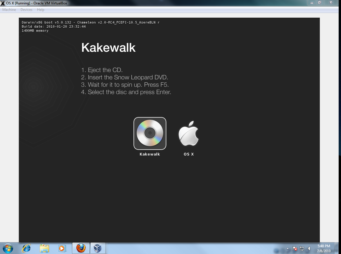

chuckbmx Posted July 8, 2010 Share Posted July 8, 2010 TakWing, You won't believe what I came across and made a bit more progress. That is, I came across the KakeWalk software( http://puru.se/blog/ ), and in it there is a KakeWalkLegacy.iso file. I made a bootable DVD from this and booted up the OSx VM. The iDeneb10.5.7 bootable DVD is inserted, then I press the F5 key and it locates it. Long and behold, the Apple Logo appears and it loads all of the files for the installation. However, after it is completed and when I reboot the OSx VM, the OSx VM doesn't load up the OSx all the way. It stops at what is shown in the screen below. I even tried to boot up in safe mode, same thing happens in the screen below. Link to comment Share on other sites More sharing options...

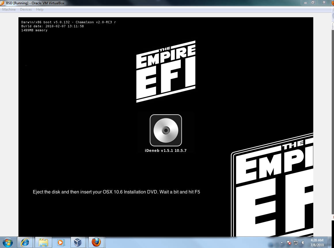

chuckbmx Posted July 10, 2010 Share Posted July 10, 2010 The OSx Tiger DVD is actually a Retail DVD. Tonight, I went to a local Apple store and purchased the Snow Leopard DVD for $29.00. Its contents( folders and files ) is quite different than the OSx Tiger and OSx Leopard. It has BootCamp setup and also a regular setup.exe file, and it looks like this DVD will do a remote installation of OSx Snow Leopard, unlike OSx Tiger and OSx Leopard. I would like to do an installation directly from the DVD that doesn't require to remotely install the files and vanilla kernel. Link to comment Share on other sites More sharing options...

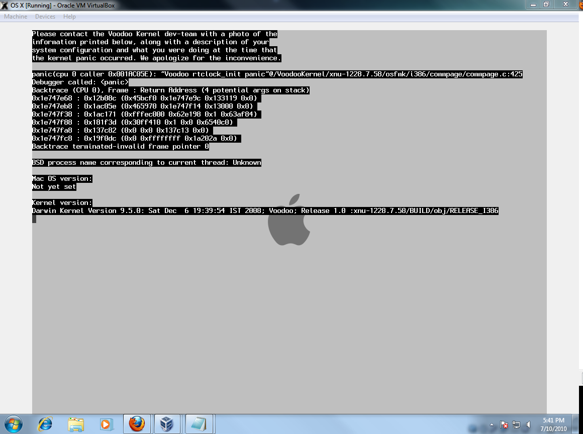

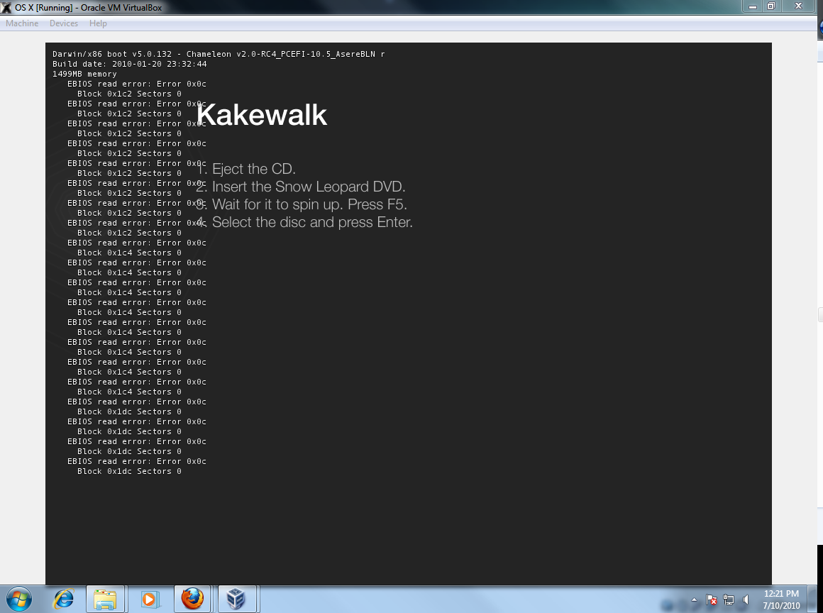

chuckbmx Posted July 10, 2010 Share Posted July 10, 2010 How do I boot either the Retail OSx Snow Leopard DVD or the OSx86 Snow Leopard DVD in VirtualBox? I get the errors message as shown in the following image for above both DVDs. How does the OSx files and OSx mach_kernel get updated as I don't see it on either DVDs? Link to comment Share on other sites More sharing options...
LeXa2 Posted July 10, 2010 Share Posted July 10, 2010 How do I boot either the Retail OSx Snow Leopard DVD or the OSx86 Snow Leopard DVD in VirtualBox? I get the errors message as shown in the following image for above both DVDs. How does the OSx files and OSx mach_kernel get updated as I don't see it on either DVDs? The screenshot you have posted makes me suspect that there are a big problems with reading DVD disk on your system. Keeping in mind this, would you please make the screenshots of all the VirtualBOX VM settings windows so takwing or me would be able to check if something is wrong with them. Upd. As for "not seen on the DVD" - there's no chance to see the real contents of the Mac OS X DVD under Windows as this DVDs are in the special format. It contains a partition with ISO9660 filesystem that is readable by Windows. This partition only contain bootcamp. There's another partition on this DVD formated in HFS+ that may only be read up from Mac OS X (and other OS that supports apple partition maps on the optical devices and have got HFS+ read support). From the questions you ask about how to update the kernel I can conclude that you had not read up takwing guide at all - all the required infos are in there. Don't be too lazy, find up some time and read at least the guide. The probability of success will raise dramatically if you would also read the last 15-20 pages of this thread instead of keep asking the questions that have been answered here dozen times before. Link to comment Share on other sites More sharing options...

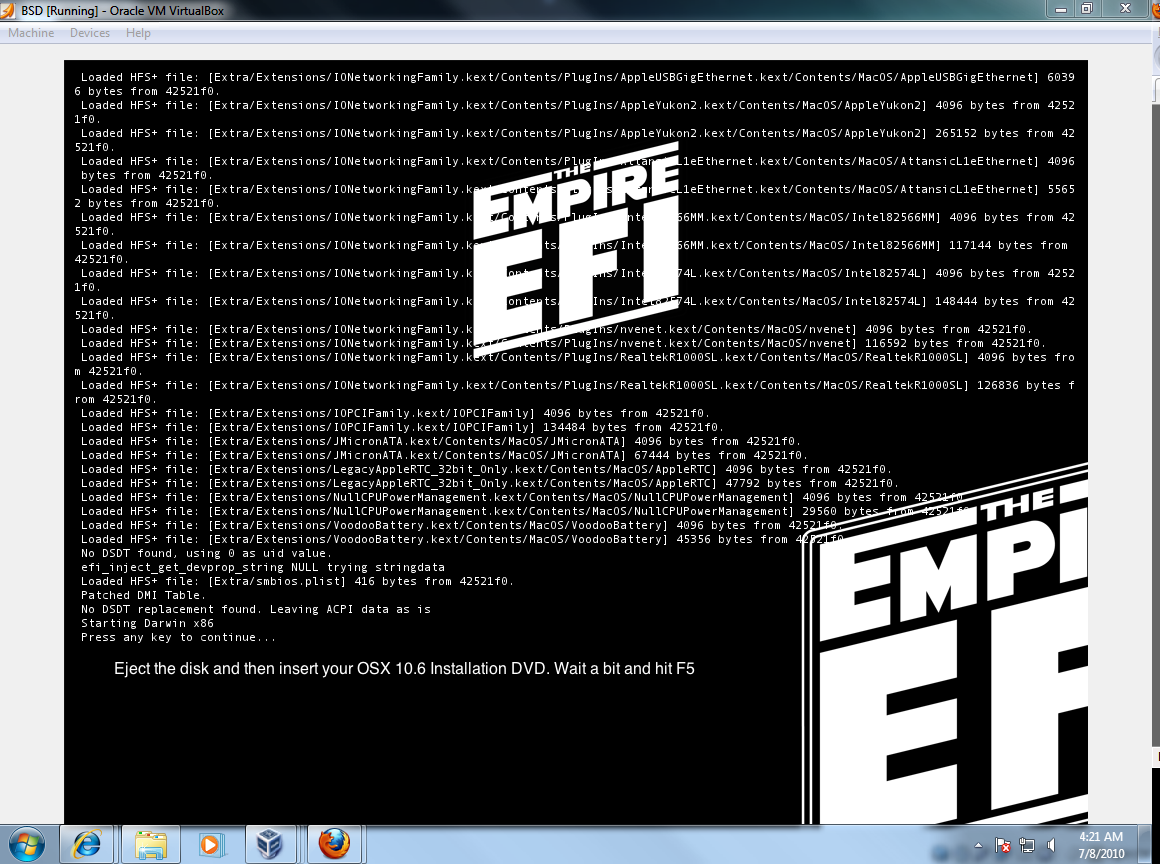

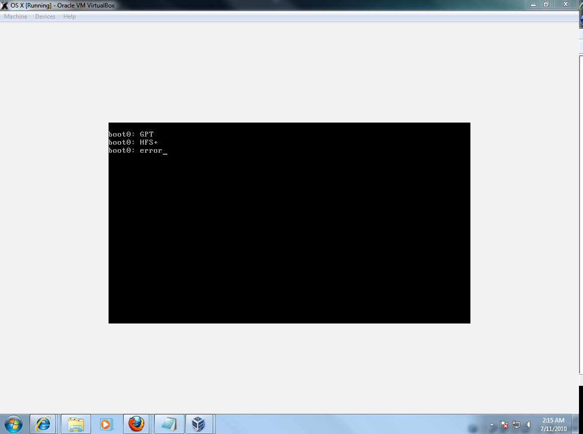

chuckbmx Posted July 10, 2010 Share Posted July 10, 2010 I could be wrong on this as I read somewhere, the reason for the EBIOS Read Error, was because maybe not having the latest version of EmpireEFI for AMD Phenom II computers. I tried both Kakewalk and EmpireEFI and I get the above mentioned EBIOS Read Errors. Anyway, here is the screen image of the OSx VM. Looking at the PC EFI screens, the latest version I have: (Kakewalk EFI Bootloader ) Darwin/x86 boot v5.0.132 - Chamleon v2.0-RC4_PCEFI-10.5_AsereBLN Build Date: 2010-01-20 23:23:44 When in the CD devices as I tried also to select a OSx86 (.iso) file from the computer harddrive, Kakewalk will not go read it after when pressing the F5 key --- Empire EFI bootloader will read the ( .iso ) file. ( Empire EFI Bootloader ) Darwin/x86 boot v5.0.132 - Chamelon v2.0-RC3 PCEFI-10.4 BoorCDMaker Build date: 2009-10-15 15:22:04 What I probably need and cannot fing it, is the EmpireEFI Bootloader that has Chamleon v2.0-RC4 as I think Chamleon v2.0-RC4 is the latest version. With the Empire EFI Chamelon v2.0-RC3, when I reboot the OSx VM to the Snow Leopard ( .iso ) by Hazard on the computer harddrive, it shows the kernel panic as shown in the screen below. If possible, please provide the web-link to the latest and the right bootloader for AMD Phenom II CPU computers. As you saw earlier, Kakewalk did read the DVD for iDeneb10.5.7 alright and install it alright, however after it rebooted, it hung up part way thru booting up the OSx VM. Link to comment Share on other sites More sharing options...
LeXa2 Posted July 10, 2010 Share Posted July 10, 2010 I could be wrong on this as I read somewhere, the reason for the EBIOS Read Error, was because maybe not having the latest version of EmpireEFI for AMD Phenom II computers. I also have got an AMD Phenom II X4 based workstation and I've been able to successfully boot into Mac OS X installation with the version of EmpireEFI named "Experimental for AMD Phenom ...." at the bottom of this page: http://prasys.co.cc/2010/01/empire-efi-v-1...-out/#more-2411 (this is EmpireEFI home). The errors you've got clearly state that there's a problem reading up disk sectors and thus it is not related to the "original kernel vs. AMD CPU" fight. What I probably need and cannot fing it, is the EmpireEFI Bootloader thathas Chamleon v2.0-RC4 as I think Chamleon v2.0-RC4 is the latest version. The version of the Chameleon bootloader doesn't matter much. The only thing Chameleon should do is not to hang while enumerating system devices available to boot and loading up kernel/kexts into the system memory. Errors you had posted on the last screenshot are coming from the kernel so it seems that Chameleon have done it's job right. With the Empire EFI Chamelon v2.0-RC3, when I reboot the OSx VM to the Snow Leopard ( .iso ) by Hazard on the computer harddrive, it shows the kernel panic as shown in the screen below. This panic is a famous one: it is caused by the bug in the community written patch that should autodetect the system bus speed of the AMD CPU based system (division by zero in kernel space = kernel panic). New versions of this patch have been modified to include "manual control" over this autotedection system. You should try to specify additional kernel boot parameter "busratio=XX" (in case of my CPU correct value for XX were 13), either by typing it manually in the Chameleon boot prompt (accessed by pressing TAB key) and by specifying it in the VBOX EFI internal value "VBoxInternal2/EfiBootArgs" (VBoxManage setextradata <VM name here> "VBoxInternal2/EfiBootArgs" "-v busratio=13"). Also, switching to a another version of EmpireEFI might help (you would locate a lot of them at the link I had posted above). As for screenshot of the VM settings - you had posted the "General Overview", but we need to see the exact details, just like they are shown on the screenshots in the takwing's guide. Link to comment Share on other sites More sharing options...

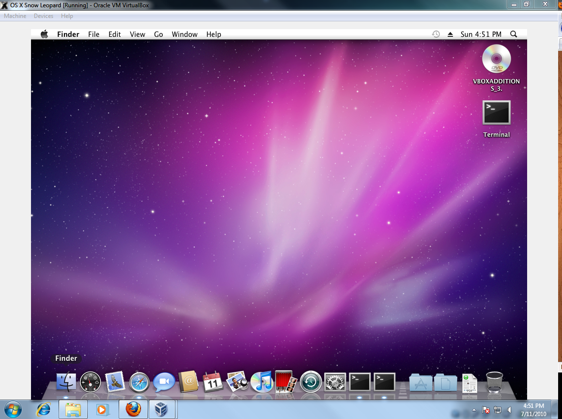

chuckbmx Posted July 11, 2010 Share Posted July 11, 2010 Here are some ExtraDataItem I placed in the machine file(xml) OS X.xml They all may not work, but I did specify busratio=14 as boot parm after when pressing the F8 key in the bootloader screen. ============================================================= <ExtraDataItem name="VBoxInternal2/Devices/0/1000e/Trusted" value="1"/> <ExtraDataItem name="VBoxInternal2/EfiBootArgs" value="on"/> <ExtraDataItem name="VBoxInternal2/EfiBootArgs/arch" value="i386"/> <ExtraDataItem name="VBoxInternal2/EfiBootArgs/busratio" value="14"/> <ExtraDataItem name="VBoxInternal2/EfiGopMode" value="2"/> <ExtraDataItem name="VBoxInternal2/SupportExtHwProfile" value="on"/> ============================================================= Shown below are the detailed OS X VM VirtualBox screen settings: ============================================================= I made an ( .iso ) file from the Retail Snow Leopard DVD( $29.00 ) I bought last night with the ImgBurn software. I specified EmpireEFI4AMD_SB600.iso as the bootloader and when the screen was displayed, I then went to VM Devices and selected the Retail Snow Leopard( .iso ) on the computer harddrive and was able to initiate an installation. The installation proceeded until about 10 minutes remaining, and then an error message displayed indicating cannot restart VM with the specified VM disk. All of the screens below shows the information for this installation. The very last screen shows what happens when the OS X VM is rebooted when I restart the OS X VM with VirtualBox UI. Link to comment Share on other sites More sharing options...
LeXa2 Posted July 11, 2010 Share Posted July 11, 2010 <ExtraDataItem name="VBoxInternal2/Devices/0/1000e/Trusted" value="1"/> <ExtraDataItem name="VBoxInternal2/SupportExtHwProfile" value="on"/> These are useless and are not needed. <ExtraDataItem name="VBoxInternal2/EfiBootArgs" value="on"/> <ExtraDataItem name="VBoxInternal2/EfiBootArgs/arch" value="i386"/> <ExtraDataItem name="VBoxInternal2/EfiBootArgs/busratio" value="14"/> These are wrong. It should look like this: <ExtraDataItem name="VBoxInternal2/EfiBootArgs" value="-v arch=i386 busratio=14" /> Take a note that it might be required to remove this setting prior to the installation stage of the Mac OS X and insert it back only after the moment your system would be installed and you'd be able to boot into it with EmpireEFI. <ExtraDataItem name="VBoxInternal2/EfiGopMode" value="2"/> This one is OK, it selects what video mode to use when booting using VBox EFI. Side note: all this settings are only applicable when VirtualBOX EFI is on. There's another thing you'll need in the VM xml: <ExtraDataItem name="VBoxInternal2/SmcDeviceKey" value="ourhardworkbythesewordsguardedpleasedontsteal(c)AppleComputerInc"/> Shown below are the detailed OS X VM VirtualBox screen settings:.....a lot of screenshots follow..... Almost everything seems to be OK except for network card type and a tiny amount of the video memory you provide to the VM. You should set network card emulated type to be "Intel Pro/1000 T Server". As for VRAM - set it to be 64Mb or 128Mb. Another important thing to note: it is absolutely MUST to enable "Passthrough" for the CD/DVD when mapping it to the real physical drive. Forgetting to do so will lead to the bootloader unable to correctly read up the kernel on boot. Also, you hadn't provided the screenshot for the System/Motherboard tab. I made an ( .iso ) file from the Retail Snow Leopard DVD( $29.00 ) I bought last nightwith the ImgBurn software. I specified EmpireEFI4AMD_SB600.iso as the bootloader and when the screen was displayed, I then went to VM Devices and selected the Retail Snow Leopard( .iso ) on the computer harddrive and was able to initiate an installation. Am I right in my proposal that you had pressed F5 button on the keyboard after the disk image change and EmpireEFI had successfully detected the newly inserted Mac OS X Install DVD? The installation proceeded until about 10 minutes remaining, and thenan error message displayed indicating cannot restart VM with the specified VM disk. All of the screens below shows the information for this installation. The very last screen shows what happens when the OS X VM is rebooted when I restart the OS X VM with VirtualBox UI. Your installation screenshots seems to be normal. Problems with the "Installation Failed" message displayed towards the end of the installation process are pretty common: Mac OS X bless tool that is used to set the boot order for the boot.efi Mac OS X bootloader is known to fail most of the times when run on the system without EFI support (booting using EmpireEFI means that you have VBOX EFI disabled => no EFI support). This "Installation Failed" message may be ignored. You should reboot the system after getting this message, boot into EmpireEFI once again, switch DVDs and boot into install DVD, proceed into the Disk Utility, select the volume you had installed Mac OS X on and issue "Check disk" command followed by "Repair disk" command. There still would be problems with bless tool but they may be ignored. After this reboot your system once more, again into EmpireEFI. Do not switch DVDs and do not press F5. It should display two systems available to boot: EmpireEFI disk itself and the newly installed Mac OS X. Select later one using arrow keys on your keyboard and press ENTER. With luck you should boot into the installed Mac OS X and finish the post-installation wizards. Next steps would be downloading and installing legacy_kernel package (latest one is for Mac OS X 10.6.4, I had posted a link to it some time ago in this thread), changing the bootloader settings to use legacy_kernel instead of mach_kernel and to include "arch=i386 busratio=14" in the kernel boot parameters (com.Apple.boot.plist file), installing NullCPUPowerManagement.kext (or removing AppleIntelCPUPowerManagement.kext), removing kext cache, shutting down the VM, enabling EFI in the VM settings and successfully booting it back up "loaded-n-ready". Link to comment Share on other sites More sharing options...

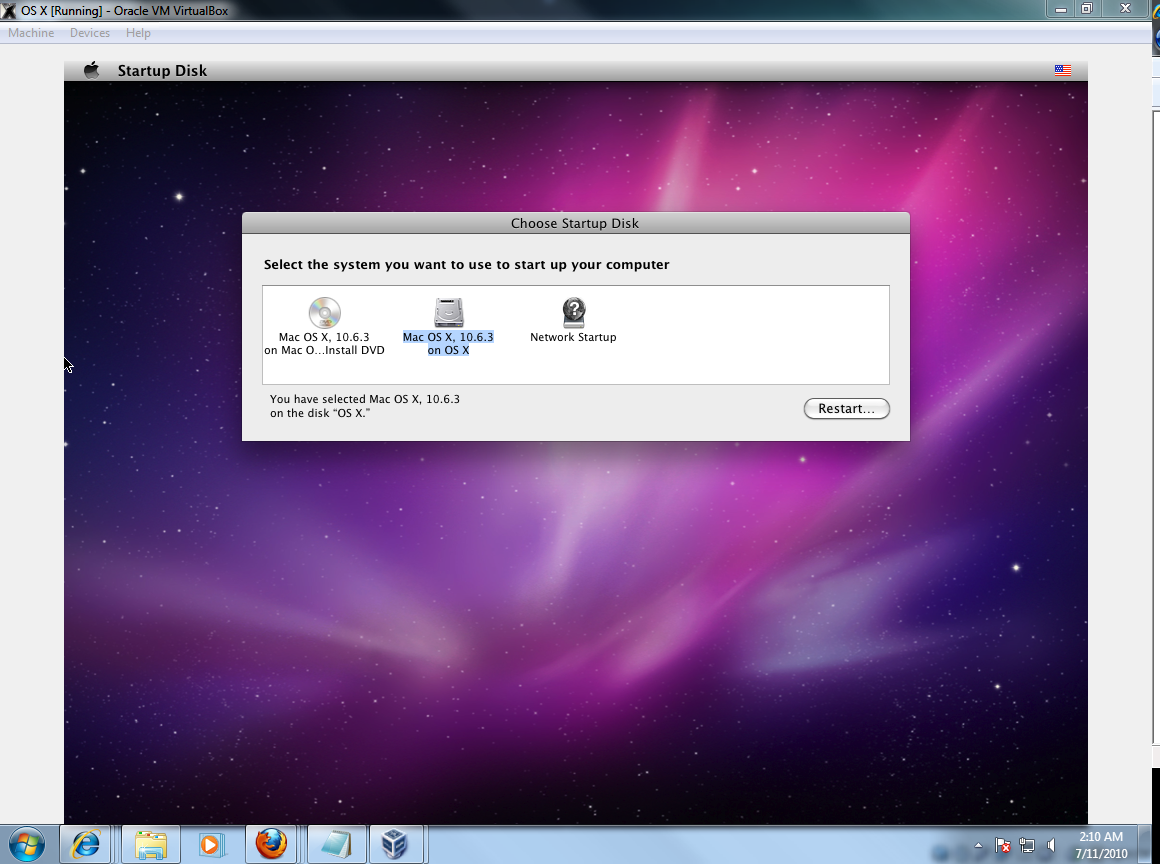

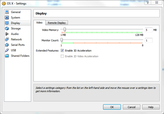

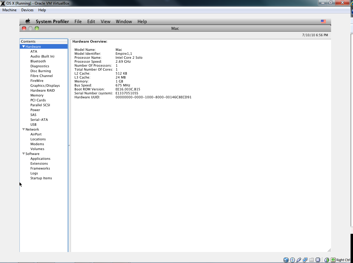

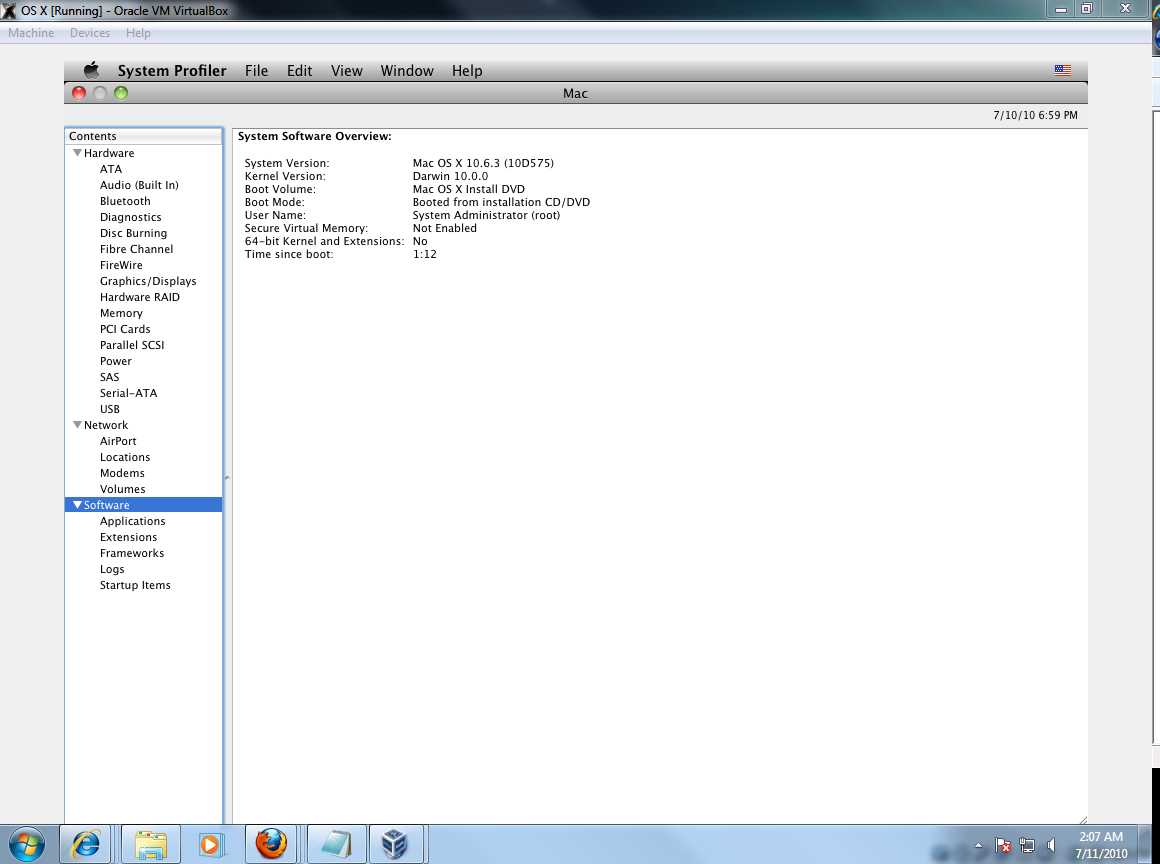

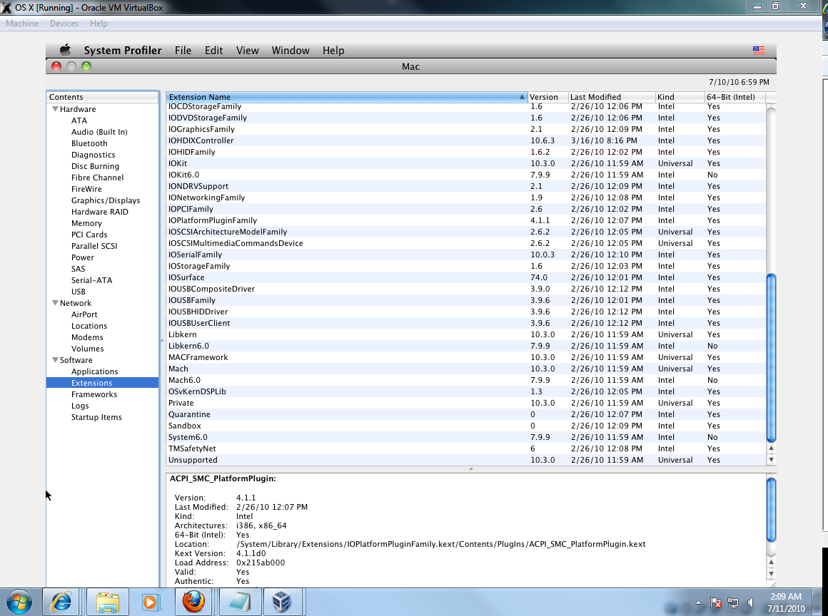

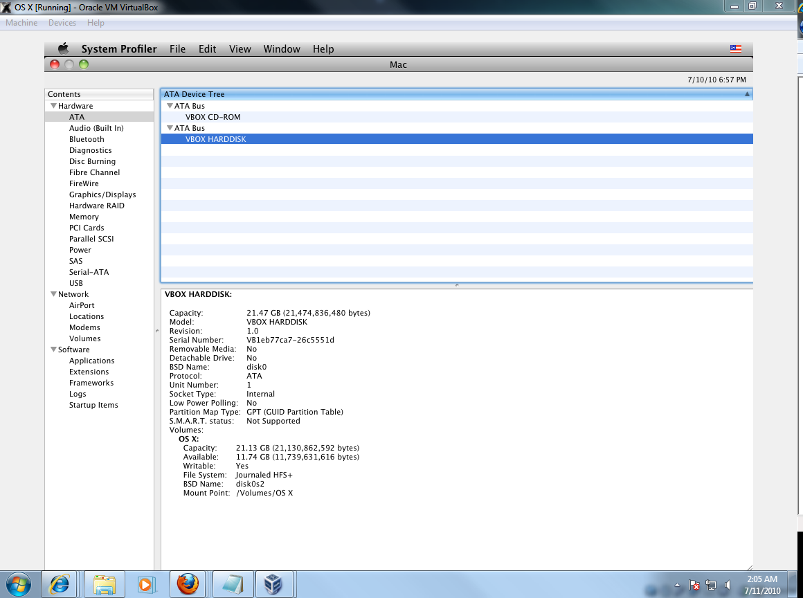

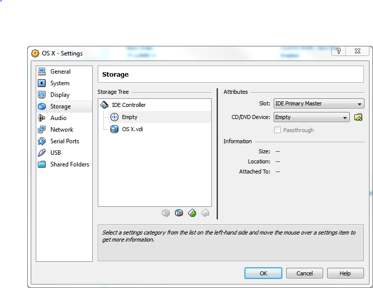

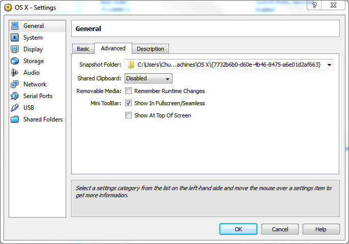

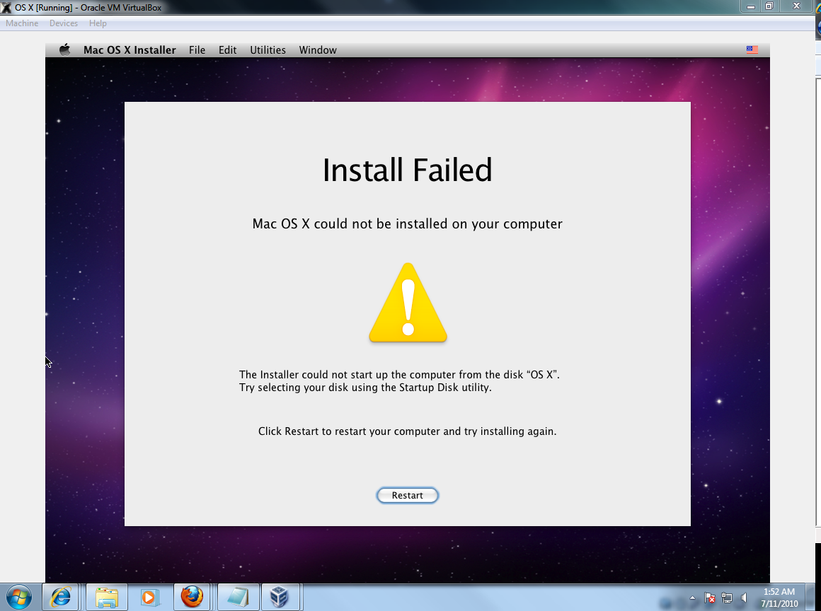

chuckbmx Posted July 11, 2010 Share Posted July 11, 2010 Shown below is the image screen for the System/Motherboard information from OS X VM. <ExtraDataItem name="VBoxInternal2/EfiBootArgs" value="-v arch=i386 busratio=14" I lefted the above statement in the OS X ( .xml ) file in the machines folder. I upgraded the VRam to 64MB. The only way the Passthru for the CD/DVD drive can be set, is by setting it in the OS X ( .xml ) file in the machines folder as follows in the StorageController section. <AttachedDevice passthrough="true" type="DVD" port="0" device="0"> Am I right in my proposal that you had pressed F5 button on the keyboard after the disk image change and EmpireEFI had successfully detected the newly inserted Mac OS X Install DVD? EmpireEFI did not detect the DVD properly, as I was getting the EBIOS Read Errors. I create an ( .iso ) of the Retail Snow Leopard DVD and EmpireEFI was able to boot from it. The only way that EmpireEFI4AMD_SB600 was able to read the REtail Snow Leopard DVD, was to modify the OS X ( .xml ) file in the machines folder as follows in the StorageController section. <AttachedDevice passthrough="true" type="DVD" port="0" device="0"> I rebooted the OS X VM with EmpireEFI and selected the OS X volume on the screen, and finished the post installation with the Verify Disk and Repair Disk on the volume from the Utlities Menu --- shown below are these post installation screens. I am able to boot up Snow Leopard VM everytime without any modifications, by having the EmpireEFI4AMD_SB600 ( .iso ) for CD/DVD, and then select the Mac OS X volume on the EmpireEFI screen to boot up Snow Leopard. I am not if I would want to update the mach_kernel with a legacy_kernel, as I am afraid and I don't know how to download this directly into the root( / ) folder-directory in the OS X VM volume. Plus, I don't know how to simply update-modify the com.Apple.boot.plist file with what Editor and also what folder-directory it is located in. Last of all, I cannot refer to a specific program to run in VBoxAdditions3.2.6, because there isn't a specific file/pgm/pkg to execute, so that the OS X VM screen takes up the whole screen space---current image is shown below. You will notice that there is some space surrounding the OS X VM screen within VirtualBox's main screen. Link to comment Share on other sites More sharing options...
