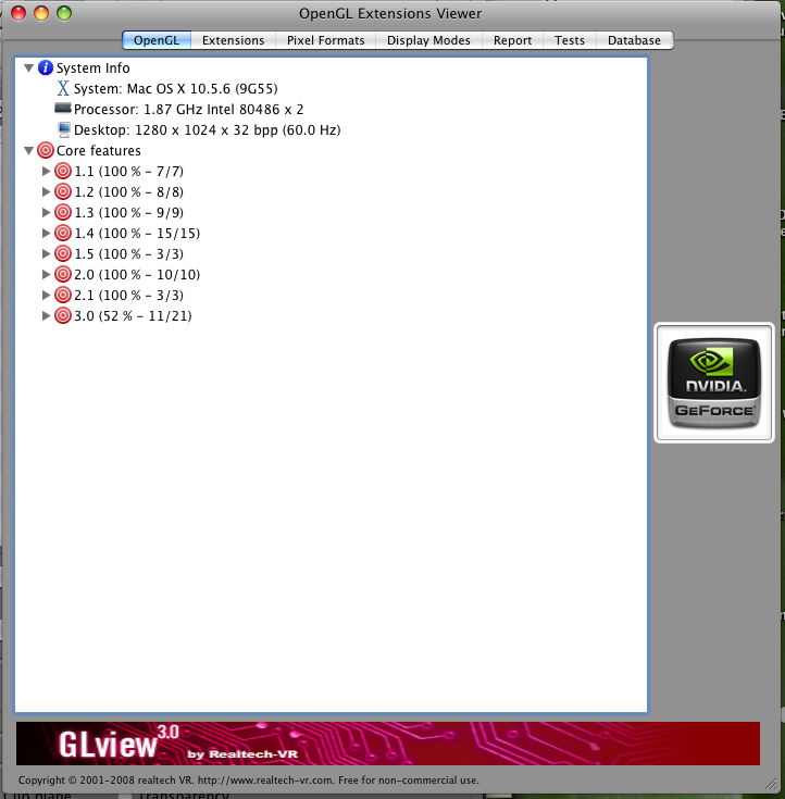

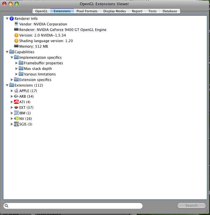

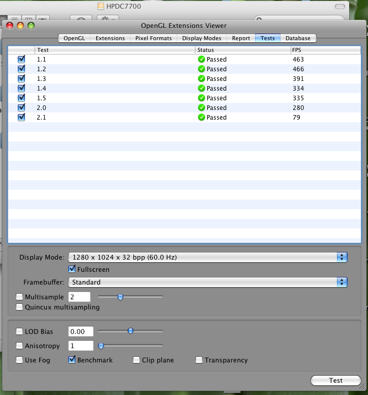

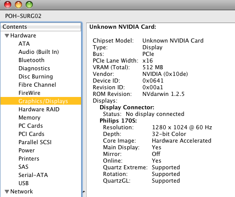

KennyW Posted February 26, 2009 Share Posted February 26, 2009 I have the same issue as whitepony. My inno3D 9400GT has exactly the same device id and NVCAP. Using the Kexts (v1.5.34) from tazs_10, it is still listed as Unknown NVIDIA card but apparent all functions are supported. I did the XBench test and check in OpenGL Extensions Viewer and it seems everything is working. inno3D_9400GT.txt Please see attached screen capture. Link to comment https://www.insanelymac.com/forum/topic/206168-drivers-for-nvidia-geforce-9400-gt-success/page/4/#findComment-1091792 Share on other sites More sharing options...
whitepony Posted February 26, 2009 Share Posted February 26, 2009 Tazs - They worked!! Thanks heaps... I get the same 'Unknown NVIDIA Card' as KennyW but QE works which means Logic still works! Would an EFI string fix the Unknown Card? Thanks again! 9400GT.tiff Link to comment https://www.insanelymac.com/forum/topic/206168-drivers-for-nvidia-geforce-9400-gt-success/page/4/#findComment-1091832 Share on other sites More sharing options...

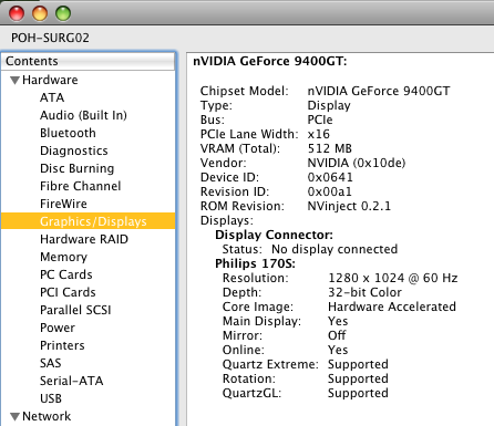

KennyW Posted February 26, 2009 Share Posted February 26, 2009 I find that replacing the NVDarwin.kext with NVinject.kext gives the same performance but correct identification by System Profiler. For your per use. NVinject.zip If it doesn't work, swapping Display-A with Display-B and vice versa in the info.plist of NVinject may do the trick. Link to comment https://www.insanelymac.com/forum/topic/206168-drivers-for-nvidia-geforce-9400-gt-success/page/4/#findComment-1092006 Share on other sites More sharing options...
