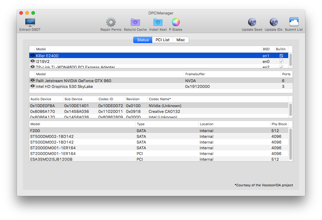

iStigPL Posted December 11, 2015 Share Posted December 11, 2015 Sorry, not ok here it was wrong versions of the file. I checked once again and it is ok now. I also dis test and here it is: 2 Link to comment https://www.insanelymac.com/forum/topic/205771-appleintele1000ekext-for-108107106105/page/30/#findComment-2195953 Share on other sites More sharing options...
Andres ZeroCross Posted December 12, 2015 Share Posted December 12, 2015 it was wrong versions of the file. I checked once again and it is ok now. I also dis test and here it is: How can you activate Intel HD 530?? Can you give me a clue? Link to comment https://www.insanelymac.com/forum/topic/205771-appleintele1000ekext-for-108107106105/page/30/#findComment-2196407 Share on other sites More sharing options...
iStigPL Posted December 12, 2015 Share Posted December 12, 2015 How can you activate Intel HD 530?? Can you give me a clue? Clover Inject Intel True and <key>ig-platform-id</key> <string>0x19120000</string> but it is so buggy (artifacts) you won't use it :-) Link to comment https://www.insanelymac.com/forum/topic/205771-appleintele1000ekext-for-108107106105/page/30/#findComment-2196462 Share on other sites More sharing options...
