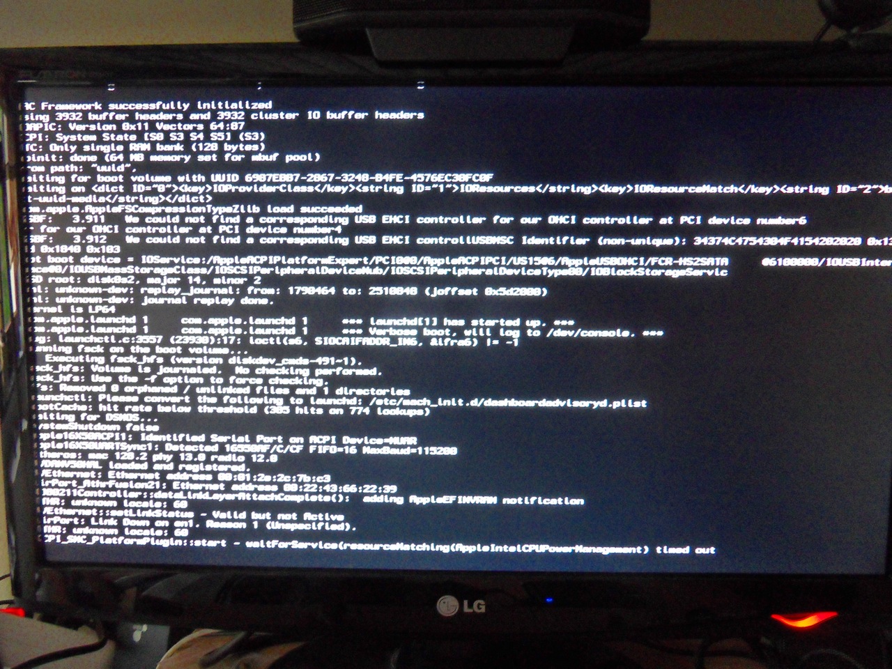

David Gerhardt Posted August 16, 2010 Share Posted August 16, 2010 The Kernel Panic: This is the picture, at the moment: Link to comment https://www.insanelymac.com/forum/topic/197516-full-solution-for-zotac-ionitx-atom-330-for-106x-sl/page/9/#findComment-1531362 Share on other sites More sharing options...

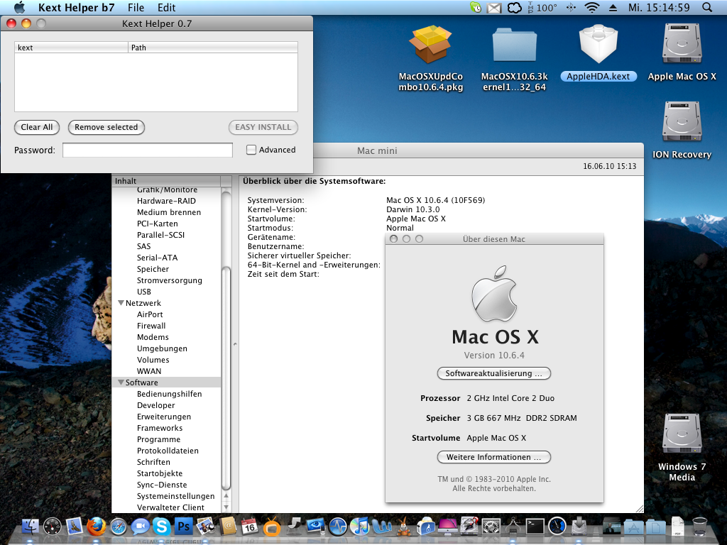

Methanoid Posted August 18, 2010 Share Posted August 18, 2010 Update to 10.6.4 .....almost without issues. And this is all you need....: Mac OS X 10.6.4 Combo MacOSX10.6.3kernel10.3.0_atom32_64.zip this ist the pached 10.3.0 Atom 64 bit kernel from Dreamwatcher AppleHDA.kext.zip modified from shoarting with kexthelper into S/L/E Two Partitions with Mac OS X on your computer to install from one partition to the other. Good luck ! 10.4 kernel patched by Teateam - http://www.insanelymac.com/forum/index.php...197020&st=0 Just waiting for my mobo to arrive to build my Ion Mac Link to comment https://www.insanelymac.com/forum/topic/197516-full-solution-for-zotac-ionitx-atom-330-for-106x-sl/page/9/#findComment-1532498 Share on other sites More sharing options...
