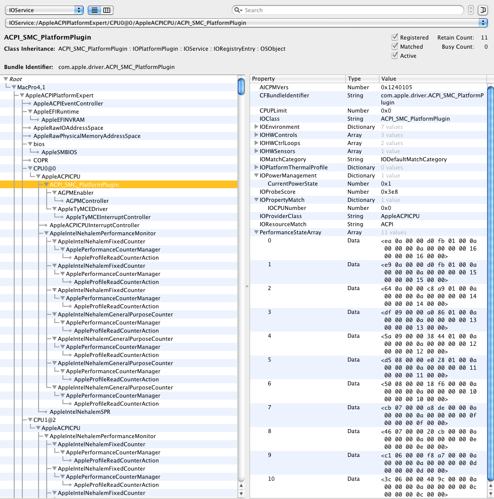

CSTInfo has been renamed to AICPMVers in ioreg at IOService:/AppleACPIPlatformExpert/CPU0@0/AppleACPICPU/ACPI_SMC_PlatformPlugin as of 10.6.8.
As for the missing turbo multipliers seen in kernel.log, looking in ioreg at IOService:/AppleACPIPlatformExpert/CPU0@0/AppleACPICPU/ACPI_SMC_PlatformPlugin I still see 10 values in the PState's PerformanceStateArray, so the message may be only cosmetic and not functional.

I'm also seeing the same values in ACPI_SMC_PlatformPlugin, can't yet understand why temps are higher, very puzzling.

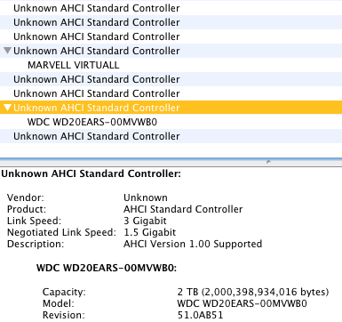

On a separate note i saw a while back you stated that you have an External @ Gsata port which works but have you noticed this? or can you check to see if it happens to you plz......
I have a WD 2TB in an External enclosure (Rosewill RX385 V2) connected at the back panel (USB/Esata) combo port via Sata connection.The drive shows up as Internal an i can Mount/Unmount it without problems......
The issue is that if i unmount then Power off the External case,then power it back on,after it mounts under system profiler it changes from

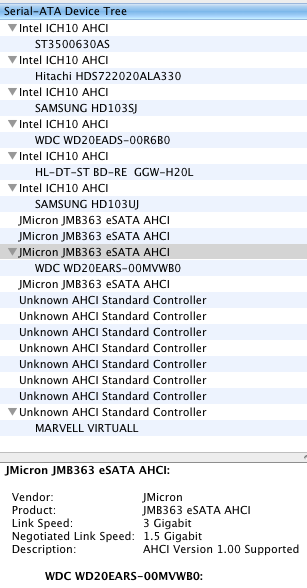

JMicron JMB363 AHCI:
Vendor: JMicron
Product: JMB363 AHCI
Link Speed: 3 Gigabit
Negotiated Link Speed: 3 Gigabit
Description: AHCI Version 1.00 Supported
TO
Vendor: JMicron
Negotiated Link Speed: 1.5 Gigabit

My ESATA connection via back panel combo connector reports the negotiated speed at 1.5 Gigabits. I'm not running with the JMicron kext so don't know if that's an issue here. Will report back after updating the motherboard BIOS.

Tried the eSATA and it was still showing Unknown AHCI Standard Controller at 1.5 Gigabit negotiated speed.

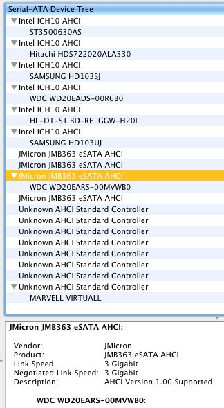

Installed the JMicron 36xx package and it now shows thus:
But a hot swap has the same effect on my machine as on yours and the negotiated link falls back to 1.5 Gigabits. Very strange.

Hello Rankrotten and Dajjal,
In my experience trying to get hot swap to work, I would get 3.0 Gigabit negotiated speed only if the drive was mounted at startup. Any drive the was mounted or remounted at a later point would connect at 1.5 Gigabit. This drove me crazy so I stopped using it. I was however able to get true hotswap (except for the full speed part) using this thread and JMB36X chipset.
I inserted this code at the end of Device (PEX0)
                Device (EATA)
                   Name (_ADR, Zero)
                   OperationRegion (BAR0, PCI_Config, 0x40, 0x04)
                   Field (BAR0, WordAcc, NoLock, Preserve)
                           Offset (0x00),
                       M1, 8,
                           Offset (0x01),
                       M2, 8,
                           Offset (0x02),
                       M3, 8
                       Store (0xb3, M1)
                       Store (0xa1, M2)
                       Store (0xc2, M3)
                       Return (0x00)
               Device (EPTA)
                   Name (_ADR, One)
                           Offset (0x00),
                       M1, 8,
                           Offset (0x01),
                       M2, 8,
                           Offset (0x02),
                       M3, 8
                       Store (Zero, M1)
                       Store (Zero, M2)
                       Store (Zero, M3)
                       Return (Zero)
Unfortunately, I can't remember if I was using a PCIe card with a Jmicron chip or the onboard chip. The above code will work with either, it's just a matter of inserting it into to the proper location/address space within the DSDT.

Hi FUT1L1TY
Tried your DSDT edits but it changed my main SATA ports from ICH10 to ESB2 AHCI which is not correct for my board. It's probably only cosmetic as the data transfer rate was the same as before.
Hotswap was never a problem for the eSATA on my machine and it still works fine.
Thanks for the info and I'll have a further look at the edits.

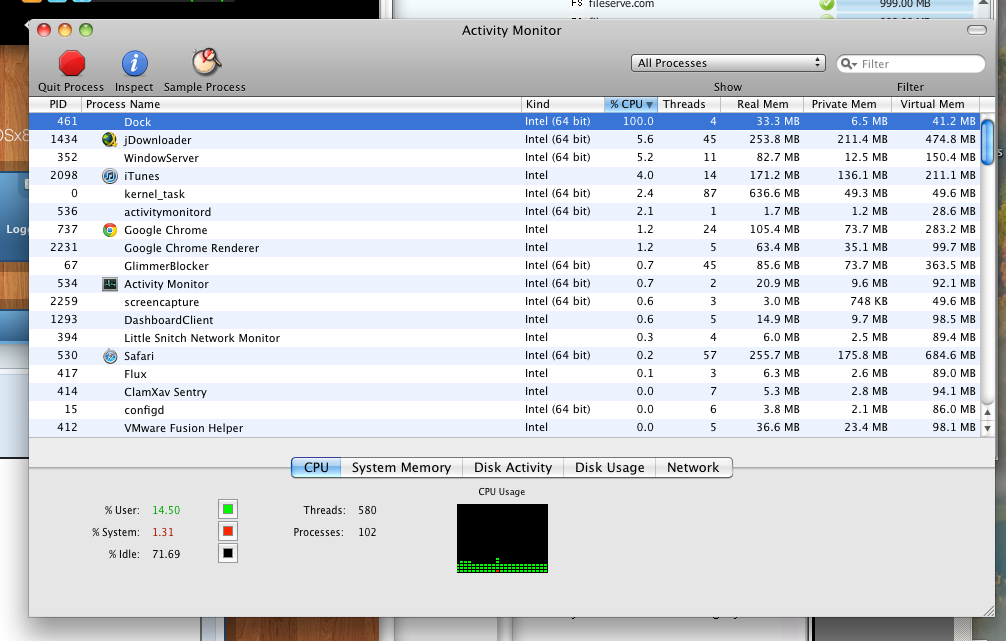

After upgrading to 10.6.8, now I noticed in Activity Monitor the Dock process hovers around 100% of CPU.
Anyone has the same issue?
Any pointers for me on what to check?
Hi FUT1L1TY
Please read my edit to my original post.

I have attached my dsdt but this has been edited to allow for native power management.
ex58-ud5 rev.1
Thanks in advance
DSDT.aml.zip
James-Littlers-Mac:~ James$ ioreg -lw0 | grep PerformanceStateArray
| |   | |   "PerformanceStateArray" = (<e90a0000d0fb01000a0000000a0000000015000000150000>,<640a0000d0fb01000a0000000a0000000014000000140000>,<df090000c8a901000a0000000a0000000013000000130000>,<5a090000a08601000a0000000a0000000012000000120000>,<d5080000384401000a0000000a0000000011000000110000>,<50080000e02801000a0000000a0000000010000000100000>,<cb07000018f600000a0000000a000000000f0000000f0000>,<46070000a8de00000a0000000a000000000e0000000e0000>,<c106000098b700000a0000000a000000000d0000000d0000>,<3c060000f8a700000a0000000a000000000c0000000c0000>)
James-Littlers-Mac:~ James$ ioreg -lw0 | grep CSTInfo
Does this mean C states are not working?
