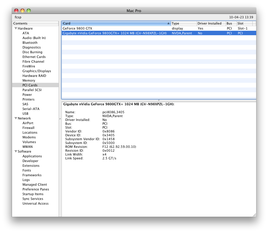

Hello Gentlemen,
I have a question for you: if you managed to put in DSDT graphics section?
For me everything works correctly if I GraphicsEnabler = Yes in com.apple.boot.plist.
I tried to add to this section DSDT (GraphicsEnabler turned off in com.apple.boot.plist = No):
Device (GFX)
Name (_ADR, Zero)
Name (_SUN, One)
Store (Package (0x16)
"@0,compatible",
Buffer (0x0B)
"NVDA,NVMac"
"@0,device_type",
Buffer (0x08)
"display"
"@0,name",
Buffer (0x0F)
"NVDA,Display-A"
"@1,compatible",
Buffer (0x0B)
"NVDA,NVMac"
"@1,device_type",
Buffer (0x08)
"display"
"@1,name",
Buffer (0x0F)
"NVDA,Display-B"
"NVCAP",
Buffer (0x18)
/* 0000 */    0x04, 0x00, 0x00, 0x00, 0x00, 0x00, 0x03, 0x00,
/* 0008 */    0x1C, 0x00, 0x00, 0x00, 0x00, 0x00, 0x00, 0x0A,
/* 0010 */    0x00, 0x00, 0x00, 0x00
"VRAM,totalsize",
Buffer (0x04)
0x00, 0x00, 0x00, 0x40
"device_type",
Buffer (0x0C)
"NVDA,Parent"
"model",
Buffer ()
"Gigabyte nVidia GeForce 9800GTX+ 1024 MB (GV-N98XPZL-1GH)"
"rom-revision",
Buffer ()
"F12 (62.92.59.00.10)"
}, Local0)
Return (Local0)
The whole in PCI0 section:
Device (PCI0)
Name (_HID, EisaId ("PNP0A03"))
Name (_ADR, 0x00)
Name (_UID, 0x01)
Name (_BBN, 0x00)
Device (GFX)
Name (_ADR, Zero)
but after a reboot, the graphics are not working ....
I came back from GraphicsEnabler = Yes in com.apple.boot.plist but not deleting the section of the DSDT and this is what I received in IORegistryExplorer:
DSDT injection: post-315211-1272025549_thumb.png
GraphicsEnabler: post-315211-1272025559_thumb.png
in SystemProfiler / PCI Cards:
Question: How can I add this section to the DSDT if I do not have (I can not find) in the DSDT pci-bridge device no matter which 1,2,3 ....
Attached is also my DSDT, has anyone of you have any ideas?
dsdt.txt
P.S. Sorry for my bad English...:(
Hello Gentlemen,
dsdt.txt

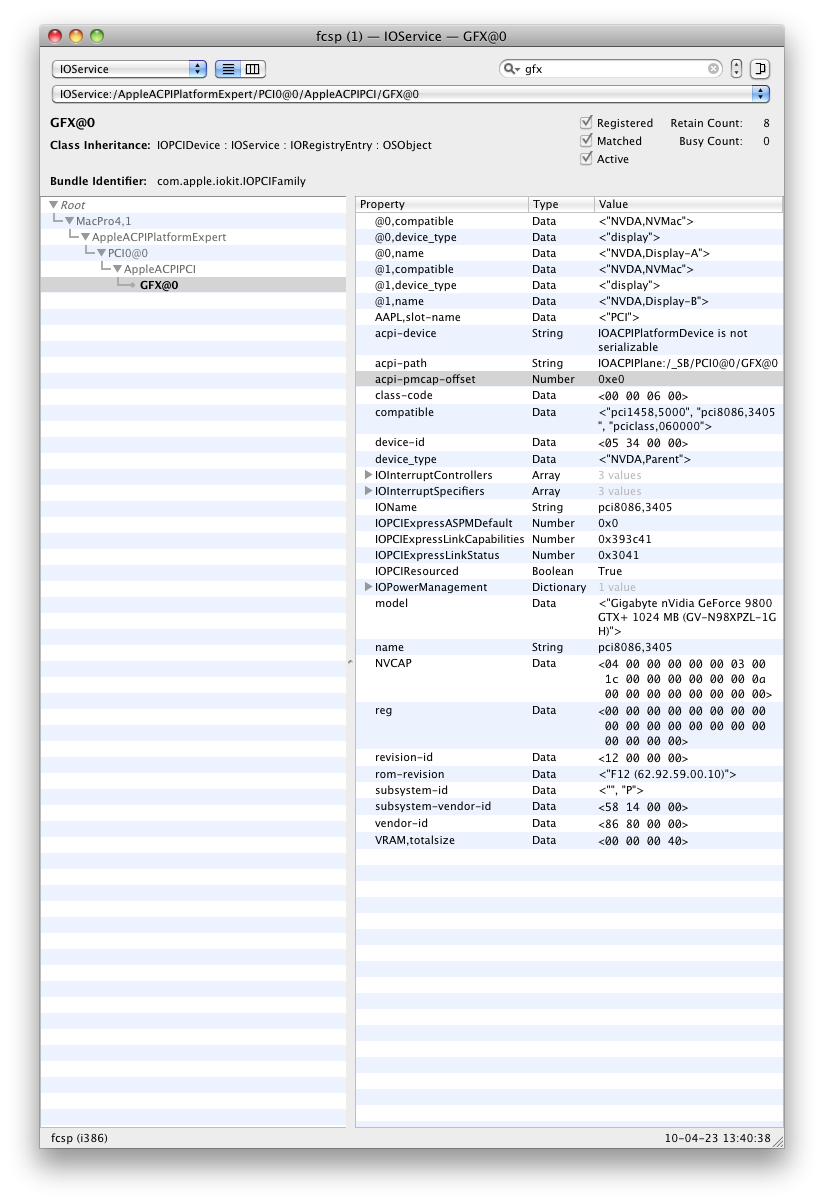

Try by changing the UID in Device PCI0 from 1 to 0. I had to do that too to get the graphics-enabler working.
Device (PCI0)
Name (_ADR, 0x00)
Name (_UID, 0x01) <----- change it to 0x00
Name (_BBN, 0x00)
Device (GFX)
Name (_ADR, Zero)
BiTRiP
Device (PCI0)
Name (_ADR, 0x00)
Name (_BBN, 0x00)
Device (GFX)
Name (_ADR, Zero)
BiTRiP

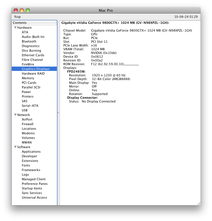

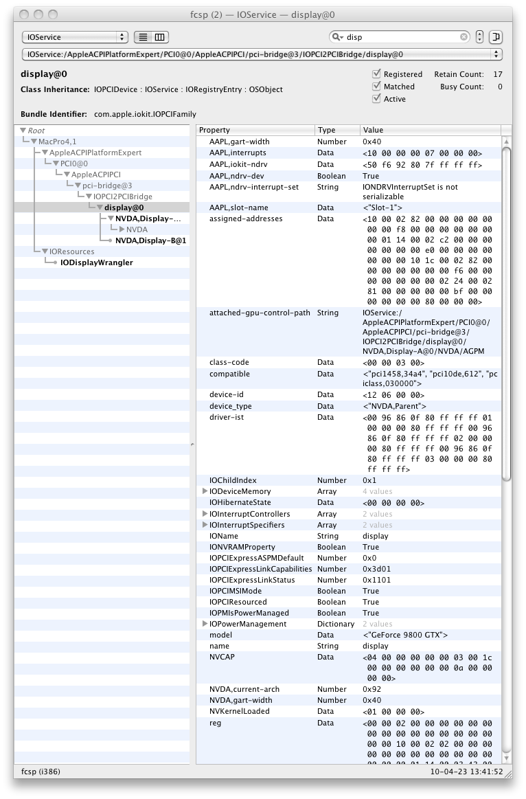

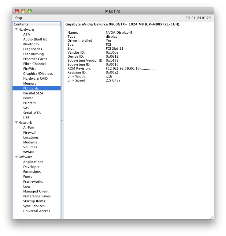

BiTRiP thanks for the tip but unfortunately after the revision of DSDT nad reboot graphic doesn't work... :P (only one resolution)
-------Edited-----------
add to not litter
added to the EFI String com.apple.coot.plist but unfortunately it also does not work. I have no idea what could be the cause. For Leopard and EFI String or DSDT Injection, everything worked smoothly ...

My PCI0 section looks like this:
Device (PCI0)
           Name (_HID, EisaId ("PNP0A08"))
           Name (_CID, EisaId ("PNP0A03"))
           Name (_ADR, 0x00)
           Name (_UID, 0x00)
           Name (_BBN, 0x00)
           Method (_S3D, 0, NotSerialized)
               If (LEqual (OSFL, 0x02))
                   Return (0x02)
               Else
                   Return (0x03)
           Device (PEG1)
               Name (_ADR, 0x00030000)
               Device (GFX0)
                   Name (_ADR, Zero)
                   Name (_SUN, 0x0B)
                       Store (Package (0x1A)
                               "@0,compatible",
                               Buffer (0x0B)
                                   "NVDA,NVMac"
                               "@0,device_type",
                               Buffer (0x08)
                                   "display"
                               "@0,display_cfg",
                               Buffer (0x08)
                                   0x03, 0x01, 0x00, 0x00
                               "@0,name",
                               Buffer (0x0F)
                                   "NVDA,Display-A"
                               "@1,compatible",
                               Buffer (0x0B)
                                   "NVDA,NVMac"
                               "@1,device_type",
                               Buffer (0x08)
                                   "display"
                               "@1,display_cfg",
                               Buffer (0x08)
                                   0xFF, 0xFF, 0x00, 0x01
                               "@1,name",
                               Buffer (0x0F)
                                   "NVDA,Display-B"
                               "NVCAP",
                               Buffer (0x14)
                                   /* 0008 */    0x0C, 0x00, 0x00, 0x00, 0x00, 0x00, 0x00, 0x07,
                               "VRAM,totalsize",
                               Buffer (0x04)
                               "device_type",
                               Buffer (0x0D)
                                   "NVDA,GeForce"
                               "model",
                               Buffer (0x0D)
                               "rom-revision",
                               Buffer (0x24)
                           }, Local0)
                       Return (Local0)
           Method (_STA, 0, NotSerialized)
It works! But one question SystemProfiler values are given incorrectly ROM Revision with commas and Slot11 .... What could be the cause?
Morganpl that is all only cosmetic
1. the slot number can simply be changed by changing value for SUN (Slot Unit Number)
change line Name (_SUN, 0x0B) to Name (_SUN, ONE) for slot 1
or to Name (_SUN, 0x03) for slot 3
2. if you add signs to rom revision or model the buffer value is incorrect . Let the compiler calculate it for you - just delete the value in the example 0x0D and leave the brackets. After recompiling the compiler sets the correct buffer value
"model",
change Buffer (0x0D) to Buffer ()
do the same with rom revision
