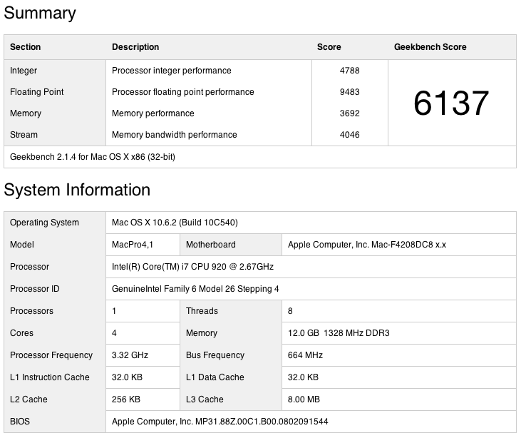

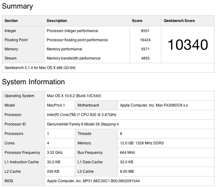

FUT1L1TY Posted March 9, 2010 Share Posted March 9, 2010 I just stumbled across something strange. I wonder if anyone has noticed this as well. I just installed Apple Mac Pro Audio Update 1.0 so I knew that I need to update the MacPro4_1.plist inside of IOPlatformPluginFamily.kext with the section from MacPro3_1.plist. Anyway, I did that without any noticeable problems. I then ran the 32-bit version of Geekbench and got a score of 6137. I didn't believe it so I rebooted and ran it again. No change. I ran it several more times with no significant change. I then restored the MacPro4_1.plist to its original form. Ran Geekbench again and got a score of 10340 which is my usual score. I've attached my screenshots of my results as well. I hope this information is of use to someone. Thanks again for all your help. Link to comment https://www.insanelymac.com/forum/topic/196771-ga-ex58-and-ga-x58a-dsdt-native-power-management-modifications/page/22/#findComment-1426219 Share on other sites More sharing options...

FUT1L1TY Posted March 10, 2010 Share Posted March 10, 2010 I doubt that identifying your system differently could physically effect your hardware. Perhaps I wasn't clear. I did not misidentify my machine. I modified my MacPro4_1.plist as per d00ds instructions on page 1. It had a substantial effect on my performance. Why? I'm not sure. As a result, I'm using the vanilla version of IOPlatformPluginFamily that gets installed with Mac Pro Audio Update. I guess what I'm trying to say is that maybe we don't need that MacPro4_1.plist mod after installing that update. It's possible that people have updated and didn't realize that kext got changed in the first place. Link to comment https://www.insanelymac.com/forum/topic/196771-ga-ex58-and-ga-x58a-dsdt-native-power-management-modifications/page/22/#findComment-1426331 Share on other sites More sharing options...
MowgliBook Posted March 10, 2010 Share Posted March 10, 2010 If you had repaired authorisations and flush caches (extention.mkext) you would not have had that problem. ` The MacPro4_1.plist is edited to enjoy full speedstep with variable speed and works perfectly, you had that performance issue because you didn't install it properly. Replace the vanilla plist, Repair authorisations, clean caches and make sure a new mkext is created, then restart. Link to comment https://www.insanelymac.com/forum/topic/196771-ga-ex58-and-ga-x58a-dsdt-native-power-management-modifications/page/22/#findComment-1426607 Share on other sites More sharing options...

FUT1L1TY Posted March 11, 2010 Share Posted March 11, 2010 If you had repaired authorisations and flush caches (extention.mkext) you would not have had that problem. `The MacPro4_1.plist is edited to enjoy full speedstep with variable speed and works perfectly, you had that performance issue because you didn't install it properly. Replace the vanilla plist, Repair authorisations, clean caches and make sure a new mkext is created, then restart. Actually, I never replaced the kext. I simply edited the the plist in place using vi logged in as root. The permissions never were changed. The kext never left /S/L/E. When I was done, I ran "touch /System/Library/Extensions". After I noticed the problem, I reverted the kext using the same method above. The kext never moved. If I had messed up permissions, I would still be experiencing the problem. With that said, it's possible that I made mistake. Who knows. Anything is possible. What I would like to know is there anyone who has installed the Mac Pro Audio Update? If so then they are mostly likely running the vanilla version of IOPlatformPluginFamily.kext. Link to comment https://www.insanelymac.com/forum/topic/196771-ga-ex58-and-ga-x58a-dsdt-native-power-management-modifications/page/22/#findComment-1426858 Share on other sites More sharing options...

FUT1L1TY Posted March 12, 2010 Share Posted March 12, 2010 I did install it, and I re-edited my plist after. Everything's fine, and I have variable speedsI'm convinced that your problem comes from the kext caches... Thanks. I tried it again. It was in fact a bad edit and not permissions. It's now working. Sorry to report a false positive. On a non-related note (for everyone on the list), did you know WOL (wake-on-lan) can be used to start your computer from a powered off state? Well, it can. Up until now I've only used WOL to wake from sleep. This is way cooler! Link to comment https://www.insanelymac.com/forum/topic/196771-ga-ex58-and-ga-x58a-dsdt-native-power-management-modifications/page/22/#findComment-1427503 Share on other sites More sharing options...
