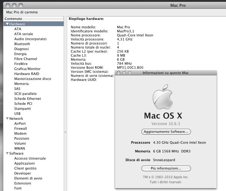

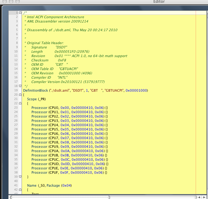

magnifico Posted May 19, 2010 Share Posted May 19, 2010 @ d00d Help Please..I've a Gigabyte UD7 X58A and Intel xeon 3540 overclocked at 4,5GHz..why my sistem profiler is read 4,3GHz? And my DSDT read 16 core? Thanks..sorry for my bad english. Please...but my DSDT is written badly? DSDT.aml.zip com.apple.Boot.plist.zip Link to comment https://www.insanelymac.com/forum/topic/196771-ga-ex58-and-ga-x58a-dsdt-native-power-management-modifications/page/29/#findComment-1471782 Share on other sites More sharing options...

magnifico Posted May 23, 2010 Share Posted May 23, 2010 @ d00d Help Please..I've a Gigabyte UD7 X58A and Intel xeon 3540 overclocked at 4,5GHz..why my sistem profiler is read 4,3GHz? And my DSDT read 16 core? Thanks..sorry for my bad english. Please...but my DSDT is written badly? Hi dood ..sorry...I can have a your aid? Link to comment https://www.insanelymac.com/forum/topic/196771-ga-ex58-and-ga-x58a-dsdt-native-power-management-modifications/page/29/#findComment-1473886 Share on other sites More sharing options...
d00d Posted May 23, 2010 Author Share Posted May 23, 2010 @ d00d Help Please..I've a Gigabyte UD7 X58A and Intel xeon 3540 overclocked at 4,5GHz..why my sistem profiler is read 4,3GHz? And my DSDT read 16 core? Thanks..sorry for my bad english. Please...but my DSDT is written badly? `About This Mac' only goes up to 4.3 GHz, edit /System/Library/CoreServices/loginwindow.app/Contents/Resources/English.lproj/AboutThisMac.strings if you want it to show over that;//"ABOUT_BOX_SINGLE_PROCESSOR_FIELD_FORMAT" = "%@"; "ABOUT_BOX_SINGLE_PROCESSOR_FIELD_FORMAT" = "4.5 GHz Quad-Core Intel Xeon"; I rewrote 5, let me know if you're still confused about the number of cores your CPU has. Hi d00d, just wanted to say THANKS! for such a great post - clear instructions, you've obviously done a stack of work. Like most people I'm struggling with a BT dongle and getting the Magic Mouse to wake but apart from that it's working 100%. Now for some overclocking... Thanks again Scott thanks Link to comment https://www.insanelymac.com/forum/topic/196771-ga-ex58-and-ga-x58a-dsdt-native-power-management-modifications/page/29/#findComment-1474072 Share on other sites More sharing options...
