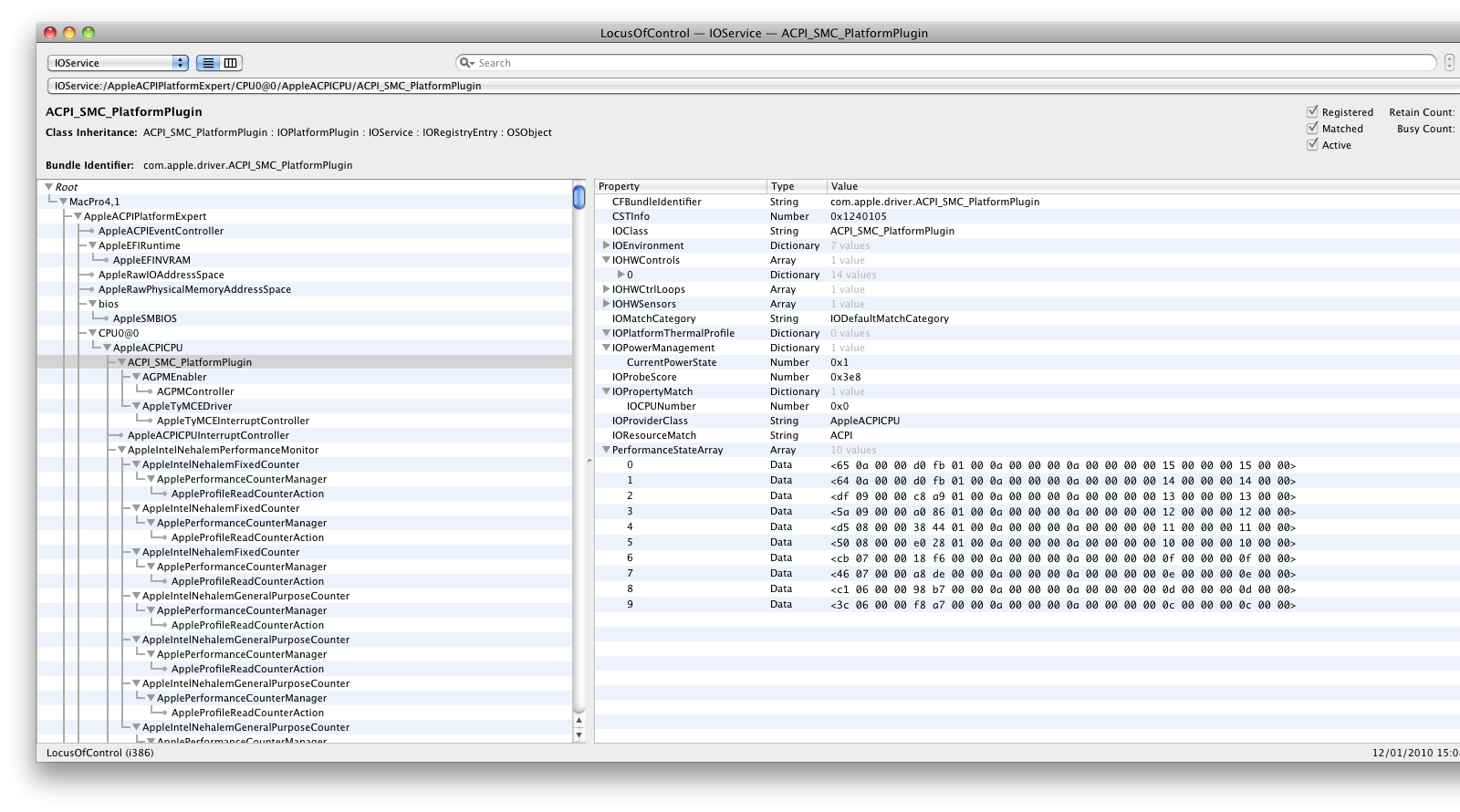

LocusOfControl Posted January 12, 2010 Share Posted January 12, 2010 Hi d00d Just a quickie question, my processor section of my DSDT resembles yours (straight cut & paste). HP However I run in 64bit mode so I was wondering what the best tools are to verify the C & P State magic working? I know that the common suggestion is to do ioreg | grep CPUPlimit but these never worked for me, but I'm not convinced this is definitive (how is this conclusion arrived at) Out of curiosity I ran i-mark and it seems to show fluctuating voltages and my fans speed up and slow down over time - reports my cpu temp as 27-28C at 2.8GHz (I have a big cooler and fans) Any thoughts on whats happening? Jan 12 10:34:11 LocusOfControl [0x0-0x26026].ru.mark.mark-i[19898]: REG=65 v=1.040000 Jan 12 10:34:11 LocusOfControl [0x0-0x26026].ru.mark.mark-i[19898]: REG=81 v=1.296000 Jan 12 10:34:11 LocusOfControl [0x0-0x26026].ru.mark.mark-i[19898]: REG=80 v=1.280000 Jan 12 10:34:11 LocusOfControl [0x0-0x26026].ru.mark.mark-i[19898]: REG=66 v=1.056000 Jan 12 10:34:11 LocusOfControl [0x0-0x26026].ru.mark.mark-i[19898]: REG=65 v=1.040000 Jan 12 10:34:11 LocusOfControl [0x0-0x26026].ru.mark.mark-i[19898]: REG=80 v=1.280000 Jan 12 10:34:11 LocusOfControl [0x0-0x26026].ru.mark.mark-i[19898]: REG=65 v=1.040000 Jan 12 10:34:11 LocusOfControl [0x0-0x26026].ru.mark.mark-i[19898]: REG=67 v=1.072000 Jan 12 10:34:11 LocusOfControl [0x0-0x26026].ru.mark.mark-i[19898]: REG=79 v=1.264000 Jan 12 10:34:11 LocusOfControl [0x0-0x26026].ru.mark.mark-i[19898]: REG=77 v=1.232000 Jan 12 10:34:11 LocusOfControl [0x0-0x26026].ru.mark.mark-i[19898]: REG=80 v=1.280000 Jan 12 10:34:11 LocusOfControl [0x0-0x26026].ru.mark.mark-i[19898]: REG=65 v=1.040000 Jan 12 10:34:11 LocusOfControl [0x0-0x26026].ru.mark.mark-i[19898]: REG=80 v=1.280000 Jan 12 10:34:11 LocusOfControl [0x0-0x26026].ru.mark.mark-i[19898]: REG=79 v=1.264000 Jan 12 10:34:11 LocusOfControl [0x0-0x26026].ru.mark.mark-i[19898]: REG=74 v=1.184000 Jan 12 10:34:11 LocusOfControl [0x0-0x26026].ru.mark.mark-i[19898]: REG=68 v=1.088000 Jan 12 10:34:11 LocusOfControl [0x0-0x26026].ru.mark.mark-i[19898]: REG=74 v=1.184000 Jan 12 10:34:11 LocusOfControl [0x0-0x26026].ru.mark.mark-i[19898]: REG=65 v=1.040000 Jan 12 10:34:11 LocusOfControl [0x0-0x26026].ru.mark.mark-i[19898]: REG=80 v=1.280000 Jan 12 10:34:11 LocusOfControl [0x0-0x26026].ru.mark.mark-i[19898]: REG=65 v=1.040000 kextstat Index Refs Address Size Wired Name (Version) <Linked Against> 1 60 0 0 0 com.apple.kpi.bsd (10.2.0) 2 4 0 0 0 com.apple.kpi.dsep (10.2.0) 3 85 0 0 0 com.apple.kpi.iokit (10.2.0) 4 91 0 0 0 com.apple.kpi.libkern (10.2.0) 5 71 0 0 0 com.apple.kpi.mach (10.2.0) 6 28 0 0 0 com.apple.kpi.private (10.2.0) 7 45 0 0 0 com.apple.kpi.unsupported (10.2.0) 8 13 0xffffff7f80600000 0x4000 0x4000 com.apple.iokit.IOACPIFamily (1.3.0) <7 6 4 3> 9 22 0xffffff7f80604000 0x12000 0x12000 com.apple.iokit.IOPCIFamily (2.6) <7 5 4 3> 10 1 0xffffff7f80616000 0x44000 0x44000 com.apple.driver.AppleACPIPlatform (1.3) <9 8 7 6 5 4 3> 11 0 0xffffff7f8065a000 0x1b000 0x1b000 com.apple.driver.AppleIntelCPUPowerManagement (96.0.0) <7 6 5 4 3 1> 12 3 0xffffff7f80675000 0x1a000 0x1a000 com.apple.iokit.IOStorageFamily (1.6) <7 6 5 4 3 1> 13 0 0xffffff7f8068f000 0x12000 0x12000 com.apple.driver.DiskImages (281) <12 7 6 5 4 3 1> 14 0 0xffffff7f806a1000 0x3000 0x3000 com.apple.driver.AppleIntelCPUPowerManagementClient (96.0.0) <7 6 5 4 3 1> 15 0 0xffffff7f806a4000 0x8000 0x8000 com.apple.nke.applicationfirewall (2.1.11) <7 6 5 4 3 1> 16 2 0xffffff7f806ac000 0x3000 0x3000 com.apple.kext.AppleMatch (1.0.0d1) <4 1> 17 0 0xffffff7f806af000 0x4000 0x4000 com.apple.security.quarantine (0) <16 7 6 5 4 2 1> 18 0 0xffffff7f806b3000 0x8000 0x8000 com.apple.security.sandbox (0) <16 7 6 5 4 2 1> 19 0 0xffffff7f806bb000 0x3000 0x3000 com.apple.security.TMSafetyNet (6) <7 6 5 4 2 1> 20 0 0xffffff7f806be000 0x3000 0x3000 com.apple.driver.AppleAPIC (1.4) <4 3> 21 0 0xffffff7f806c1000 0x4000 0x4000 com.apple.driver.AppleSMBIOS (1.4) <7 4 3> 22 0 0xffffff7f806c5000 0x3000 0x3000 com.apple.driver.AppleHPET (1.4) <8 7 5 4 3> 23 0 0xffffff7f806c8000 0x6000 0x6000 com.apple.driver.AppleRTC (1.3) <8 5 4 3 1> 24 7 0xffffff7f806ce000 0x42000 0x42000 com.apple.iokit.IOHIDFamily (1.6.1) <7 6 5 4 3 1> 25 0 0xffffff7f80710000 0x4000 0x4000 com.apple.driver.AppleACPIButtons (1.3) <24 10 8 7 6 5 4 3 1> 26 1 0xffffff7f80714000 0x3000 0x3000 com.apple.driver.AppleEFIRuntime (1.3.0) <7 5 4 3> 27 10 0xffffff7f80717000 0x34000 0x34000 com.apple.iokit.IOUSBFamily (3.8.5) <9 7 5 4 3 1> 28 0 0xffffff7f8074b000 0x10000 0x10000 com.apple.driver.AppleUSBUHCI (3.7.5) <27 9 7 5 4 3 1> 29 3 0xffffff7f8075b000 0x7000 0x7000 com.apple.iokit.IOAHCIFamily (2.0.2) <5 4 3 1> 30 0 0xffffff7f80762000 0xf000 0xf000 com.apple.driver.AppleAHCIPort (2.0.1) <29 9 5 4 3 1> 32 0 0xffffff7f80773000 0x5000 0x5000 com.apple.AppleFSCompression.AppleFSCompressionTypeZlib (1.0.0d1) <6 4 3 2 1> 33 0 0xffffff7f80778000 0x14000 0x14000 com.apple.driver.AppleUSBEHCI (3.7.5) <27 9 7 5 4 3 1> 34 0 0xffffff7f8078c000 0x4000 0x4000 org.netkas.fakesmc (2) <8 7 4 3> 35 2 0xffffff7f80790000 0x4b000 0x4b000 com.apple.iokit.IOFireWireFamily (4.1.7) <5 4 3 1> 36 0 0xffffff7f807db000 0x28000 0x28000 com.apple.driver.AppleFWOHCI (4.4.0) <35 9 7 6 5 4 3 1> 37 0 0xffffff7f80803000 0x4000 0x4000 com.apple.BootCache (31) <7 6 5 4 3 1> 38 0 0xffffff7f80807000 0x7000 0x7000 com.apple.driver.AppleEFINVRAM (1.3.0) <26 7 5 4 3> 39 0 0xffffff7f8080e000 0x2000 0x2000 com.apple.iokit.IOUSBUserClient (3.8.5) <27 7 5 4 3 1> 40 0 0xffffff7f80810000 0xf000 0xf000 com.apple.driver.AppleUSBHub (3.8.4) <27 5 4 3 1> 41 0 0xffffff7f8081f000 0x14000 0x14000 com.apple.iokit.IOAHCIBlockStorage (1.6.0) <29 12 5 4 3 1> 42 0 0xffffff7f80833000 0x3000 0x3000 com.apple.driver.XsanFilter (402.1) <12 5 4 3 1> 43 1 0xffffff7f80836000 0x4000 0x4000 com.apple.driver.AppleUSBComposite (3.7.5) <27 4 3 1> 44 0 0xffffff7f8083a000 0x4000 0x4000 com.apple.driver.AppleUSBMergeNub (3.8.5) <43 27 4 3 1> 45 4 0xffffff7f8083e000 0x42000 0x42000 com.apple.iokit.IOBluetoothFamily (2.2.4f3) <7 5 4 3 1> 46 1 0xffffff7f80880000 0x8000 0x8000 com.apple.driver.AppleUSBBluetoothHCIController (2.2.4f3) <45 27 7 5 4 3> 47 0 0xffffff7f80888000 0x6000 0x6000 com.apple.driver.BroadcomUSBBluetoothHCIController (2.2.4f3) <46 45 27 4 3> 48 1 0xffffff7f8088e000 0x2000 0x2000 com.apple.driver.AppleHIDKeyboard (1.2.0a3) <24 4 3> 49 1 0xffffff7f80890000 0x5000 0x5000 com.apple.iokit.IOUSBHIDDriver (3.8.4) <27 24 5 4 3 1> 50 0 0xffffff7f80895000 0x2000 0x2000 com.apple.driver.AppleUSBHIDKeyboard (1.2.0a3) <49 48 24 4 3> 51 1 0xffffff7f80897000 0x19000 0x19000 com.apple.iokit.IOSCSIArchitectureModelFamily (2.6.0) <5 4 3 1> 52 0 0xffffff7f808b0000 0x9000 0x9000 com.apple.iokit.IOAHCISerialATAPI (1.2.1) <51 29 5 4 3 1> 53 0 0xffffff7f808b9000 0xa000 0xa000 com.apple.filesystems.autofs (2.1.0) <7 6 5 4 3 1> 54 1 0xffffff7f808c3000 0x58000 0x58000 com.apple.filesystems.ntfs (3.1) <7 6 5 4 1> 55 0 0xffffff7f8091b000 0x3000 0x3000 com.apple.driver.AppleLPC (1.4.9) <9 5 4 3> 56 0 0xffffff7f8091e000 0x2000 0x2000 com.apple.driver.AppleSMBusPCI (1.0.4d0) <9 5 4 3> 57 2 0xffffff7f80920000 0xc000 0xc000 com.apple.driver.IOPlatformPluginFamily (4.0.1d0) <6 5 4 3> 58 2 0xffffff7f8092c000 0xb000 0xb000 com.apple.driver.AppleSMC (3.0.1d2) <8 7 5 4 3> 59 0 0xffffff7f80937000 0x11000 0x11000 com.apple.driver.ACPI_SMC_PlatformPlugin (4.0.1d0) <58 57 9 8 7 6 5 4 3> 60 2 0xffffff7f80948000 0x8000 0x8000 com.apple.iokit.IOHDAFamily (1.7.9a4) <5 4 3 1> 61 9 0xffffff7f80950000 0x23000 0x23000 com.apple.iokit.IOGraphicsFamily (2.0) <9 7 5 4 3> 62 1 0xffffff7f80973000 0x14000 0x14000 com.apple.driver.AppleHDAController (1.7.9a4) <61 60 9 5 4 3 1> 63 7 0xffffff7f80987000 0x34000 0x34000 com.apple.iokit.AppleProfileFamily (41) <9 7 6 5 4 3 1> 65 2 0xffffff7f809c3000 0x1a000 0x1a000 com.apple.iokit.IONetworkingFamily (1.9) <7 6 5 4 3 1> 66 0 0xffffff7f809dd000 0x9000 0x9000 com.apple.iokit.IOFireWireIP (2.0.3) <65 35 5 4 3 1> 68 2 0xffffff7f80a04000 0x2d000 0x2d000 com.apple.kext.ATISupport (6.0.6) <61 9 8 7 5 4 3 1> 69 0 0xffffff7f80a31000 0x98000 0x98000 com.apple.kext.ATI4800Controller (6.0.6) <68 61 9 8 5 4 3 1> 70 1 0xffffff7f80ac9000 0x2000 0x2000 com.apple.iokit.IOSMBusFamily (1.1) <5 4 3> 71 0 0xffffff7f80acb000 0xb000 0xb000 com.apple.driver.AppleSMBusController (1.0.4d0) <70 9 8 5 4 3> 72 2 0xffffff7f80ad6000 0x5000 0x5000 com.apple.kext.OSvKernDSPLib (1.3) <5 4> 73 3 0xffffff7f80adb000 0x1b000 0x1b000 com.apple.iokit.IOAudioFamily (1.7.2fc1) <72 5 4 3 1> 74 0 0xffffff7f80af6000 0x4000 0x4000 com.apple.driver.AudioIPCDriver (1.1.2) <73 5 4 3 1> 75 2 0xffffff7f80afa000 0xf000 0xf000 com.apple.iokit.IONDRVSupport (2.0) <61 9 7 5 4 3> 76 1 0xffffff7f80b09000 0x7c000 0x7c000 com.apple.driver.DspFuncLib (1.7.9a4) <73 72 5 4 3 1> 77 0 0xffffff7f80b85000 0xb3000 0xb3000 com.apple.driver.AppleHDA (1.7.9a4) <76 75 73 62 61 60 5 4 3 1> 78 0 0xffffff7f80c38000 0x8000 0x8000 com.apple.driver.AppleIntelNehalemProfile (11) <63 6 4 3> 79 0 0xffffff7f80c40000 0x15000 0x15000 com.apple.driver.Intel82574L (1.0.4b1) <65 9 5 4 3 1> 80 0 0xffffff7f80c55000 0x5000 0x5000 com.apple.Dont_Steal_Mac_OS_X (7.0.0) <58 7 4 3 1> 83 0 0xffffff7f80c64000 0x177000 0x177000 com.apple.ATIRadeonX2000 (6.0.6) <75 61 9 7 6 5 4 3 1> 84 1 0xffffff7f80ddb000 0xa000 0xa000 com.apple.iokit.IOSerialFamily (10.0.3) <7 6 5 4 3 1> 85 0 0xffffff7f80de5000 0xa000 0xa000 com.apple.iokit.IOBluetoothSerialManager (2.2.4f3) <84 7 5 4 3 1> 86 1 0xffffff7f80def000 0x9000 0x9000 com.apple.driver.AppleMultitouchDriver (204.9) <24 7 6 5 4 3 1> 87 1 0xffffff7f80df8000 0xd000 0xd000 com.apple.driver.IOBluetoothHIDDriver (2.2.4f3) <45 24 4 3> 88 0 0xffffff7f80e05000 0xa000 0xa000 com.apple.driver.AppleBluetoothMultitouch (30.9) <87 86 45 24 5 4 3> 89 0 0xffffff7f80e0f000 0x12000 0x12000 com.apple.kext.ATIFramebuffer (6.0.6) <68 61 9 8 7 5 4 3 1> 90 0 0xffffff7f80e21000 0xc000 0xc000 com.apple.iokit.IOSurface (73.0) <7 5 4 3 1> 91 0 0xffffff7f80e2d000 0x5000 0x5000 com.apple.driver.AppleUpstreamUserClient (3.1.0) <61 9 8 7 5 4 3 1> 92 0 0xffffff7f80e32000 0x4000 0x4000 com.apple.iokit.KLog (3.7.5) <27 4 3 1> 93 0 0xffffff7f80e36000 0x4000 0x4000 com.evosx86.driver.lspcidrv (1.0) <4 3> 94 0 0xffffff7f80e3a000 0x3000 0x3000 com.apple.driver.AppleProfileCallstackAction (20) <63 5 4 3 1> 96 0 0xffffff7f80e42000 0x2000 0x2000 com.apple.driver.AppleProfileKEventAction (10) <63 4 3 1> 97 0 0xffffff7f80e44000 0x5000 0x5000 com.apple.driver.AppleHWSensor (1.9.2d0) <5 4 3> 98 0 0xffffff7f80e49000 0x9000 0x9000 com.apple.driver.AGPM (100.9.3) <61 9 5 4 3> 99 0 0xffffff7f80e52000 0x9000 0x9000 com.apple.driver.AppleTyMCEDriver (1.0.1d8) <57 9 8 7 6 5 4 3 1> 100 0 0xffffff7f80e5b000 0x2000 0x2000 com.apple.driver.AppleProfileRegisterStateAction (10) <63 4 3 1> 101 0 0xffffff7f80e5d000 0x2000 0x2000 com.apple.driver.AppleProfileThreadInfoAction (14) <63 6 4 3 1> 102 0 0xffffff7f80e5f000 0x2000 0x2000 com.apple.driver.AppleProfileTimestampAction (10) <63 5 4 3 1> 103 0 0xffffff7f80e61000 0x3000 0x3000 com.apple.driver.AppleProfileReadCounterAction (17) <63 6 4 3> 105 0 0xffffff7f809bb000 0x4000 0x4000 ru.mark.driver.RingAccess (0.41) <7 5 4 3> Link to comment https://www.insanelymac.com/forum/topic/196771-ga-ex58-and-ga-x58a-dsdt-native-power-management-modifications/page/11/#findComment-1383298 Share on other sites More sharing options...
d00d Posted January 12, 2010 Author Share Posted January 12, 2010 Hi d00d Just a quickie question, my processor section of my DSDT resembles yours (straight cut & paste). HP However I run in 64bit mode so I was wondering what the best tools are to verify the C & P State magic working? I know that the common suggestion is to do ioreg | grep CPUPlimit but these never worked for me, but I'm not convinced this is definitive (how is this conclusion arrived at) Out of curiosity I ran i-mark and it seems to show fluctuating voltages and my fans speed up and slow down over time - reports my cpu temp as 27-28C at 2.8GHz (I have a big cooler and fans) Any thoughts on whats happening? I'm unfamiliar with i-mark, and a casual search doesn't locate it, but one way to check that the [P|C]States are working is that there are no related errors in kernel.log;kernel[0]: ACPI_SMC_PlatformPlugin::gatherCStateOverrides - failed to set c-state demotion data: -1 kernel[0]: ACPI_SMC_PlatformPlugin::pushCPU_CSTData - _CST evaluation failed kernel[0]: ACPI_SMC_PlatformPlugin::getCPU_PSSData - _PSS evaluation failed kernel[0]: WARNING: ACPI_SMC_CtrlLoop::initCPUCtrlLoop - turbo enabled but no turbo P-state found Boot 32 bit and use Chrysaor's MSR Tools. This will show you the turbo and plus one turbo ratios if you're using turbo, and the speed step downward ratios if you're using demong1's MacPro4_1.plist (see Bonjour Update 2010-001 warning at bottom of post 1). In ioreg at IOService:/AppleACPIPlatformExpert/CPU0@0/AppleACPICPU/ACPI_SMC_PlatformPlugin you will see the CState's CSTinfo and the PState's PerformanceStateArray. For the speed step downward ratios, in ioreg at IOService:/AppleACPIPlatformExpert/CPU0@0/AppleACPICPU/ACPI_SMC_PlatformPlugin you will see CPUPLimit with a value of 0x0, a different value if it's not activated, or not there at all if not enabled. Link to comment https://www.insanelymac.com/forum/topic/196771-ga-ex58-and-ga-x58a-dsdt-native-power-management-modifications/page/11/#findComment-1383387 Share on other sites More sharing options...
LocusOfControl Posted January 12, 2010 Share Posted January 12, 2010 I'm unfamiliar with i-mark, and a casual search doesn't locate it, but one way to check that the [P|C]States are working is that there are no related errors in kernel.log;kernel[0]: ACPI_SMC_PlatformPlugin::gatherCStateOverrides - failed to set c-state demotion data: -1 kernel[0]: ACPI_SMC_PlatformPlugin::pushCPU_CSTData - _CST evaluation failed kernel[0]: ACPI_SMC_PlatformPlugin::getCPU_PSSData - _PSS evaluation failed kernel[0]: WARNING: ACPI_SMC_CtrlLoop::initCPUCtrlLoop - turbo enabled but no turbo P-state found Boot 32 bit and use Chrysaor's MSR Tools. This will show you the turbo and plus one turbo ratios if you're using turbo, and the speed step downward ratios if you're using demong1's MacPro4_1.plist (see Bonjour Update 2010-001 warning at bottom of post 1). In ioreg at IOService:/AppleACPIPlatformExpert/CPU0@0/AppleACPICPU/ACPI_SMC_PlatformPlugin you will see the CState's CSTinfo and the PState's PerformanceStateArray. For the speed step downward ratios, in ioreg at IOService:/AppleACPIPlatformExpert/CPU0@0/AppleACPICPU/ACPI_SMC_PlatformPlugin you will see CPUPLimit with a value of 0x0, a different value if it's not activated, or not there at all if not enabled. A quick check shows that no errors since Nov 27th which sounds about the time I started fixing this kernel.log.4:Nov 27 23:17:38 LocusOfControl kernel[0]: ACPI_SMC_PlatformPlugin::pushCPU_CSTData - _CST evaluation failed No errors since ... I got the i-mark link from the gigabyte thread http://www.insanelymac.com/forum/index.php...p;#entry1377246 I notice in ioreg I have what appear to be 10 p-states, Thus is what I translated the data from ioreg to be Name (_PSS, Package (0x0A) { Package (0x06) { 0x00000A65, 0x0001FBD0, 0x0000000A, 0x0000000A, 0x00000015, 0x00000015 }, etc, but I don't see any c-state info (yet the error in the log is gone and there is no CPUPLimit) strange ? Is it possible there are differences between C0 & D0 i7's? (by the way I took the bonjour update as soon as it came out - bonjour always worked out of the box for me and I've subsequently replaced the onboard NIC's with an apple gig-e card) Link to comment https://www.insanelymac.com/forum/topic/196771-ga-ex58-and-ga-x58a-dsdt-native-power-management-modifications/page/11/#findComment-1383464 Share on other sites More sharing options...
mm67 Posted January 12, 2010 Share Posted January 12, 2010 A quick check shows that no errors since Nov 27th which sounds about the time I started fixing this kernel.log.4:Nov 27 23:17:38 LocusOfControl kernel[0]: ACPI_SMC_PlatformPlugin::pushCPU_CSTData - _CST evaluation failed No errors since ... I got the i-mark link from the gigabyte thread http://www.insanelymac.com/forum/index.php...p;#entry1377246 I notice in ioreg I have what appear to be 10 p-states, Thus is what I translated the data from ioreg to be Name (_PSS, Package (0x0A) { Package (0x06) { 0x00000A65, 0x0001FBD0, 0x0000000A, 0x0000000A, 0x00000015, 0x00000015 }, etc, but I don't see any c-state info (yet the error in the log is gone and there is no CPUPLimit) strange ? Is it possible there are differences between C0 & D0 i7's? (by the way I took the bonjour update as soon as it came out - bonjour always worked out of the box for me and I've subsequently replaced the onboard NIC's with an apple gig-e card) That CSTInfo line tells that you have some kind of valid CST table loaded. Link to comment https://www.insanelymac.com/forum/topic/196771-ga-ex58-and-ga-x58a-dsdt-native-power-management-modifications/page/11/#findComment-1383478 Share on other sites More sharing options...

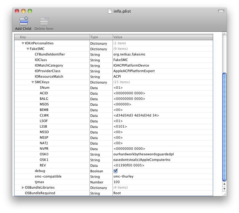

LocusOfControl Posted January 12, 2010 Share Posted January 12, 2010 That CSTInfo line tells that you have some kind of valid CST table loaded. I have 0x1240105 - doesn't seem to correspond to anything in DSDT (or SSDT) Do I just assume it is OK? Incidentally , in FakeSMC you have REV=ATkPAAAF how do you translate this to get 1.39f5 ??????? "Modify fakesmc.kext/Contents/Info.plist in two places with MacPro4,1 specific information (1.30f3 and smc-napa changed to 1.39f5 and smc-thurley)." In FakeSMC Revision=<01 39 0f 00 00 05> shown in plist editor. I have ATkPAAAF set via vi AppleSMC has smc-version 1.39f5, I assume they are not equal? Do these have to match? Is this important? Link to comment https://www.insanelymac.com/forum/topic/196771-ga-ex58-and-ga-x58a-dsdt-native-power-management-modifications/page/11/#findComment-1383501 Share on other sites More sharing options...
mm67 Posted January 12, 2010 Share Posted January 12, 2010 I have 0x1240105 - doesn't seem to correspond to anything in DSDT (or SSDT)Do I just assume it is OK? We all have that same value with 10.6.2, including real Mac's. It only seems to tell that you have a valid table. Link to comment https://www.insanelymac.com/forum/topic/196771-ga-ex58-and-ga-x58a-dsdt-native-power-management-modifications/page/11/#findComment-1383515 Share on other sites More sharing options...
LocusOfControl Posted January 12, 2010 Share Posted January 12, 2010 We all have that same value with 10.6.2, including real Mac's. It only seems to tell that you have a valid table. Thanks, Any confirmation that the SMC key is correct d00d ? ie what language is that and does 01 39 0f 00 00 05 some how translate to 1.39f5 ? the first 4 numbers seem a straight fit to 1.39 but the next 8 seem an odd fit to f5 Link to comment https://www.insanelymac.com/forum/topic/196771-ga-ex58-and-ga-x58a-dsdt-native-power-management-modifications/page/11/#findComment-1383526 Share on other sites More sharing options...
LocusOfControl Posted January 12, 2010 Share Posted January 12, 2010 I have 0x1240105 - doesn't seem to correspond to anything in DSDT (or SSDT)Do I just assume it is OK? Incidentally , in FakeSMC you have REV=ATkPAAAF how do you translate this to get 1.39f5 ??????? "Modify fakesmc.kext/Contents/Info.plist in two places with MacPro4,1 specific information (1.30f3 and smc-napa changed to 1.39f5 and smc-thurley)." In FakeSMC Revision=<01 39 0f 00 00 05> shown in plist editor. I have ATkPAAAF set via vi AppleSMC has smc-version 1.39f5, I assume they are not equal? Do these have to match? Is this important? out of curiosity, I changed the value of revision to <0139f5000000> On reboot I got an error in kernel log Jan 12 17:25:55 localhost kernel[0]: FakeSMC: key REV has wrong length 3, should be 4, not adding I notice though that AppleSMC no longer has an attribute called smc-version set but still says smc-thurley I haven't noticed anything different ie no extra info Link to comment https://www.insanelymac.com/forum/topic/196771-ga-ex58-and-ga-x58a-dsdt-native-power-management-modifications/page/11/#findComment-1383578 Share on other sites More sharing options...

LocusOfControl Posted January 12, 2010 Share Posted January 12, 2010 I have 0x1240105 - doesn't seem to correspond to anything in DSDT (or SSDT)Do I just assume it is OK? Incidentally , in FakeSMC you have REV=ATkPAAAF how do you translate this to get 1.39f5 ??????? "Modify fakesmc.kext/Contents/Info.plist in two places with MacPro4,1 specific information (1.30f3 and smc-napa changed to 1.39f5 and smc-thurley)." In FakeSMC Revision=<01 39 0f 00 00 05> shown in plist editor. I have ATkPAAAF set via vi AppleSMC has smc-version 1.39f5, I assume they are not equal? Do these have to match? Is this important? In case anyone is curious <01 39 0f 00 00 05> is hex encoded to ATkPAAAF in base 64 Link to comment https://www.insanelymac.com/forum/topic/196771-ga-ex58-and-ga-x58a-dsdt-native-power-management-modifications/page/11/#findComment-1383821 Share on other sites More sharing options...

d00d Posted January 13, 2010 Author Share Posted January 13, 2010 In case anyone is curious <01 39 0f 00 00 05> is hex encoded to ATkPAAAF in base 64 Thanks LocusOfControl. Oh that is very good news! So, even though system profiler, nor the midi setup shows more than 2 channel, it is possible? That's a nice future prospect. Anyway, the reason why I was posting again here was that I seem to get KP's now and then. It has to do with my VMware installation for sure, because that's when they happen (sometimes when I start VMware). I'm just wondering if it is theoretically possible to run VMware without problems on OSX86. If not, then at least I know where I stand. Here's the KP, does anybody understand what's happening here? I'm running several VMware 3.0.1 images successfully without panic.The KP looks like what I get with an unstable over clock, does any other high CPU activity application cause a KP? Run `top -ocpu' in Terminal. Link to comment https://www.insanelymac.com/forum/topic/196771-ga-ex58-and-ga-x58a-dsdt-native-power-management-modifications/page/11/#findComment-1384265 Share on other sites More sharing options...

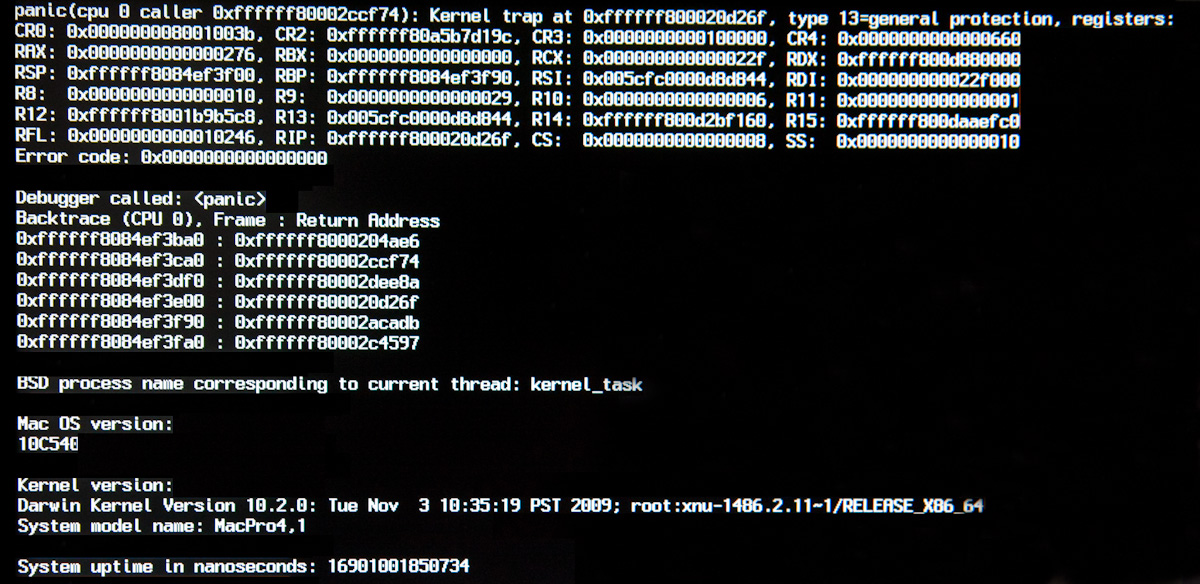

Josvdp Posted January 13, 2010 Share Posted January 13, 2010 Thanks LocusOfControl. I'm running several VMware 3.0.1 images successfully without panic. The KP looks like what I get with an unstable over clock, does any other high CPU activity application cause a KP? Run `top -ocpu' in Terminal. Mmh, that's funny! Because I have actually thought about these KP's being caused by my overclock. But since my overclock is not very spectacular (3,4 gHz without higher Vcore) and since it doesn't happen randomly, but rather when I start VMware. I thought it didn't have to do anything with it. But you might be right! Maybe I'll put mprime on tonight to check the stability. Is there a way to interpret these KP's? Because to me it just looks like a big pile of error codes. If I could understand these KP's a bit more, I can see the relationship between them in the future myself. In that case, I will log all the KP's and see if they have the same cause. I guess I could read something like this or this. Link to comment https://www.insanelymac.com/forum/topic/196771-ga-ex58-and-ga-x58a-dsdt-native-power-management-modifications/page/11/#findComment-1384357 Share on other sites More sharing options...
kdawg Posted January 13, 2010 Share Posted January 13, 2010 Mmh, that's funny! Because I have actually thought about these KP's being caused by my overclock. But since my overclock is not very spectacular (3,4 gHz without higher Vcore) and since it doesn't happen randomly, but rather when I start VMware. I thought it didn't have to do anything with it. But you might be right! Maybe I'll put mprime on tonight to check the stability. Is there a way to interpret these KP's? Because to me it just looks like a big pile of error codes. If I could understand these KP's a bit more, I can see the relationship between them in the future myself. In that case, I will log all the KP's and see if they have the same cause. Be sure the voltage for your RAM is high enough. I had to up mine to 2.1v before it ran stable. Auto was only giving it 1.8v. Check the specs for your RAM. Make sure you set the timings too. You can check out my BIOS settings in my signature however I have a P45 MOBO some of it will apply to you. Link to comment https://www.insanelymac.com/forum/topic/196771-ga-ex58-and-ga-x58a-dsdt-native-power-management-modifications/page/11/#findComment-1384358 Share on other sites More sharing options...
