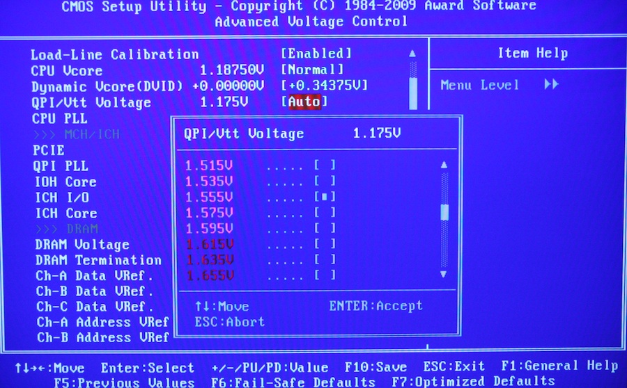

d00d Posted January 6, 2010 Author Share Posted January 6, 2010 Ok, in that case, I will skip the buildcache step. I just went to change my BIOS settings, but I don't dare to put in the settings you gave in the file of DVID_4.3. Some things didn't really match up (like Vcore of 1.56, that's not an option on my BIOS). I guess you weren't using a 920, were you? I'd just like to know which BIOS settings are mandatory for the Native powermanagement to work, the overclock I can always do later. You should be able to go to 1.56 v for Vcore, the setting you are seeing is different, and unless you have 12 GB of memory, yours should be lower;QPI/VTT Voltage 1.2v ............ [AUTO] 1.56 The settings in Advanced CPU Features can be enabled for native PM, but if you're using a DSDT with [P|C]States, it's enabled by that. I'm using a Xeon W3520, it's essentially the same as your i7 920, but it has the capability to use ECC memory. Ok either I am blind or plainly stupid...I checked the link out and it only made a reference to the dummy kext by the King, I am on 10.6.2 so I should be using demongs plist, I will ask again kindly ...where do I place this plist file? Thanks It's in post 1 towards the bottom before the links. Link to comment https://www.insanelymac.com/forum/topic/196771-ga-ex58-and-ga-x58a-dsdt-native-power-management-modifications/page/10/#findComment-1378327 Share on other sites More sharing options...
Josvdp Posted January 6, 2010 Share Posted January 6, 2010 You should be able to go to 1.56 v for Vcore, the setting you are seeing is different, and unless you have 12 GB of memory, yours should be lower;QPI/VTT Voltage 1.2v ............ [AUTO] 1.56 The settings in Advanced CPU Features can be enabled for native PM, but if you're using a DSDT with [P|C]States, it's enabled by that. I'm using a Xeon W3520, it's essentially the same as your i7 920, but it has the capability to use ECC memory. It's in post 1 towards the bottom before the links. Ok, well, I'll go in again and maybe change it. But I remember that the closest setting was 1.555 and it was colored red (I guess it's pretty high). I have 6 GB of memory so maybe that's why. For now though, I don't need an overclock yet and I was just wondering if I need to make any changes in the BIOS for the native powermanagement to work. When I'm using a DSDT with [P|C]States you say it's enabled by that? I assume you mean that OSX will change it itself? I'm just a bit confused here Link to comment https://www.insanelymac.com/forum/topic/196771-ga-ex58-and-ga-x58a-dsdt-native-power-management-modifications/page/10/#findComment-1378331 Share on other sites More sharing options...
d00d Posted January 6, 2010 Author Share Posted January 6, 2010 Ok, well, I'll go in again and maybe change it. But I remember that the closest setting was 1.555 and it was colored red (I guess it's pretty high). I have 6 GB of memory so maybe that's why. For now though, I don't need an overclock yet and I was just wondering if I need to make any changes in the BIOS for the native powermanagement to work. When I'm using a DSDT with [P|C]States you say it's enabled by that? I assume you mean that OSX will change it itself? I'm just a bit confused here It goes red at 1.58 v.The OS gets it's orders from the BIOS aor the DSDT. Link to comment https://www.insanelymac.com/forum/topic/196771-ga-ex58-and-ga-x58a-dsdt-native-power-management-modifications/page/10/#findComment-1378337 Share on other sites More sharing options...

Josvdp Posted January 6, 2010 Share Posted January 6, 2010 It goes red at 1.58 v.The OS gets it's orders from the BIOS aor the DSDT. I took a picture that shows that it doesn't have 1.58 for me and that it's already red (or pink actually) at this level. It goes blinking red at 1.615. I'm using a stock cooler and I just don't like the idea of putting too many Volts on my CPU. The default isn't 1.2 either, it's 1.175 so I have a feeling that there's something wrong here. But anyway, these settings aren't the most important for the native powermanagement to work, right? Link to comment https://www.insanelymac.com/forum/topic/196771-ga-ex58-and-ga-x58a-dsdt-native-power-management-modifications/page/10/#findComment-1378357 Share on other sites More sharing options...
d00d Posted January 6, 2010 Author Share Posted January 6, 2010 I took a picture that shows that it doesn't have 1.58 for me and that it's already red (or pink actually) at this level. It goes blinking red at 1.615. I'm using a stock cooler and I just don't like the idea of putting too many Volts on my CPU. The default isn't 1.2 either, it's 1.175 so I have a feeling that there's something wrong here. But anyway, these settings aren't the most important for the native powermanagement to work, right? Yes, you should stay out of the red.My QPI/VTT is pink up to 1.56, then red at 1.58, and the steps are .02. I compared your picture against Gigabyte's `Core i7 920 oc 4G 2008.12.12_(ENG).pdf' and that shows a setting of 1.515. My W3520 steps from 1.56 pink to 1.58 red, but your 920 steps from 1.595 pink to 1.615 red, for different values but using the same .02 step. Regardless, these are over clock settings and don't directly have anything to do with native PM. Link to comment https://www.insanelymac.com/forum/topic/196771-ga-ex58-and-ga-x58a-dsdt-native-power-management-modifications/page/10/#findComment-1378406 Share on other sites More sharing options...

kdawg Posted January 7, 2010 Share Posted January 7, 2010 Yes, you should stay out of the red.My QPI/VTT is pink up to 1.56, then red at 1.58, and the steps are .02. I compared your picture against Gigabyte's `Core i7 920 oc 4G 2008.12.12_(ENG).pdf' and that shows a setting of 1.515. My W3520 steps from 1.56 pink to 1.58 red, but your 920 steps from 1.595 pink to 1.615 red, for different values but using the same .02 step. Regardless, these are over clock settings and don't directly have anything to do with native PM. FYI, I've updated my signature to include my BIOS settings for OC'ing. I don't have a P55 MOBO or an i7 but a lot of it may still be applicable. Link to comment https://www.insanelymac.com/forum/topic/196771-ga-ex58-and-ga-x58a-dsdt-native-power-management-modifications/page/10/#findComment-1378833 Share on other sites More sharing options...

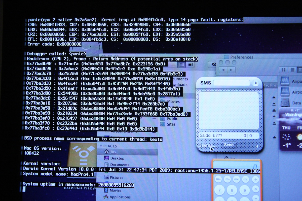

Josvdp Posted January 8, 2010 Share Posted January 8, 2010 Why do you have Darwin Kernel Version 10.0.0 (10.6.0 and 1) in your KP if your signature shows 10.6.2, which would be Darwin Kernel Version 10.2.0?My MB doesn't squeal thankfully, I've read that you can paint the components with nail polish to fix. Update: Did your signature used to show 10.6.2? For anything over a mild over clock you should use a bigger CPU cooler, I'd recommend the Noctua NH-D14, the CPU runs 10 C cooler under load than the NH-U12P SE2. Are you using my automatic voltage 3.7 GHz BIOS settings for your 3.4 GHz? You shouldn't have to specify higher voltages at that speed. You're right about my signature. I had 10.6.2 in my sig, because that was my 'old setup'. I'm gonna update to 10.6.2 tonight. ------------ Thanks for the tip on nailpolish, but as for now I think I'm just going to try and turn off the voltage settings. ------------ Ok, this one is going to make you laugh: I installed 10.6.2 and I sound was, uh, dead. So, at first I just though it was your 'fix' from your second post (delete BuiltInHDA). So I did that, but still no sound. Turned out that I had deleted only the <key>BuiltInHDA</key> and not the <dict>... So, redid the mkext with the complete key removed. Still no sound! I almost started pulling out hairs, I was quite frustrated. So, I thought: "Let's try the front audio port with a headphone." And yup! "Holy smokes, sound works!" Turns out I just had to flip the audio output in the Sound settings. Hehe, so easy! But when I think of it, I should have thought of this earlier. Because my very first built had the exact same problem and also aschar1 himself notes that the fix doesn't have automatic switch to headphones. But I do have an audio related question! I'm using 2.1 speakers now, but what if I want to use an advanced (5.1 DTS whatever, you name is) system. Does that work with this? (1) ------------ Also I would like to point out the fact that sometimes I can't use my keyboard at boot (so I can't do anything at BIOS and not anything at Chameleon either). There were even times that it wasn't possible 10+ boots in a row. What's wrong? (2) Edit: it seems to be fairly gone now. Didn't have it anymore. Didn't know what fixed it either but it's weird . ------------ With the terminal I did: Mac-Pro:kext me$ uname -p i386 But I booted with the arch=x86_64 flag in my /Extra/com.apple.boot.plist Profiler says: " 64-bit Kernel and Extensions: Yes" Am I running 64-bit or not? Is this something to worry about? (3) ------------ It seems that sleep is still causing trouble, a while ago I got a KP after sleep and last night the system didn't want to go into sleep. Instead, the displays just turned off and the fans spun up. If this is going to be happening more often, I will have to check what's wrong. Is there something that logs when it sleeps/wakes? How do I know what's going wrong? (4) Link to comment https://www.insanelymac.com/forum/topic/196771-ga-ex58-and-ga-x58a-dsdt-native-power-management-modifications/page/10/#findComment-1379419 Share on other sites More sharing options...
