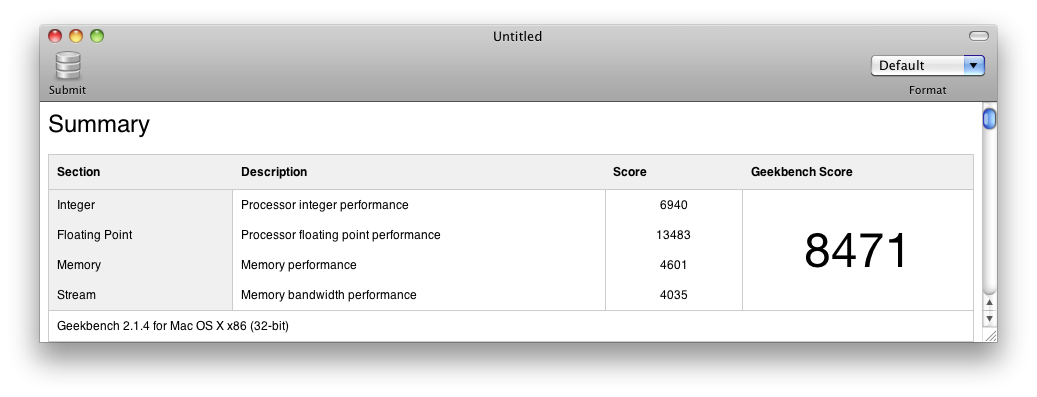

LocusOfControl Posted January 13, 2010 Share Posted January 13, 2010 Be sure the voltage for your RAM is high enough. I had to up mine to 2.1v before it ran stable. Auto was only giving it 1.8v. Check the specs for your RAM. Make sure you set the timings too. You can check out my BIOS settings in my signature however I have a P45 MOBO some of it will apply to you. Thanks for the tip, when I overclock I can get to 4GHz but I have to run the RAM really slow eg x6 for 12GB At normal speeds upto about 3.4 auto seems to cope but can be flaky Probably explains why my geekbench scores are slightly lower than others and my i7 is the bottleneck for my graphics card Link to comment https://www.insanelymac.com/forum/topic/196771-ga-ex58-and-ga-x58a-dsdt-native-power-management-modifications/page/12/#findComment-1384377 Share on other sites More sharing options...
kdawg Posted January 13, 2010 Share Posted January 13, 2010 Thanks for the tip, when I overclock I can get to 4GHz but I have to run the RAM really slow eg x6 for 12GBAt normal speeds upto about 3.4 auto seems to cope but can be flaky Probably explains why my geekbench scores are slightly lower than others and my i7 is the bottleneck for my graphics card Take a look at this thread. http://gskill.us/forum/showthread.php?t=1169 It's a G.Skill thread but it may apply to you as well. If you're using 12GB RAM you may want to up MCH Core and tRFC too. What is your Geekbench score BTW? Link to comment https://www.insanelymac.com/forum/topic/196771-ga-ex58-and-ga-x58a-dsdt-native-power-management-modifications/page/12/#findComment-1384387 Share on other sites More sharing options...
LocusOfControl Posted January 13, 2010 Share Posted January 13, 2010 Take a look at this thread. http://gskill.us/forum/showthread.php?t=1169 It's a G.Skill thread but it may apply to you as well. If you're using 12GB RAM you may want to up MCH Core and tRFC too. What is your Geekbench score BTW? At stock 8471 but I've had 11 to 12000 at 3.8GHz some time ago (32 version bit only on 64 bit platform) I've done some tidying up and replaced my onboard NIC so I think my score went up a hundred or more since last week I find that with the opengl extensions view tests my score goes up depending on cpu speed which to me sounds like the cpu is slower than the gpu? Link to comment https://www.insanelymac.com/forum/topic/196771-ga-ex58-and-ga-x58a-dsdt-native-power-management-modifications/page/12/#findComment-1384422 Share on other sites More sharing options...

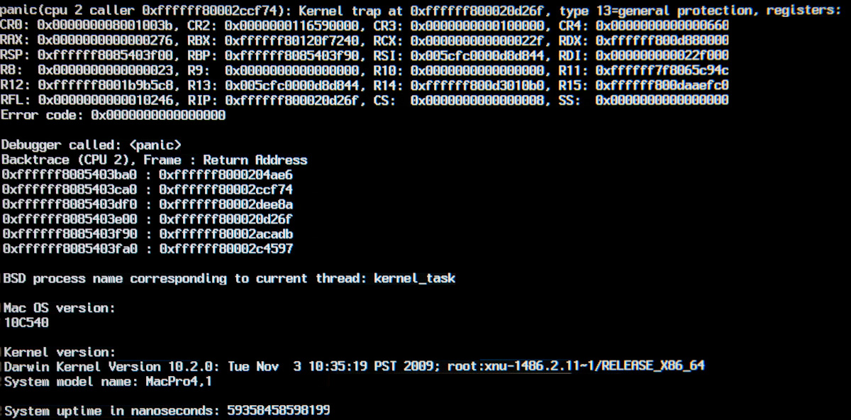

Josvdp Posted January 14, 2010 Share Posted January 14, 2010 Thanks LocusOfControl. I'm running several VMware 3.0.1 images successfully without panic. The KP looks like what I get with an unstable over clock, does any other high CPU activity application cause a KP? Run `top -ocpu' in Terminal. Ok, I got another KP. It was almost exactly the same and it was, again, when I booted VMware Fusion 3. See attached: I still don't know how to interpret these KP's, even though I've read several articles about them. I just don't know what all the funny codes (HEX?) mean. Anyway, developer.Apple.com says this about my type of KP (General protection): General protection faults, caused by any of a number of conditions, including transferring execution to a non-executable code segment or writing to either a code segment or read-only data segment. I'm going to suspend/wake Windows 7 VMware a couple of times to see if I can recreate the KP. To make things clear: I run an OC, without any voltage mods. My geekbench score for this setup was 9700 yesterday. I get KP's when I start VMware (when I resume a suspended Windows 7) and in the beginning, I used to have 2 or 3 after wake up. Didn't log those though so can't say anything about those. Update I've suspended/woken Windows 7 in VMware about 4 times now and this seems to be going perfectly smooth! The CPU tops at about 40% when I look at top -ocpu, but no KP's. Update 2 I've also done sleep, then start VMware and wake Windows 7, no problems. I have even managed to successfully sleep/wake OSX while running a (live) Windows 7 in VMware, something I didn't really expect to go smoothly. That didn't even used to go smooth on my MBP. Update 3 I ran some prime tests (very shortly though). I ran a torture Blend test (8 threads, so all cores) and CPU temps seem to go pretty high (I've seen 100 degrees celcius in iStat with about 30 in the case) but no KP's. I stopped because I thought the temperature was just too high to continue. The temperature is about 47 idle. Funny though, top -ocpu reported %CPU loads of 800! I'm not sure if that's a bug or something, but it sure was funny to see it using 4 cores hyperthreading. Link to comment https://www.insanelymac.com/forum/topic/196771-ga-ex58-and-ga-x58a-dsdt-native-power-management-modifications/page/12/#findComment-1385376 Share on other sites More sharing options...
d00d Posted January 14, 2010 Author Share Posted January 14, 2010 Ok, I got another KP. It was almost exactly the same and it was, again, when I booted VMware Fusion 3. See attached: I still don't know how to interpret these KP's, even though I've read several articles about them. I just don't know what all the funny codes (HEX?) mean. Anyway, developer.Apple.com says this about my type of KP (General protection): I'm going to suspend/wake Windows 7 VMware a couple of times to see if I can recreate the KP. To make things clear: I run an OC, without any voltage mods. My geekbench score for this setup was 9700 yesterday. I get KP's when I start VMware (when I resume a suspended Windows 7) and in the beginning, I used to have 2 or 3 after wake up. Didn't log those though so can't say anything about those. Update I've suspended/woken Windows 7 in VMware about 4 times now and this seems to be going perfectly smooth! The CPU tops at about 40% when I look at top -ocpu, but no KP's. What it's not is an incompatible kext, because that would give you a KP each time.If you don't get any KPs using VMware at standard clock, you've isolated the issue to your over clock voltages. Link to comment https://www.insanelymac.com/forum/topic/196771-ga-ex58-and-ga-x58a-dsdt-native-power-management-modifications/page/12/#findComment-1385389 Share on other sites More sharing options...
Josvdp Posted January 14, 2010 Share Posted January 14, 2010 What it's not is an incompatible kext, because that would give you a KP each time.If you don't get any KPs using VMware at standard clock, you've isolated the issue to your over clock voltages. That's exactly what I was planning on doing and so, I'm running stock speed as we speak. Geekbench score is 7763, kind of a disappointment, but hee, you have to start somewhere. I'm sure I'll manage an over clock in the future. For now, I just want to know if it's the native PM (since this is the topic for it ) or if it was actually my OC. I highly doubt it was my OC, since it only occurred at wake-up of Windows 7 in VMware. Well, that's not entirely true, because an hour ago, I experienced a KP while I was doing nothing. I was actually on the phone and OSX was just idle with Adium, Safari and some other things running (including VMware I think). This one seems to be different and includes some kexts that were involved. Is this more worrying? Remember, this KP happened BEFORE I took the OC OFF. Link to comment https://www.insanelymac.com/forum/topic/196771-ga-ex58-and-ga-x58a-dsdt-native-power-management-modifications/page/12/#findComment-1385495 Share on other sites More sharing options...

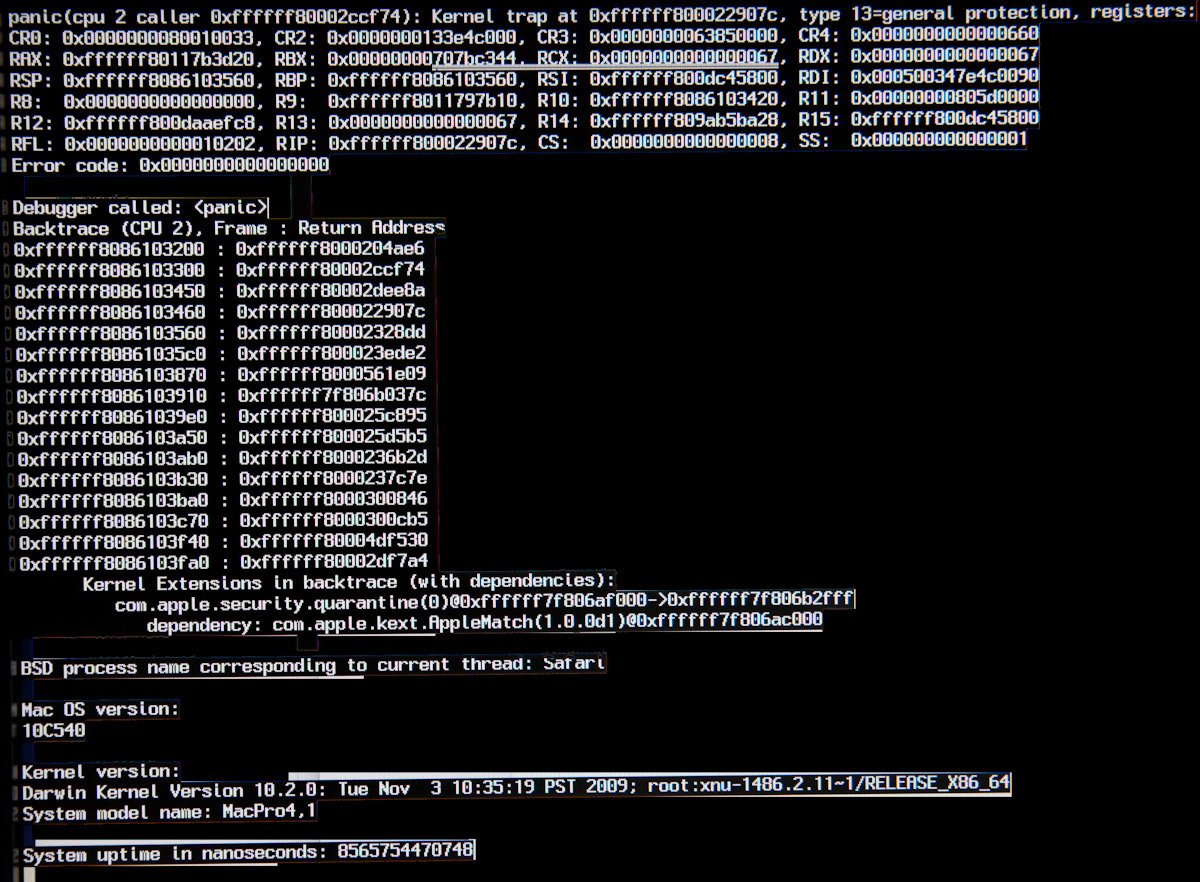

Josvdp Posted January 15, 2010 Share Posted January 15, 2010 Why would native PM cause KPs?That is what Apple hardware uses successfully, as well as Gigabyte, ASUS, etc. hardware using guides such as this one. I don't understand your troubleshooting methodology. You doubt the KPs are a result of incorrect voltages on your over clock, but you don't mention making any voltage adjustments, and haven't mentioned testing at standard clock. I listed a Gigabyte over clocking forum in post 1, you will be able to see what other people use for voltages there. I'm sorry that I annoyed you (or at least confused you). Yes, I understand what native PM is, but my words weren't chosen careful enough. I meant that the KP's might have been caused by me, trying to obtain native PM and not by the native PM itself. Because it should actually cause less KP's. And, yes, my troubleshooting methodology is like an animal on the loose, because I just don't know where to go/what to do. Although, the things you are mentioning (changing Vcore or the OC itself) I had already in the back of my mind. As we speak, I am testing the system without OC so we'll see what happens from now on. Thanks by the way for the Gigabyte forum, I did take a look around on forums for overclocking my combination but that was only on websites in my language. The Gigabyte forum looks promising! Link to comment https://www.insanelymac.com/forum/topic/196771-ga-ex58-and-ga-x58a-dsdt-native-power-management-modifications/page/12/#findComment-1385547 Share on other sites More sharing options...

Josvdp Posted January 15, 2010 Share Posted January 15, 2010 Hi d00d! I totally agree with you that KP's should be a rare phenomenon. In the 3 years that I have had my Macbook Pro, it KP'ed only about twice. So everytime this OSX86 system KP's, there's a small part of my heart that dies . Anyway, as you advised, I took off my OC but this morning when I woke the system from sleep, I got a KP right away (it's attached at the end of the post). This time, it stated something involving iStatMenus. In the beginning, the KP's seemed to be much alike, but this one and the one before are quite different. Even though they are from the same type (13, general protection) I'm still not sure what's causing this. Would you recommend a full reinstall maybe? That would take up loads of precious time, especially since I have everything set and done on my user profile. But if that is what it takes to get to a stable system, then I will do that. Link to comment https://www.insanelymac.com/forum/topic/196771-ga-ex58-and-ga-x58a-dsdt-native-power-management-modifications/page/12/#findComment-1386298 Share on other sites More sharing options...
d00d Posted January 15, 2010 Author Share Posted January 15, 2010 Hi d00d! I totally agree with you that KP's should be a rare phenomenon. In the 3 years that I have had my Macbook Pro, it KP'ed only about twice. So everytime this OSX86 system KP's, there's a small part of my heart that dies . Anyway, as you advised, I took off my OC but this morning when I woke the system from sleep, I got a KP right away (it's attached at the end of the post). This time, it stated something involving iStatMenus. In the beginning, the KP's seemed to be much alike, but this one and the one before are quite different. Even though they are from the same type (13, general protection) I'm still not sure what's causing this. Would you recommend a full reinstall maybe? That would take up loads of precious time, especially since I have everything set and done on my user profile. But if that is what it takes to get to a stable system, then I will do that. Did you use the revised CPU instructions to create your DSDT, or are you using the attached F9m DSDT?There was a problem with KPs after wake with the pre F9m CPU instructions and DSDT, but usually only when booting in 32 bit. Link to comment https://www.insanelymac.com/forum/topic/196771-ga-ex58-and-ga-x58a-dsdt-native-power-management-modifications/page/12/#findComment-1386333 Share on other sites More sharing options...
Josvdp Posted January 15, 2010 Share Posted January 15, 2010 Did you use the revised CPU instructions to create your DSDT, or are you using the attached F9m DSDT?There was a problem with KPs after wake with the pre F9m CPU instructions and DSDT, but usually only when booting in 32 bit. I'm using the attached F9m DSDT with an added modification for step 16 (shutdown and restart, if I'm right). But when I did that, I checked if all the steps in this tutorial were correctly put in. I didn't change anything when it comes to the CPU instructions, so that is very likely to be the cause? We're talking about step 5 of your guide, right? Are the steps in your start post revised or are they in a different post? I didn't manage to properly use 32-bit, I think it was because of KP's after wake. I could maybe start with a fresh DSDT and then redo the steps in your tutorial. But the big question for me is how to get a fresh and untouched DSDT ? I'm going to check now if the CPU instructions (Step 5 (CStates) are put in correctly. update It looks like they are. Just to be clear, I attached my DSDT and I have a i7 920. The CPU CStates are there, although in DSDTSE, the HEX codes look like this: 0x0A65 instead of 0x00000A65. I don't think that should be much of a problem. I must say that I took the attached 9Fm 920 DSDT and then (with DSDT) edited it a few time in order to get step 16 and step 17 working. These steps weren't done yet in the attached DSDT and I wanted shut down/restart to work properly without extra kexts. DSDT.aml.zip Link to comment https://www.insanelymac.com/forum/topic/196771-ga-ex58-and-ga-x58a-dsdt-native-power-management-modifications/page/12/#findComment-1386347 Share on other sites More sharing options...

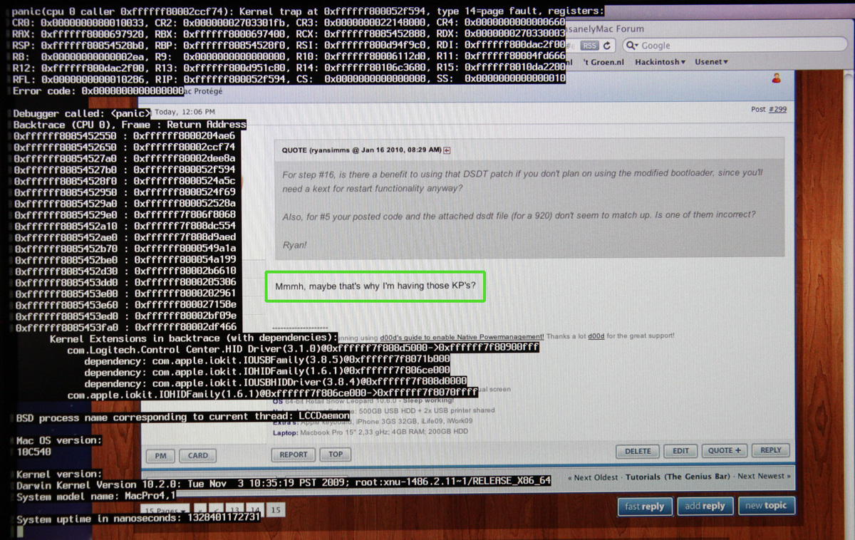

ryansimms Posted January 16, 2010 Share Posted January 16, 2010 For step #16, is there a benefit to using that DSDT patch if you don't plan on using the modified bootloader, since you'll need a kext for restart functionality anyway? Also, for #5 your posted code and the attached dsdt file (for a 920) don't seem to match up. Is one of them incorrect? Ryan! Link to comment https://www.insanelymac.com/forum/topic/196771-ga-ex58-and-ga-x58a-dsdt-native-power-management-modifications/page/12/#findComment-1386532 Share on other sites More sharing options...
Josvdp Posted January 16, 2010 Share Posted January 16, 2010 For step #16, is there a benefit to using that DSDT patch if you don't plan on using the modified bootloader, since you'll need a kext for restart functionality anyway? Also, for #5 your posted code and the attached dsdt file (for a 920) don't seem to match up. Is one of them incorrect? Ryan! Mmmh, maybe that's why I'm having those KP's? Link to comment https://www.insanelymac.com/forum/topic/196771-ga-ex58-and-ga-x58a-dsdt-native-power-management-modifications/page/12/#findComment-1386611 Share on other sites More sharing options...
Josvdp Posted January 16, 2010 Share Posted January 16, 2010 Hehe, is this is rather funny, look at this KP: But, it's not that funny, because KP's really frustrate me. Especially since they seem to happen more often now. I got the KP while in Logitech Control centre, setting the scroll acceleration to "none" gave a KP. This time, it's not of the type "13 general protection" but "14 page fault" which often has to do with memory (if I'm right). I have no overclock at all though! d00d, I'm not sure if you've seen my last post, but I'm really lost in the woods now. I'm thinking of completely rebuilding my DSDT. In order to do that I have to get a fresh DSDT first, because I'm not sure if your attached (920) DSDT is OK, is it? Link to comment https://www.insanelymac.com/forum/topic/196771-ga-ex58-and-ga-x58a-dsdt-native-power-management-modifications/page/12/#findComment-1386634 Share on other sites More sharing options...
