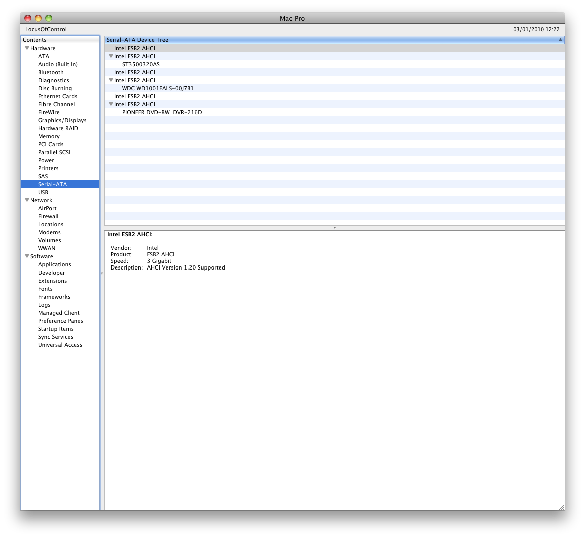

LocusOfControl Posted January 3, 2010 Share Posted January 3, 2010 Here is what I currently use without JMicron but with PICM/PICF still in Seems to work without problem, the previous version was a delta on this I would add that if people use this without thinking... I removed all the IDE 1 & 2 and changed to SATA It is not specifying ICH10® but ESB2 (you don't need a kext for orange icons) Some people claim it causes Seagate HD's to die, but I'm using WD - not caused me any problems It includes the DSDT fix so you don't need EvoReboot or OpenHaltRestart kexts (restart doesn't work without the hacked RC4 boot file though) I think Firewire may have got moved to the wrong place, haven't got around to putting it back Link to comment https://www.insanelymac.com/forum/topic/196771-ga-ex58-and-ga-x58a-dsdt-native-power-management-modifications/page/8/#findComment-1375654 Share on other sites More sharing options...
