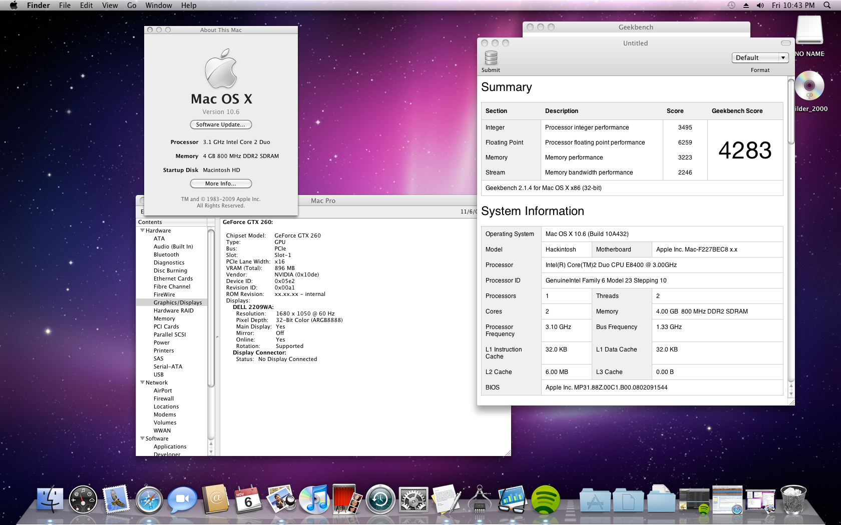

emilp Posted November 6, 2009 Share Posted November 6, 2009 Mrjanek, a big thanks to you! Another successful install for the records. I was really surprised when I didn't have to bother with any special drivers for my GTX 260, works seemingly without any issues. I'm curious. If you don't mind, could you perhaps do a rundown for the tech savvy users of your installer. What is used and what is not. I mean, most other guides go into much more detail using platform UUID's, EFI graphics strings and what not. Perhaps the graphics enabler takes care of all this, if your lucky? In any event, thanks a million. I owe you a beer /e Link to comment https://www.insanelymac.com/forum/topic/195248-kakewalk-minimal-effort-install-ep45-ex58-p55-g41/page/3/#findComment-1322198 Share on other sites More sharing options...

mrjanek Posted November 9, 2009 Author Share Posted November 9, 2009 Mrjanek, a big thanks to you! Another successful install for the records. I was really surprised when I didn't have to bother with any special drivers for my GTX 260, works seemingly without any issues. I'm curious. If you don't mind, could you perhaps do a rundown for the tech savvy users of your installer. What is used and what is not. I mean, most other guides go into much more detail using platform UUID's, EFI graphics strings and what not. Perhaps the graphics enabler takes care of all this, if your lucky? In any event, thanks a million. I owe you a beer /e Sure, I'll do a brief rundown of what's included DSDT.aml - This has been patched with the basics HPET, RTC, etc. It has also been patched to enable sound and "Graphics Enabler". PCEFI bootloader is included. The package makes use of the Graphics Enabler option to autodetect the graphics card and pass on the information gathered to Snow Leopard. KEXTs - JMicronATA to be able to use P-ATA devices, LegacyHDA for enabling sound, PlatformUUID with a preset UUID, Realtek1000SL driver with 64-bit support and Bonjour That's it basically. I'm glad people find this install package useful Thanks! I will be posting a new version soon (today). The difference with that one is that you don't have to run "Post-Install Fixes" after installing Snow Leopard. Instead it will be a package included in the Snow Leopard installation (eg. Customize -> X11). This will make the installation even easier and cleaner! mrjanek, great post and instructions thanks. I have got everything perfect except for sleep. I can manually put the machine to sleep but if I set it to sleep on the energy saver preference after say, 5 minutes, the display goes off but the machine doesn't sleep. I would be grateful for any ideas. Many thanks in advance! Strange.. sleep is working just fine here. Have you set up BIOS properly? Link to comment https://www.insanelymac.com/forum/topic/195248-kakewalk-minimal-effort-install-ep45-ex58-p55-g41/page/3/#findComment-1324394 Share on other sites More sharing options...
