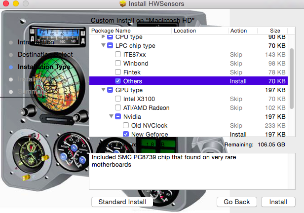

Darkened Posted January 5, 2015 Share Posted January 5, 2015 10.10.1 AppleGraphicsPowerManagement Update . Added device id by replacing GFX0, removed IGPU section. Two states when on power, Three states when on battery as as experimented and concluded few posts above by me and immo. I'm using latest FakeSMC of Kozlek (HW Sensors) Branch. and latest Nvidia web driver - http://www.nvidia.com/download/driverResults.aspx/80070/en-us Note two graphics control kexts loaded are : com.apple.driver.AGPM (100.14.37) <114 89 72 71 12 5 4 3> com.apple.AppleGraphicsDeviceControl (3.7.21) <7 6 5 4 3 1> Attached : AppleGraphicsPowerManagement.kext (V:100.14.37) AppleGraphicsPowerManagement.kext.zip Changing the device id to your GPU device id should be enough for most of you here. ------------------------------------------------------------------------------------------------------ Hello indiandragon, would this updated kext work on Mavericks, or should we stick with the older kext? Chris Link to comment Share on other sites More sharing options...

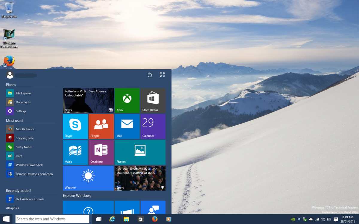

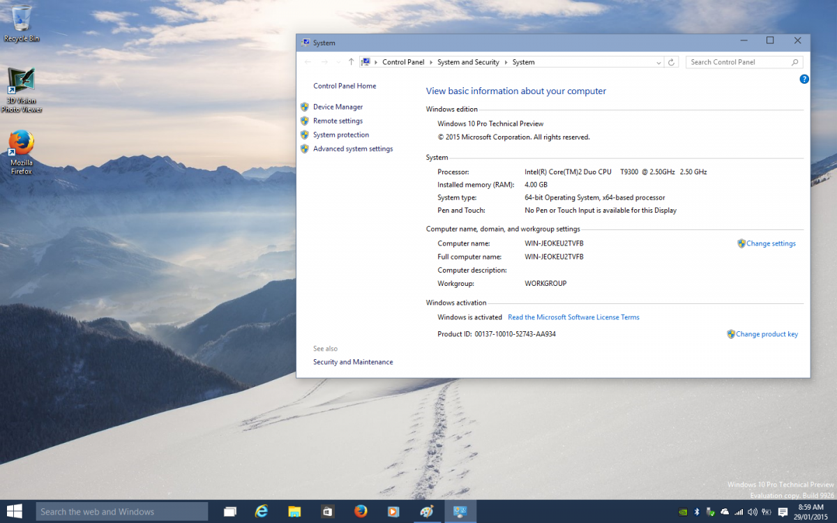

fusion71au Posted January 7, 2015 Share Posted January 7, 2015 @redcoatd, Most likely you have a setting in your config.plist that is hiding bootx64.efi. The workaround is to copy bootmgfw.efi into the /efi/microsoft/boot folder of your Windows Installer USB (named WIN in the screenshots below). 1. Rename cdboot.efi in WIN/efi/microsoft/boot folder to cdboot.BAK 2. Copy bootmgfw.efi into WIN/efi/microsoft/boot 3. Reboot the computer with the Installer USB and select "Boot Microsoft EFI boot menu from WIN", then press <spacebar> 4. Select "Run bootmgfw.efi" and then press <spacebar> ---> should now boot into the UEFI Windows Installer! ___________________________________________________________________________________________________________________ Re sleep issues and post install on your XPS 8300 - Obviously not owning your machine, I can't provide specific help and it is really off topic in this thread. Nevertheless, for a start, I recommend you do some extra reading.... AIO guides to hackintosh (read sections on speed stepping, DSDT/SSDT) Power management for Sandy/Ivy Bridge/Haswell CPUs Google "Toleda OSX Power Management" for his guide on Voldemort's forum Google "OSX on XPS 8300" and see what others have done to configure their systems Good luck! Link to comment Share on other sites More sharing options...
redcoatd Posted January 7, 2015 Share Posted January 7, 2015 @redcoatd, Most likely you have a setting in your config.plist that is hiding bootx64.efi. The workaround is to copy bootmgfw.efi into the /efi/microsoft/boot folder of your Windows Installer USB (named WIN in the screenshots below). 1. Rename cdboot.efi in WIN/efi/microsoft/boot folder to cdboot.BAK 2. Copy bootmgfw.efi into WIN/efi/microsoft/boot 3. Reboot the computer with the Installer USB and select "Boot Microsoft EFI boot menu from WIN", then press <spacebar> 4. Select "Run bootmgfw.efi" and then press <spacebar> ---> should now boot into the UEFI Windows Installer! @fusion71au - you rock! I tried numerous permutations of that, but with no success. Thanks!! By the way, do you have any experience turning a Dell XPS 8300 into a hackintosh, and overcoming sleep issues? Where would I start? cheers David Link to comment Share on other sites More sharing options...

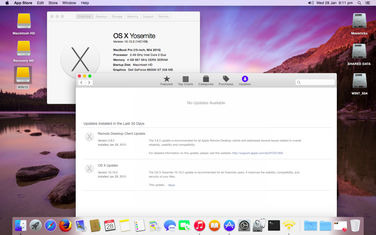

fusion71au Posted January 29, 2015 Share Posted January 29, 2015 Hi guys, Just wanted to report a troublefree experience with the latest updates to Yosemite and Mavericks from the App Store: Mavericks Security Update 2015-001 Yosemite 10.10.2 No user intervention was required on my part and everything is still working as before on both 10.9.5 and 10.10.2 (using Clover r3094 and VoodooHDA for audio). For the XPS M1530, invoking sleep a second time still triggers a reboot in Yosemite unfortunately.... I also installed the Windows 10 technical preview on my external USB hard drive and it works quite well in UEFI mode booted through Clover. For those interested in trying it out, link here. 1 Link to comment Share on other sites More sharing options...

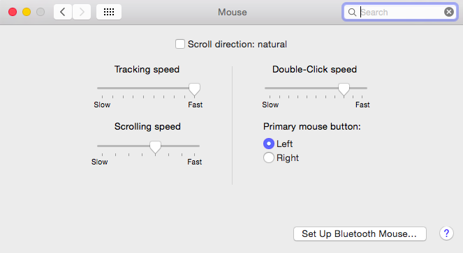

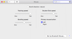

fusion71au Posted February 1, 2015 Share Posted February 1, 2015 @manbear67, What third party kexts have you installed and what versions? eg type in terminal kextstat | grep -v com.apple and post the results (maybe a conflict?). Audio works well here with HDADisabler and VoodooHDA v2.8.4 or 2.8.7 installed in /S/L/E. For the mouse/trackpad, I have tried VoodooPS2controller v1.1.0 and also v1.8.9 (for Alps in Hackintosh Vietnam Tool) and both are OK. Have you tried adjusting the tracking and scrolling speeds in the mouse prefpane? Have you installed HWSensors to monitor CPU/GPU freqencies/temps and what values are being reported? iStat Menus v4.2.2 is also good for monitoring CPU & memory load. The T9300 is a Penryn so bus speed is detected correctly and automatically - you shouldn't need to change anything from default in the config.plist. Result of Clover's autodetection of CPU and Bus Speed from boot log looks like below for my T9300... $ bdmesg | grep CPU5:440 0:000 CPU Vendor = 756E6547 Model=106765:440 0:000 The CPU supported turbo5:440 0:000 BrandString = Intel® Core2 Duo CPU T9300 @ 2.50GHz5:440 0:000 CPU: 2500 MHz9:787 0:000 Finally: Bus=199451kHz CPU=2493MHz9:787 0:000 AICPUPM: n9:787 0:000 FakeCPUID: 0x09:974 0:000 first CPU found at 1095 offset 10989:974 0:000 Found ACPI CPU: CPU0 And CPU19:979 0:004 CPUBase=0 and ApicCPUBase=0 ApicCPUNum=29:979 0:000 SSDT with CPU P-States generated successfully9:979 0:000 SSDT with CPU C-States generated successfully5:440 0:000 CPU: 2500 MHz Edit Here is a link to known working kexts for the XPS M1530 courtesy of @DarwinX post#1641: Dell XPS M1530 - 01.2014 (10.8.x - 10.9.x).zip Install with the latest kext wizard, repair permissions, update system caches etc. Further troubleshooting can be done by looking at error messages appearing in console if the laggy mouse/audio occurs.... Link to comment Share on other sites More sharing options...
