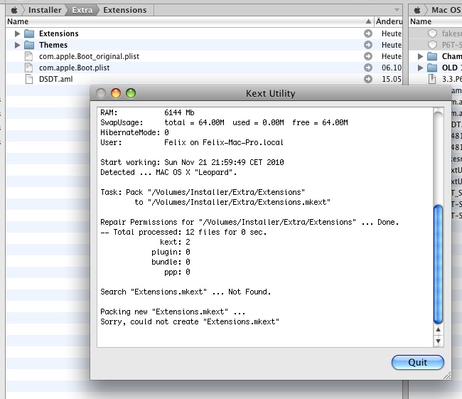

Multisaft Posted November 21, 2010 Share Posted November 21, 2010 does anyone fixed this small problem before me (see screene)? i like to update my old 10.5.7 x86 to 10.6.5 done the steps until the kext utility should create the extensions.mkext cache - screenshot see below. in past times - when we installed 10.5.7 - we've downloaded the update-file (comboupdate) from apple and installed it from another os-x installation. does this works with this guide too? can i dl the 10.6.5 update file and install it on the flash-drive before i run chameleon etc.? Link to comment https://www.insanelymac.com/forum/topic/189052-asus-p6t-se-retail-snow-leopard-installation-guide-flashdrive-updated-jun-28/page/43/#findComment-1588773 Share on other sites More sharing options...

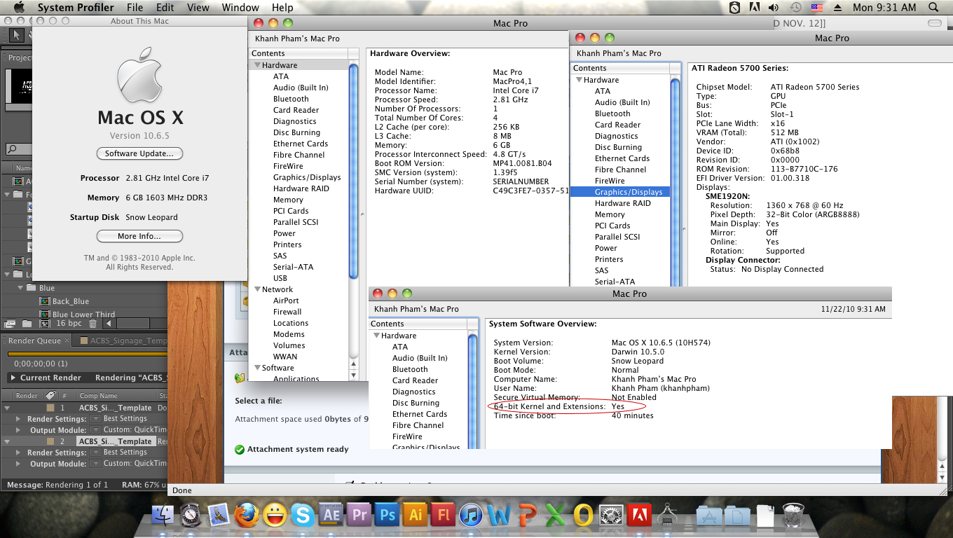

Becks Pham Posted November 22, 2010 Share Posted November 22, 2010 I think my problem is the Graphic card not playing ball. I used the most recent build of Chameleon and used teh GraphicsEnabler=No option and booted with the disk, managed to get to the OSX install option, have formatted drive and am installing right now while I post this message, hoping it should go through ok. Will update on how things evolve from here @Jemmyuk : your build will successfully work ! 1. Your screen go blank because the ATI 5770 doesn't work with 64bit when you installing the OS, so why you have to use GraphicsEnabler=No while booting by the Chameleon. 2. Here is the solution. You have to use these method when booting GraphicsEnabler=No arch=i386 Explaination : 2 method above will make you boot with 32bit mode and you won't get blank screen. 3. Follow step by step in the first post, using DSDT and P6T-SE.kext from iFabio. You should install from USB Flash Drive (it's fast and easier but you have to build the USB from a working Mac OS X) Try yourself ! PS: I'll post my guide with my PC using P6T SE and ATI 5770 (both working with 64bit). Here is my working Mac OS 10.6.5 (see my build in signature) Link to comment https://www.insanelymac.com/forum/topic/189052-asus-p6t-se-retail-snow-leopard-installation-guide-flashdrive-updated-jun-28/page/43/#findComment-1588928 Share on other sites More sharing options...
Multisaft Posted November 22, 2010 Share Posted November 22, 2010 No. I tried that, and you can't update the installation USB with the update installer. ok so i need to use the update function inside my fresh os x installation i guess? and can you or anyone else help me with the other problem i have? the not builded extensions.mkext file from kext utility? is it because i've formated my installer-flash-drive with journaled HFS+ ? fixed it - done the whole steps again, now kext utility worked fine 2nd problem: my usb-apple-keyboard is not working until i've bootet into my 10.5.7 installation. cannot access the bios or use boot-options when chameleon is starting up. do i need a normal windows-usb-keyboard? k you need a windows-usb-keyboard. 3rd question/problem: kext for gtx260 - do i need to edit my boot.plist like in 10.5.7 or do we have a nice kext that is doing the whole opengl, quarz-extreme, core-image etc. game? Link to comment https://www.insanelymac.com/forum/topic/189052-asus-p6t-se-retail-snow-leopard-installation-guide-flashdrive-updated-jun-28/page/43/#findComment-1589118 Share on other sites More sharing options...

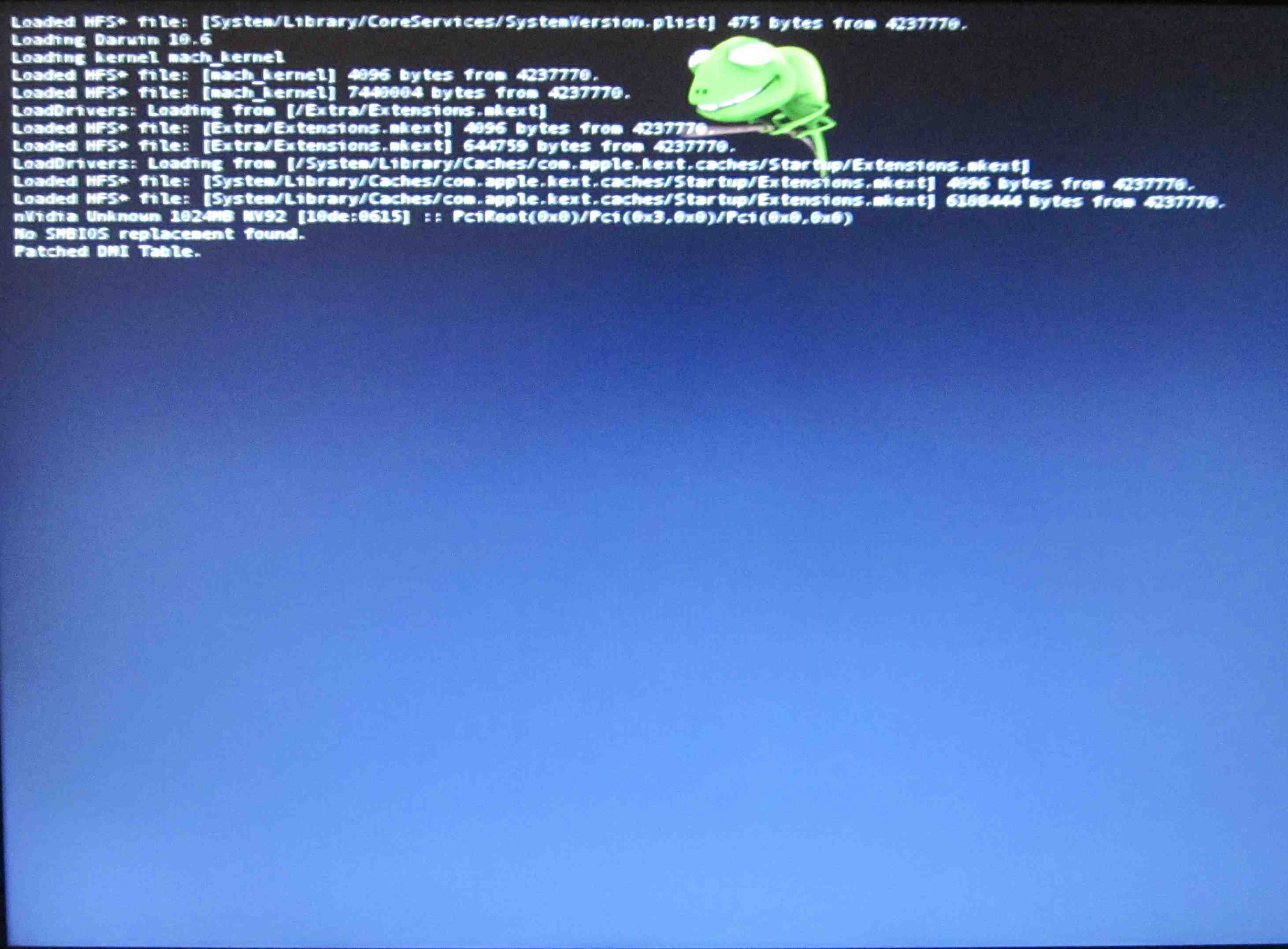

GeorgeKaplan Posted November 25, 2010 Share Posted November 25, 2010 oh dear. just upgraded to 10.6.5 as thought it was safe but getting Uploaded with ImageShack.us any ideas? Link to comment https://www.insanelymac.com/forum/topic/189052-asus-p6t-se-retail-snow-leopard-installation-guide-flashdrive-updated-jun-28/page/43/#findComment-1591101 Share on other sites More sharing options...

tweak41 Posted November 25, 2010 Author Share Posted November 25, 2010 oh dear.just upgraded to 10.6.5 as thought it was safe but getting ... any ideas? Yeah George, you need to delete AppleHDA from S/L/E. You can do this from command line by booting with -s Just do rm -r /System/Library/Extensions/AppleHDA.kext Link to comment https://www.insanelymac.com/forum/topic/189052-asus-p6t-se-retail-snow-leopard-installation-guide-flashdrive-updated-jun-28/page/43/#findComment-1591303 Share on other sites More sharing options...
