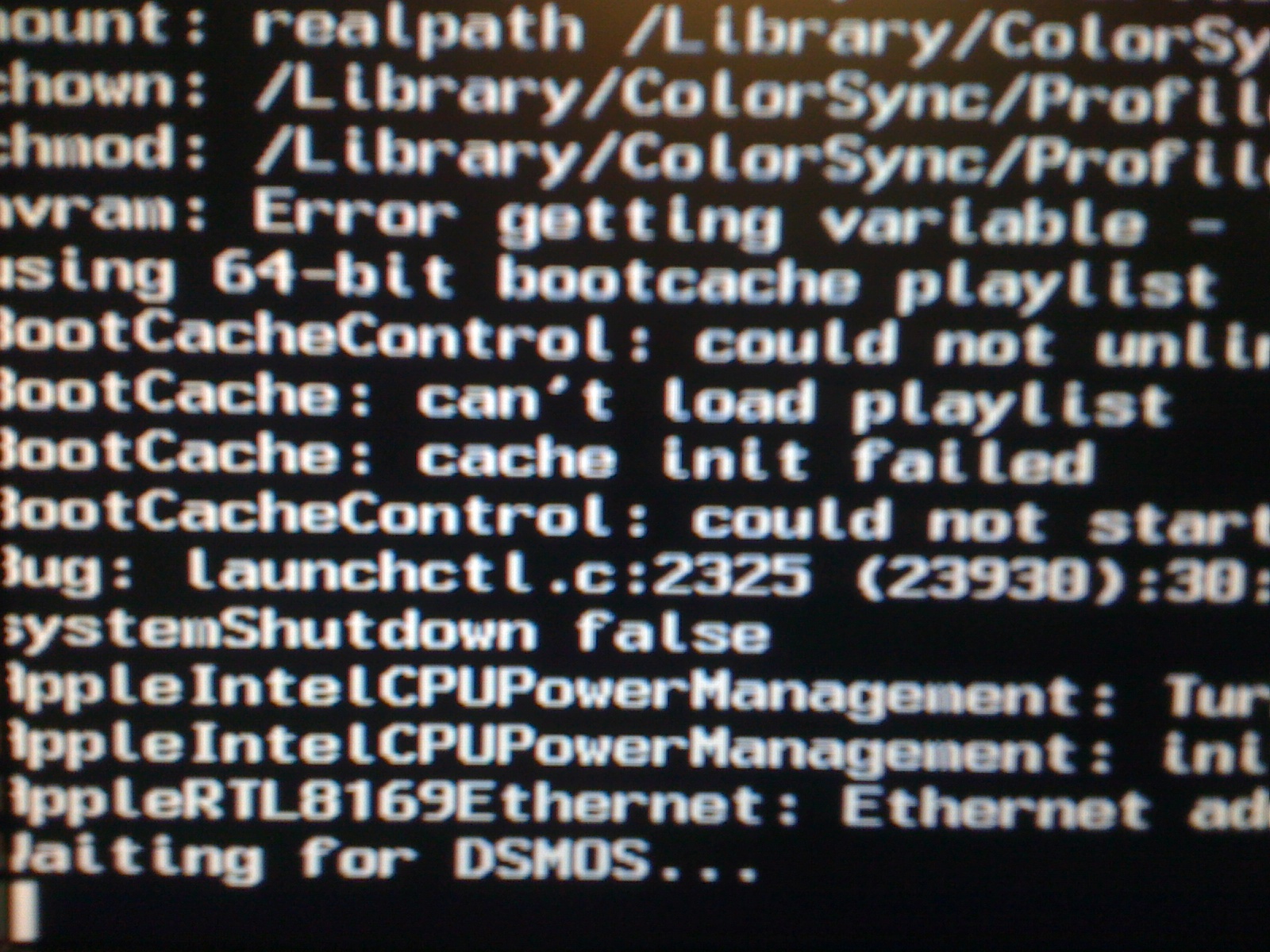

paravorheim Posted October 14, 2010 Share Posted October 14, 2010 Read it again and look at the picture carefully. I told you that you have to create the Extensions folder and place the kexts inside that. Okay, then I did what you said the first time. However, I'm stuck at "Waiting for DSMOS..." I'm going to retry the instructions once I get a hold of my friend's mac again, which will be within an hour or so. I'll report back when I'm done with that. Link to comment https://www.insanelymac.com/forum/topic/189052-asus-p6t-se-retail-snow-leopard-installation-guide-flashdrive-updated-jun-28/page/40/#findComment-1564663 Share on other sites More sharing options...
paravorheim Posted October 15, 2010 Share Posted October 15, 2010 So, I tried it again from scratch, and it looks like it all worked, except I'm still stuck at the "Waiting for DSMOS..." part when I go -v. Why does DSMOS do that? Is it a hardware issue, or something wrong with the kexts? I don't think it's graphics related as when I did not go into -v, the apple logo popped up just fine and the wheel was spinning...Anyways...Can anyone make sense of this? Here's a pic: Link to comment https://www.insanelymac.com/forum/topic/189052-asus-p6t-se-retail-snow-leopard-installation-guide-flashdrive-updated-jun-28/page/40/#findComment-1564718 Share on other sites More sharing options...
tweak41 Posted October 15, 2010 Author Share Posted October 15, 2010 So, I tried it again from scratch, and it looks like it all worked, except I'm still stuck at the "Waiting for DSMOS..." part when I go -v. Why does DSMOS do that? Is it a hardware issue, or something wrong with the kexts? I don't think it's graphics related as when I did not go into -v, the apple logo popped up just fine and the wheel was spinning...Anyways...Can anyone make sense of this? Here's a pic: That's what the FakeSMC kext is for. Link to comment https://www.insanelymac.com/forum/topic/189052-asus-p6t-se-retail-snow-leopard-installation-guide-flashdrive-updated-jun-28/page/40/#findComment-1564758 Share on other sites More sharing options...
paravorheim Posted October 15, 2010 Share Posted October 15, 2010 That's what the FakeSMC kext is for. FakeSMC is in my Extra/Extensions folder, and Kext Utility worked without a hiccup. I also thought that was the problem after looking it up, but it doesn't work with it. So should Kext Utility be in the EDIT: Utilities Folder, or is it okay to be anywhere on the Mac? I just left the app in my downloads folder, so that could be the problem...But I doubt it. What if I took FakeSMC out? What are the disadvantages of doing this? Link to comment https://www.insanelymac.com/forum/topic/189052-asus-p6t-se-retail-snow-leopard-installation-guide-flashdrive-updated-jun-28/page/40/#findComment-1565049 Share on other sites More sharing options...

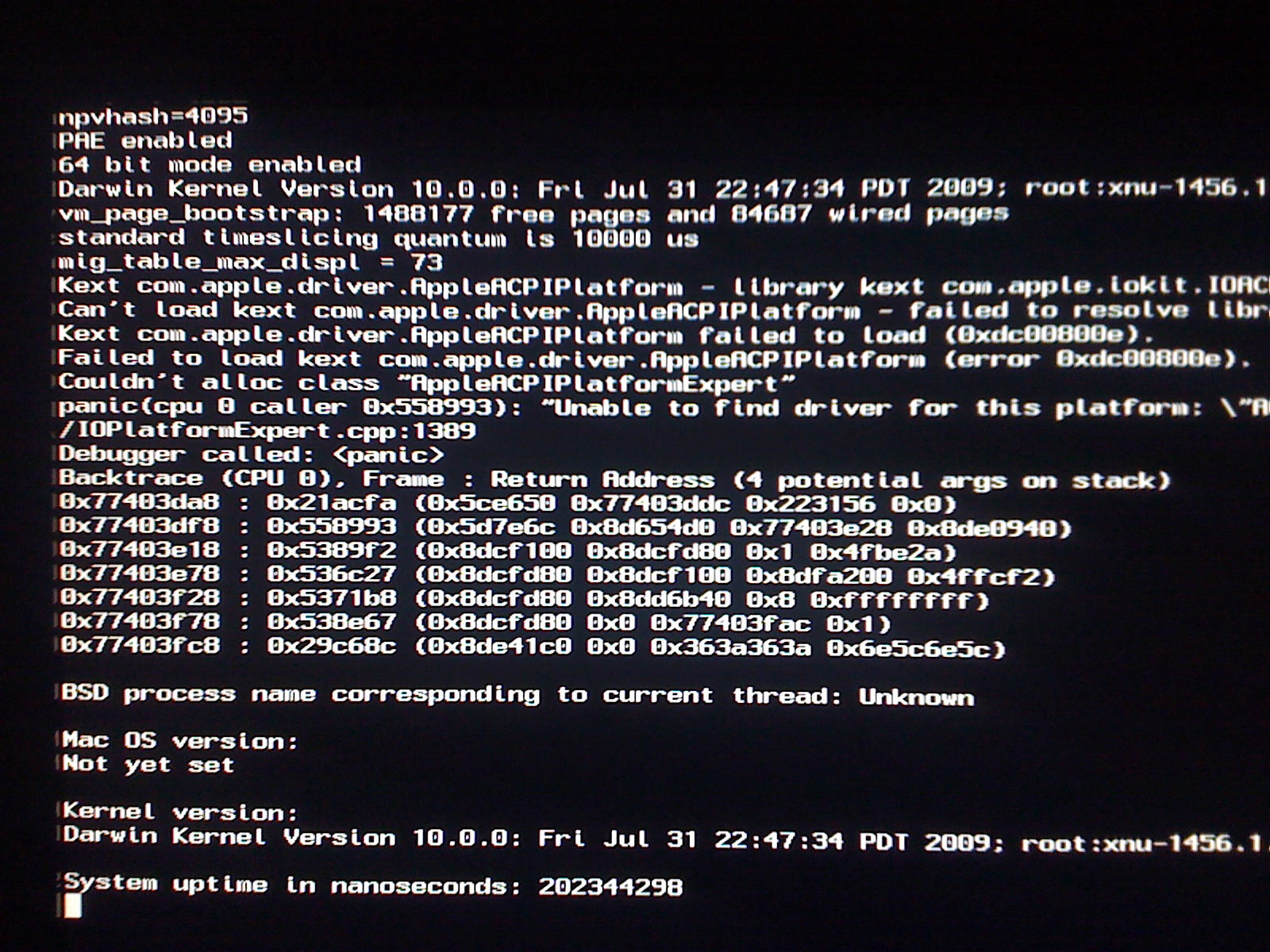

paravorheim Posted October 15, 2010 Share Posted October 15, 2010 Just tried booting with -v -f, I get a kernel panic. I also get a kernel panic when I boot with -x. Here's a picture of -v -f: Now I'm starting to think that my image is messed up. I'll see if it works with my friend's disc. Link to comment https://www.insanelymac.com/forum/topic/189052-asus-p6t-se-retail-snow-leopard-installation-guide-flashdrive-updated-jun-28/page/40/#findComment-1565120 Share on other sites More sharing options...

tweak41 Posted October 16, 2010 Author Share Posted October 16, 2010 Now I'm starting to think that my image is messed up. I'll see if it works with my friend's disc. That's possible. I've used two different images, my 10.6 disc, and a 10.6.3. Both worked flawlessly. I've done this process a number of times now to make sure I'm not missing any steps. Hi All, I've usdated my P6t WS Pro to 10.6.4. No extra anything yet. Now I'm trying to get my ATI 5770 to work. Every time I try to install the Gaphics Update 1.0 I get a kernel Panic and the install is destroyed. Does anyone know how to get my ATI 5770 to work with this install method? I've tried most boot loaders that support my video card and they give me the not a Mac sign on boot. Anyone have any idea what's going on here? Thanks Brandon Check out netkas.org for info on that card. Link to comment https://www.insanelymac.com/forum/topic/189052-asus-p6t-se-retail-snow-leopard-installation-guide-flashdrive-updated-jun-28/page/40/#findComment-1565142 Share on other sites More sharing options...

paravorheim Posted October 18, 2010 Share Posted October 18, 2010 Can you tell me your non-vanilla kexts list (EXTRA and System)? now I can only tell you to delete cache in S/L/E and remake cache in E/E. I recommend to use last version of chameleon rc5, remove smbios and use iFabio bsdt. There are other ways but i'm sure that is right The only two kexts I have that are non-vanilla are FakeSMC and P6T-SE. I literally followed the exact same steps as the updated guide. Link to comment https://www.insanelymac.com/forum/topic/189052-asus-p6t-se-retail-snow-leopard-installation-guide-flashdrive-updated-jun-28/page/40/#findComment-1565953 Share on other sites More sharing options...
tweak41 Posted October 18, 2010 Author Share Posted October 18, 2010 The only two kexts I have that are non-vanilla are FakeSMC and P6T-SE. I literally followed the exact same steps as the updated guide. I'm not sure what to tell you. Reset your BIOS completely, set your SATA discs to AHCI, and try again... Maybe you need another flash drive? I doubt this though. Are you using a real retail disc that you bought? I'm not saying this is necessary, but if you have a bad image there's not much we can do for you. If you've got any weird hardware attached, it would be wise to remove it during installation. Lastly, there's no need to boot with -f or -x. Link to comment https://www.insanelymac.com/forum/topic/189052-asus-p6t-se-retail-snow-leopard-installation-guide-flashdrive-updated-jun-28/page/40/#findComment-1566033 Share on other sites More sharing options...

ytrox Posted October 20, 2010 Share Posted October 20, 2010 The only two kexts I have that are non-vanilla are FakeSMC and P6T-SE. I literally followed the exact same steps as the updated guide. Can you post your hardware configuration please http://www.insanelymac.com/forum/index.php...rCP&CODE=22 the problem seems to be in the bios, but if you give me your Extra folder i can watch it in a few seconds Link to comment https://www.insanelymac.com/forum/topic/189052-asus-p6t-se-retail-snow-leopard-installation-guide-flashdrive-updated-jun-28/page/40/#findComment-1567109 Share on other sites More sharing options...
paravorheim Posted October 25, 2010 Share Posted October 25, 2010 So, I figured out the culprit, and as always, it's my freaking graphics card. Why doesn't my specific model of radeon 4850 not ever work when doing this hackintosh method? Ugh. Anyways, I had to follow the instructions tweak linked to me a long time ago, and that fixed those errors. However, once I install the OS again, I'll have to redo everything I did to get QE/CI working again. What a pain -.-. Link to comment https://www.insanelymac.com/forum/topic/189052-asus-p6t-se-retail-snow-leopard-installation-guide-flashdrive-updated-jun-28/page/40/#findComment-1570096 Share on other sites More sharing options...
