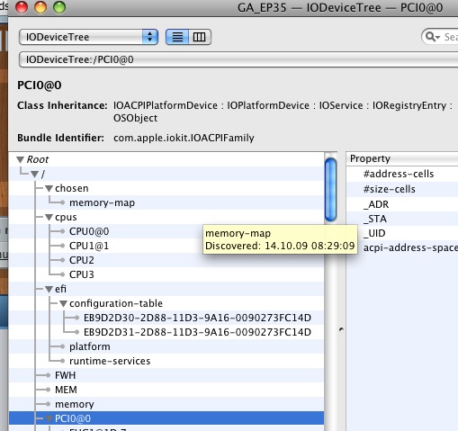

AppleIIGuy Posted October 14, 2009 Share Posted October 14, 2009 To find you pciroot value, use this osx terminal command:ioreg -l | grep -15 “AppleACPIPCI\ ” | grep UID That doesn't return me anything. I get Last login: Tue Oct 13 20:51:46 on ttys000 HTPC-2:~ appleiiguy$ ioreg -l | grep -15 “AppleACPIPCI\ ” | grep UID HTPC-2:~ appleiiguy$ Link to comment https://www.insanelymac.com/forum/topic/187870-pc-efi-v103-released-by-netkas/page/2/#findComment-1297887 Share on other sites More sharing options...
mitch_de Posted October 14, 2009 Share Posted October 14, 2009 You will find 0 or 1 for PCI root also using the IOREGISTRY EXPLORER, select IODevice tree and look for PCI. Attached my GA-EP35 - i have PCI 0 - so i need an patched EFI PC version (default pci 0) or must use -pci0 with orig. version. HINT: New version 10.4 out, also patched here. Look at the 10.4 thread. Link to comment https://www.insanelymac.com/forum/topic/187870-pc-efi-v103-released-by-netkas/page/2/#findComment-1297977 Share on other sites More sharing options...
