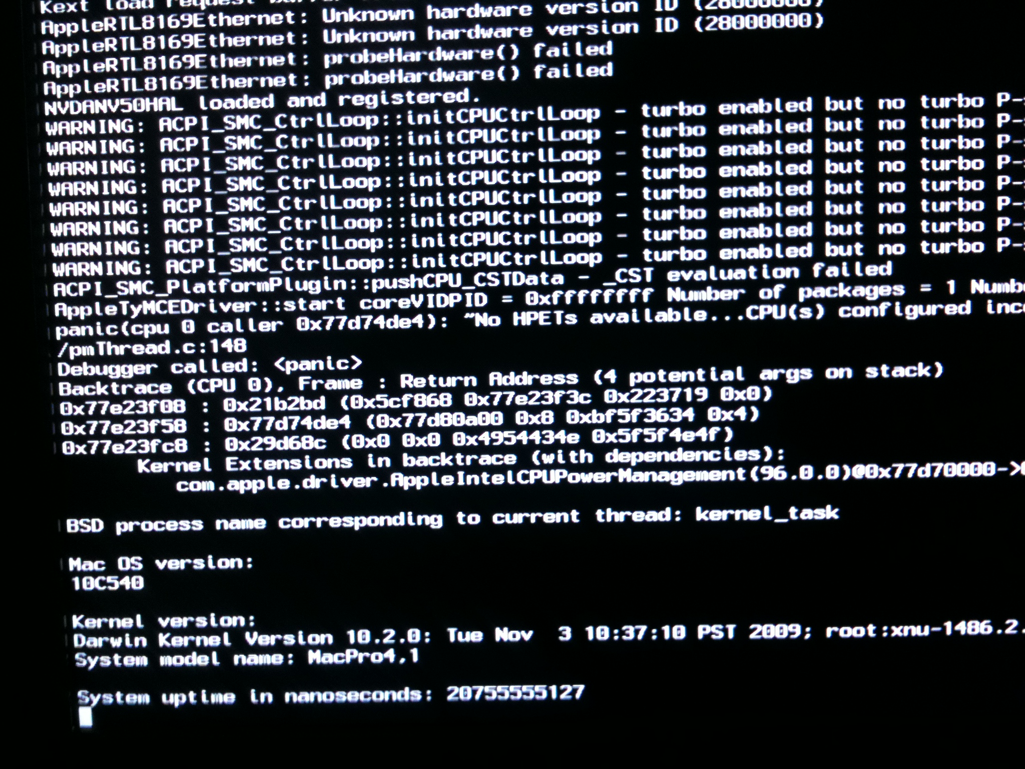

tonik23 Posted December 14, 2009 Share Posted December 14, 2009 hey guys, Thanks to DD and CruisAr for their support. I'm still having issues with KP after i install combo update 10.6.2. I even followed CruisAr's mini guide it still fails. I removed dmos and the old sleepenable.kext and added FakeSMC. but still fails. what am I doing wrong ? Link to comment https://www.insanelymac.com/forum/topic/185097-guide-scripted-yosemitemavericks-install-on-gigabyte-mobos/page/54/#findComment-1358949 Share on other sites More sharing options...

CruiSAr Posted December 14, 2009 Share Posted December 14, 2009 hey guys, Thanks to DD and CruisAr for their support. I'm still having issues with KP after i install combo update 10.6.2. I even followed CruisAr's mini guide it still fails. I removed dmos and the old sleepenable.kext and added FakeSMC. but still fails. what am I doing wrong ? Ok....do u have NullCPUPowerManagement.kext installed to /extra folder? Can't shutdown my computer from the apple menu yet. I get a kernal panic. Tried using OpenHaltRestart and EvoReboot separately in /S/L/E normal build but still the same result. Also see SystemShutdown = False in verbose during boot. Not a big deal for me since I almost always use sleep. Are you using standard DSDT with only CMOS Restet fix or you have a customised patched DSDT? Just wanted to say that i downloaded the new version of the boot cd and that my system can succesfully boot from that CD . Thanks Cruisar! Thats good to hear, I will update the guide with this version of the BootCD as well. WIll upload them to my own server so people wouldnt have to go through all that Rapidshare {censored}. Link to comment https://www.insanelymac.com/forum/topic/185097-guide-scripted-yosemitemavericks-install-on-gigabyte-mobos/page/54/#findComment-1359133 Share on other sites More sharing options...

tonik23 Posted December 15, 2009 Share Posted December 15, 2009 Ok....do u have NullCPUPowerManagement.kext installed to /extra folder? Are you using standard DSDT with only CMOS Restet fix or you have a customised patched DSDT? Hi CruisAr, Yes I have the NullCPUPowerManagement.kext in Extra/stored_kexts Im using the DSDT that was included in the script. Link to comment https://www.insanelymac.com/forum/topic/185097-guide-scripted-yosemitemavericks-install-on-gigabyte-mobos/page/54/#findComment-1359662 Share on other sites More sharing options...

CruiSAr Posted December 15, 2009 Share Posted December 15, 2009 Hi CruisAr, Yes I have the NullCPUPowerManagement.kext in Extra/stored_kexts Im using the DSDT that was included in the script. Ok weird, The panic you are having backtraces to AppleIntelCPUPowermanagement. I also see that HPETS are not avialable. This kind of error according to my experience is DSDT related and It requires fixing HPET, TMR and RTC in your DSDT thus me asking if you have a customised patched DSDT. What you can try to do is reset your bios and then edit it so your system can boot. If that doesnt fix the problem try the DSDT I attached in my guide. Let me know how it goes. Link to comment https://www.insanelymac.com/forum/topic/185097-guide-scripted-yosemitemavericks-install-on-gigabyte-mobos/page/54/#findComment-1360028 Share on other sites More sharing options...
Josvdp Posted December 15, 2009 Share Posted December 15, 2009 Ok weird, The panic you are having backtraces to AppleIntelCPUPowermanagement. I also see that HPETS are not avialable. This kind of error according to my experience is DSDT related and It requires fixing HPET, TMR and RTC in your DSDT thus me asking if you have a customised patched DSDT. What you can try to do is reset your bios and then edit it so your system can boot. If that doesnt fix the problem try the DSDT I attached in my guide. Let me know how it goes. I'm pretty sure that what I'm about to say isn't a solution, but I had the same kernel panic yesterday after a fresh install (with the "no HPETs available...CPU(s) configured incorrectly"). In my case, it was due to the fact that I did install the right kexts, but I didn't update boot caches. CrueSAr, while you're already here, could you take a look at my issue? It's a few posts up and I still didn't manage to fix it. Link to comment https://www.insanelymac.com/forum/topic/185097-guide-scripted-yosemitemavericks-install-on-gigabyte-mobos/page/54/#findComment-1360062 Share on other sites More sharing options...
