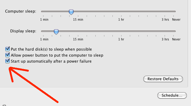

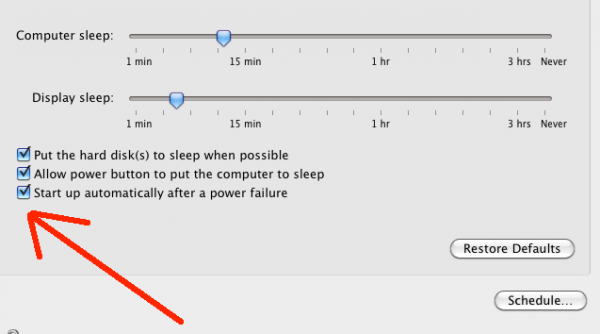

edit; if you are testing sleep, don't forget to tick the 'start up automatically after a power failure'

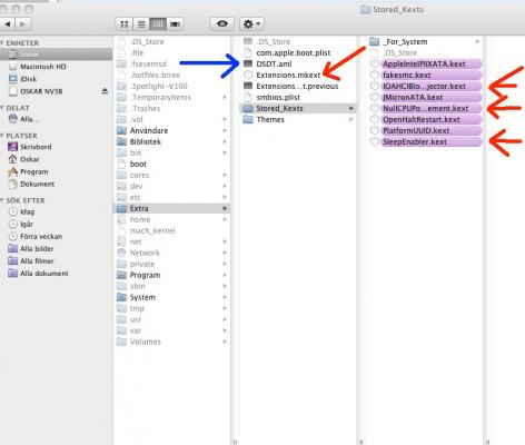

This is how it looks
http://piclair.com/data/qtcgd.jpg[/img

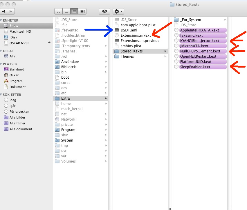

I think im using PC-EFI... at least I did download the PC EFI boot file and put it on my root.
Ok, backup and remove the Red
backup and replace dsdt.aml blue

Should I rebuild cache after doing this?
No rebuild

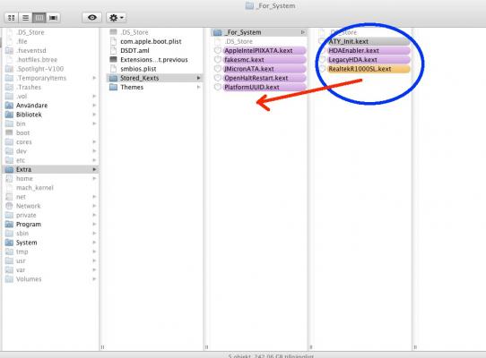

btw where is your audio (use attached for working audio)
put audio in stored_kext
T
btw if you need appleintelpIiiata.kext and jmicron.kext for ide ata, then leave it there

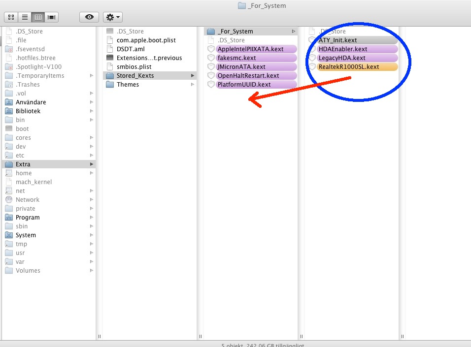

The audio is in the For_system folder
Should I remove them and use yours in Stored_kexts?
see my previous edited post

make one other image of kext folder before reboot
T

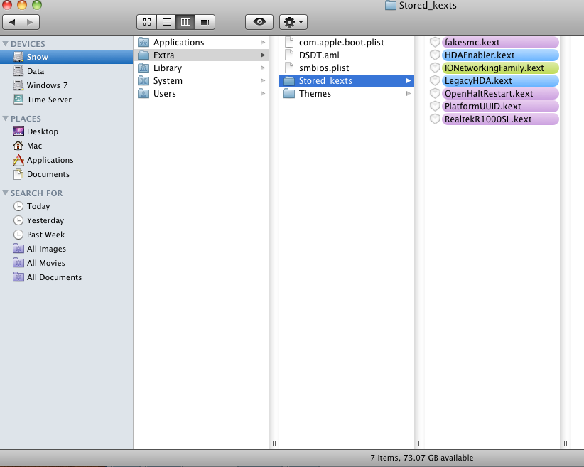

Move these kext from "for_system > stored_kexts
T
yup I did that except of Aty init.
So my Stored_kexts looked exactly like yours, but I kept for_system folder with only aty init inside.
rebbooted and got this:
everything is normal except the last line where it stucks..
thoughts?? :(

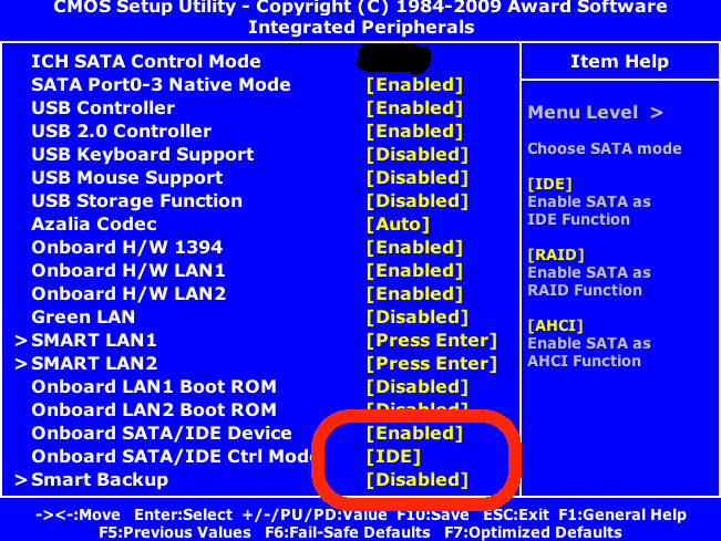

edit; can you check your bios and disable sata/ide

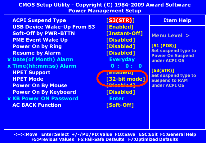

also is the hpet on 64-bit?

I had removed the appleintelpata and jmicron.
The onboard sata/ide CTRL Mode is set to ACHI i believe.
Should I disable "Onboard sata/ide device" ?
hpet is set to 32bit

there are not many people with this error, so finding the fault is a bit tricky
yes disable "Onboard sata/ide device"

Hpet should be on 64-bit

put hpet 64, and removed arch from plist, still same {censored} ;<

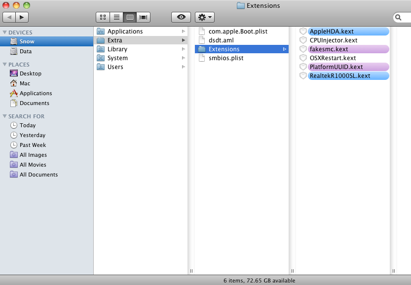

Nice work Bchemist. Are there any kexts in /Extra needed next to this dsdt hacks? If yes, which?
The kexts i'm using now to have a working system are these:
- ALC889a.kext
- fakesmc.kext
- IOAHCIBlockStorageInjector.kext
- IONetworkingFamily.kext
- NullCPUPowerManagement.kext
- OpenHaltRestart.kext
Thanks
