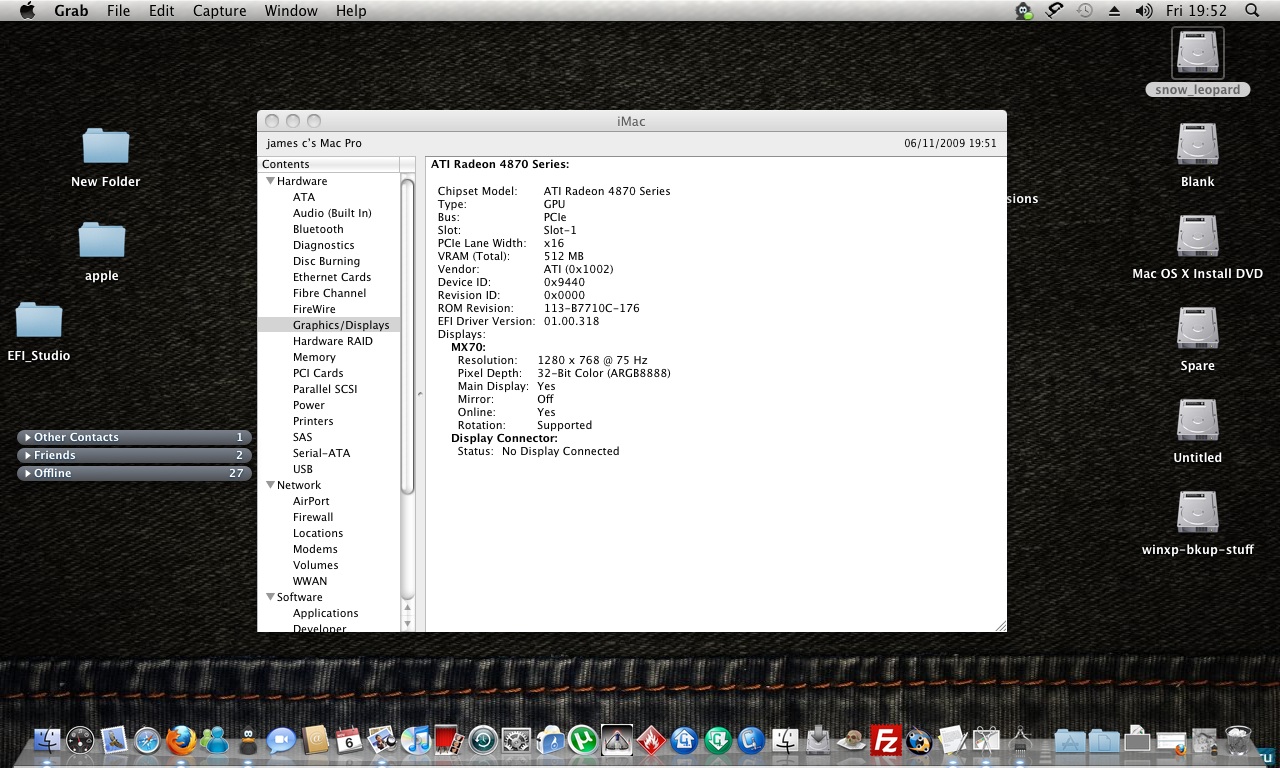

edgar87 Posted November 6, 2009 Share Posted November 6, 2009 does someone have a efi string for my gfx card? (ATi HD4870 512 MB) Link to comment Share on other sites More sharing options...
curlyboy Posted November 6, 2009 Share Posted November 6, 2009 why not use <key>GraphicsEnabler</key> option in the new Pc efi is what im using <string>y</string> Link to comment Share on other sites More sharing options...
330D Posted November 7, 2009 Share Posted November 7, 2009 As the newer PC EFI isn't being used i believe and so GraphicsEnabler doesn't work I've managed to get upto a blocky graphics with the 4870 using the following. <?xml version="1.0" encoding="UTF-8"?> <!DOCTYPE plist PUBLIC "-//Apple//DTD PLIST 1.0//EN" "http://www.apple.com/DTDs/PropertyList-1.0.dtd"> <plist version="1.0"> <dict> <key>PciRoot(0x0)/Pci(0x1,0x0)/Pci(0x0,0x0)</key> <dict> <key>@0,compatible</key> <string>ATY,Motmot</string> <key>@0,connector-type</key> <string>0x00000400</string> <key>@0,device_type</key> <string>display</string> <key>@0,display-type</key> <string>0x454e4f4e</string> <key>@0,name</key> <string>ATY,Motmot</string> <key>@1,compatible</key> <string>ATY,Motmot</string> <key>@1,connector-type</key> <string>0x00000004</string> <key>@1,device_type</key> <string>display</string> <key>@1,display-type</key> <string>0x454e4f4e</string> <key>@1,name</key> <string>ATY,Motmot</string> <key>AAPL,EMC-Display-List</key> <data> AwAAAAAAAAAAAAAAAAAAAAYQAAAbkgAAAAAAAAAAAAAGEAAAHJIAAAAAAAAA AAAABhAAACGSAAAAAAAAAAAAAA== </data> <key>AAPL,aux-power-connected</key> <string>0x00000001</string> <key>AAPL,backlight-control</key> <string>0x00000000</string> <key>AAPL,slot-name</key> <string>PCIe x16</string> <key>AAPL00,blackscreen-preferences</key> <string>0x08000000</string> <key>AAPL01,Coherency</key> <string>0x00000002</string> <key>AAPL01,blackscreen-preferences</key> <string>0x08000000</string> <key>ATY,Card#</key> <string>109-B77101-00</string> <key>ATY,Copyright</key> <string>Copyright AMD Inc. All Rights Reserved. 2005-2008</string> <key>ATY,EFICompileDate</key> <string>Jan 26 2009</string> <key>ATY,EFIDriverType</key> <string>0x02</string> <key>ATY,EFIEnabledMode</key> <string>0x02</string> <key>ATY,EFIHWInitStatus</key> <data> AAAAAAAAAAA= </data> <key>ATY,EFIOrientation</key> <string>0x0100</string> <key>ATY,EFIVersion</key> <data> MDEuMDAuMzE4AA== </data> <key>ATY,EFIVersionB</key> <string>113-B77101-012</string> <key>ATY,EFIVersionE</key> <string>113-B7710A-318</string> <key>ATY,MCLK</key> <string>0x00112e70</string> <key>ATY,MemRevisionID</key> <string>0x0009</string> <key>ATY,MemVendorID</key> <string>0x0002</string> <key>VRAM,totalsize</key> <string>0x40000000</string> <key>ATY,Rom#</key> <string>113-B7710C-176</string> <key>ATY,SCLK</key> <string>0x000bdb28</string> <key>ATY,VendorID</key> <string>0x1002</string> <key>device_type</key> <string>ATY,MotmotParent</string> <key>model</key> <string>ATI Radeon HD 4870</string> <key>name</key> <string>ATY,MotmotParent</string> </dict> </dict> </plist> Producing and EFI of 5707000001000000010000004b0700002500000002010c00d041030a00000000010106000001 0101060000007fff04001e0000004100540059002c00560065006e0064006f007200490044000000 0 60000000210240000004100540059002c00450046004900560065007200730069006f006e0042000 0 00120000003131332d4237373130312d3031321c0000006400650076006900630065005f00740079 0 0700065000000140000004154592c4d6f746d6f74506172656e74220000004100540059002c00450 0 46004900560065007200730069006f006e0000000e00000030312e30302e33313800220000004000 3 1002c006400650076006900630065005f00740079007000650000000b000000646973706c6179280 0 0000400030002c0063006f006e006e006500630074006f0072002d00740079007000650000000800 0 0000004000020000000400031002c0063006f006d00700061007400690062006c00650000000e000 0 004154592c4d6f746d6f7414000000400030002c006e0061006d00650000000e0000004154592c4d 6 f746d6f74180000004100540059002c00430061007200640023000000110000003130392d4237373 1 30312d3030260000004100410050004c00300031002c0043006f0068006500720065006e00630079 0 000000800000002000000220000004100410050004c002c0073006c006f0074002d006e0061006d0 0 650000000c000000504349652078313614000000400031002c006e0061006d00650000000e000000 4 154592c4d6f746d6f74160000004100540059002c00530043004c004b0000000800000028db0b002 0 000000400030002c0063006f006d00700061007400690062006c00650000000e0000004154592c4d 6 f746d6f74240000004100540059002c00450046004900560065007200730069006f006e004500000 0 120000003131332d4237373130412d333138300000004100410050004c002c0045004d0043002d00 4 4006900730070006c00610079002d004c00690073007400000044000000030000000000000000000 0 0000000000061000001b9200000000000000000000061000001c9200000000000000000000061000 0 02192000000000000000000002a0000004100540059002c004500460049004f007200690065006e0 0 74006100740069006f006e00000006000000000128000000400031002c0063006f006e006e006500 6 30074006f0072002d00740079007000650000000800000004000000280000004100540059002c004 d 0065006d005200650076006900730069006f006e0049004400000006000000090024000000410054 0 059002c004d0065006d00560065006e0064006f00720049004400000006000000020036000000410 0 410050004c002c006100750078002d0070006f007700650072002d0063006f006e006e0065006300 7 4006500640000000800000001000000220000005600520041004d002c0074006f00740061006c007 3 0069007a0065000000080000000000004024000000400030002c0064006900730070006c00610079 0 02d0074007900700065000000080000004e4f4e450e0000006e0061006d006500000014000000415 4 592c4d6f746d6f74506172656e74320000004100410050004c002c006200610063006b006c006900 6 700680074002d0063006f006e00740072006f006c000000080000000000000042000000410041005 0 004c00300030002c0062006c00610063006b00730063007200650065006e002d0070007200650066 0 06500720065006e0063006500730000000800000000000008420000004100410050004c003000310 0 2c0062006c00610063006b00730063007200650065006e002d007000720065006600650072006500 6 e006300650073000000080000000000000824000000400031002c0064006900730070006c0061007 9 002d0074007900700065000000080000004e4f4e4522000000400030002c00640065007600690063 0 065005f00740079007000650000000b000000646973706c6179100000006d006f00640065006c000 0 001600000041544920526164656f6e2048442034383730280000004100540059002c004500460049 0 0440072006900760065007200540079007000650000000500000002160000004100540059002c004 d 0043004c004b00000008000000702e1100160000004100540059002c0052006f006d002300000012 0 000003131332d4237373130432d3137362c0000004100540059002c0045004600490048005700490 0 6e006900740053007400610074007500730000000c00000000000000000000002000000041005400 5 9002c0043006f007000790072006900670068007400000035000000436f7079726967687420414d4 4 20496e632e20416c6c205269676874732052657365727665642e20323030352d323030382a000000 4 100540059002c0045004600490045006e00610062006c00650064004d006f0064006500000005000 0 00022a0000004100540059002c0045004600490043006f006d00700069006c006500440061007400 6 50000000f0000004a616e2032362032303039 If anyone is able to check this for me it would be appreciated. Thanks Link to comment Share on other sites More sharing options...
