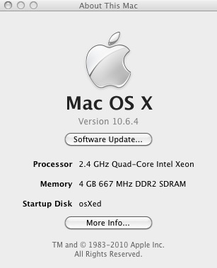

btw.. atm I'm running osx 1.6 could/should I upgrade to 1.6.4?
Yes, download and run the standalone 10.6.4 Combo Update installer..........backup your OS X system to the 2nd OS X volume I hope you have set up (as I recommend) and quit all open applications before running the installer............if you have any problems, then boot in verbose Safe Mode (i.e. boot with -v -x) and then re-run the Combo Update Installer..........running OS X installers in Safe Mode can be very effective at solving system problems because of what Safe Mode accomplishes.......see here.........

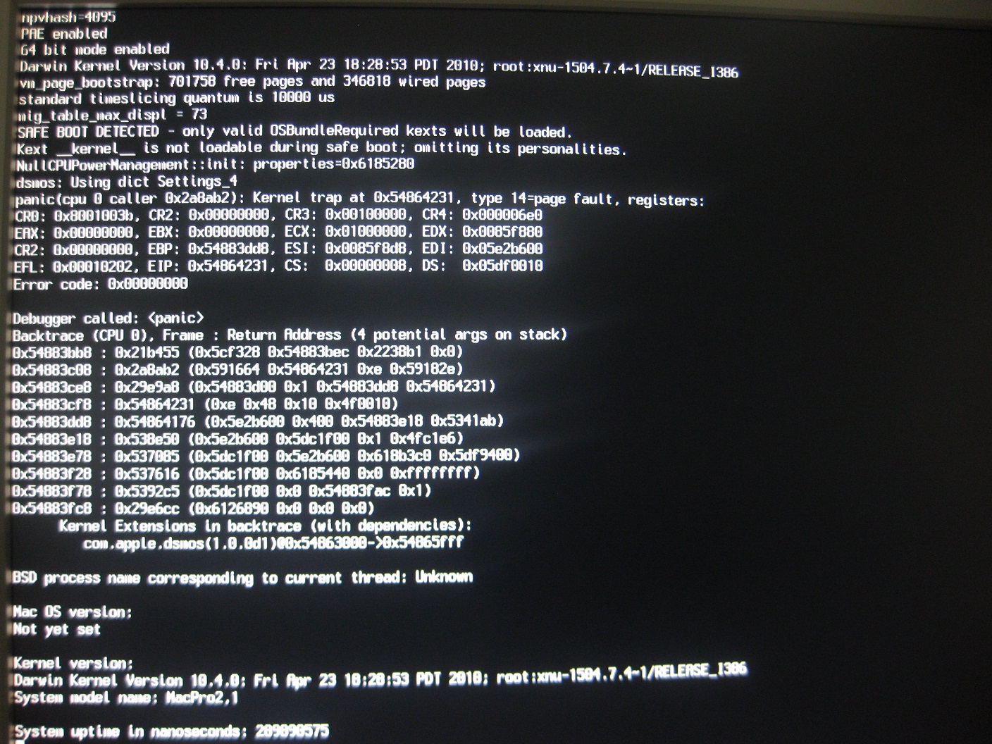

Did an update to 1.6.4 and now on boot I get a panic message..
Any ideas as to the reason of this?
Hey,
Good thing to have working clone's(not panicing when getting panic messages :( )..
You should have in /Extra/Extensions/:
EITHER fakesmc.kext (v1 or v2) and NullCPUPowerManagement.kext (preferred option)
OR netkas' Snow Leopard dsmos.kext and Kabyl's Leopard Disabler.kext (only if preferred option results in kernel panics)
NOT both or a mix of both...........

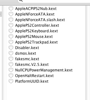

this are the extensions that I'm running 1.6 with:
I thought that it was weird that I had two fakesmc so I removed one and the same with the AppleNForceATA....
so this is what I have in the extensions folder of 1.6.4:
PS. So I did as you said, removed the disabler.kext and dsmos.kext and now the panic is gone..
It must have been a miracle that I was able to boot 1.6 without panic's.. ;D
thx!
thx!

Awsome m8! it works perfectly now.. even boots faster :)..
will be running this for a few days and if it all works out great it will be CLONE time. I enjoy OSX so much it´s just amazing!!

Why are you using AHCIPortInjector.kext? It is a Info.plist kext that adds a device name to AHCI controllers that are not included in the stock vanilla AppleAHCIPort.kext, e.g. for ICH9, ICH9R chipsets etc.....
With a 680i nForce chipset MOBO, use in your /E/E/ directory the following:
AppleNForceATA.64AnV.kext
OpenHaltRestart.kext
PlatformUUID.kext
nForceIOATAFamily.kext/ for fast 32bit booting
plus any kext you need for audio unless you are using VoodooHDA in /S/L/E/ along with nForceLAN.kext.......
i thought when i edit it the right name is shown in System-Profiler
No..........with your nForce 680i chipset, you should use the AppleNForceATA.kext.......
